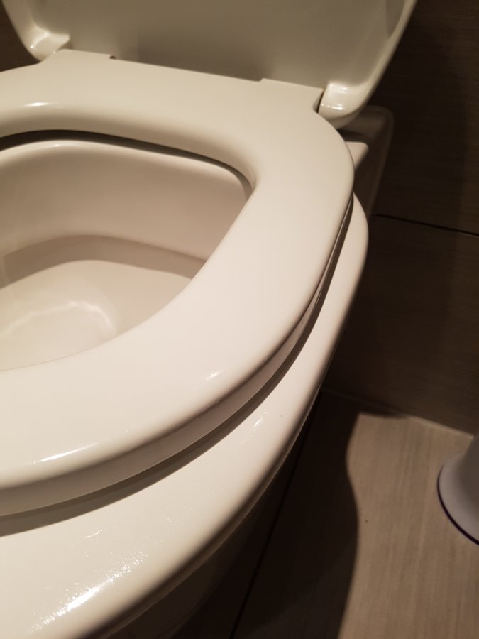

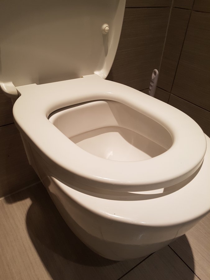

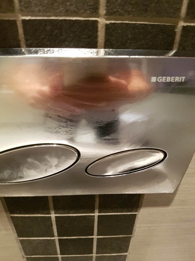

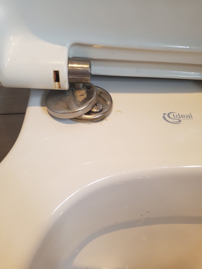

Hi
My toilet seat is broken. Don't know make or model. Don't know how to fix it as no screws underneath.
Can anyone offer any advice.
Thanks.

why no pics of the hinge area with the seat lifted?
nor the underneath
can you lift the seat off? Where is it "broken?"

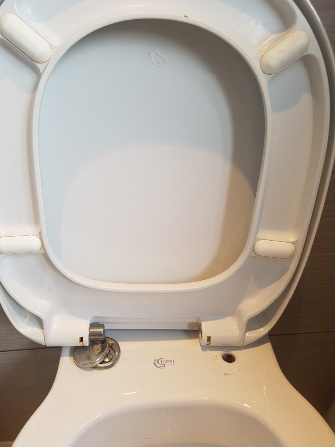

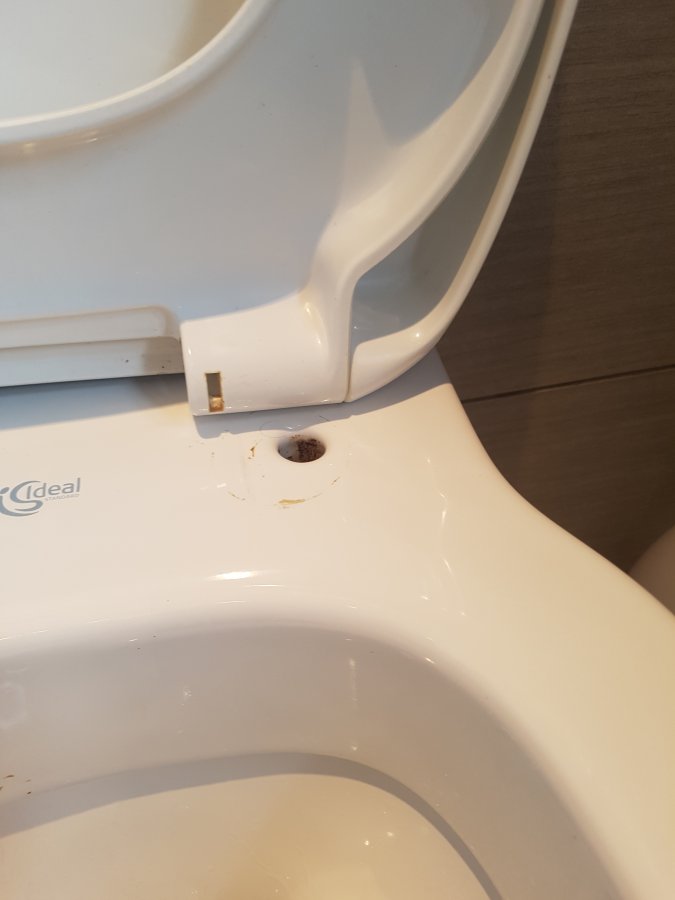

Here u go...

Is that seat still attached to the left hand hinge? Get it all off by using the other hinge as reference. The chrome button on the left looks like one that you pull off thus allowing the pin/post to be be removed by pulling the seat vertically upwards.

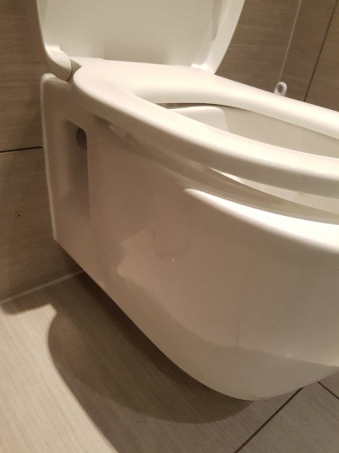

From the photos, the seat doesn't look like it suits the pan anyway!
Your pan is ideal standard and is wall hung - it shouldn't be difficult to find a replacement that suits using that search criteria.

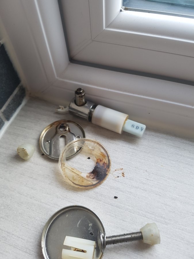

push the chrome button into the plastic seat ,and the seat pulls off , straight up, leaving the anchor post on the pan. then remove the chrome disc and the retaining screw ( cross head ) is revealed. the screw goes into a captive plastic plug ,which expands when that screw is tightened .loosen the screw several turns and you should be able to pull the whole thing out. the right hand side one appears to have fallen into the body of the WC pan ,but it will not cause any grief of you leave it there.
Don't want to take off the other hinge as won't be able to go toilet then. Is it best to just buy a new seat and will any wall hung ideal toilet seat fit?
Cheers all, it's for the mother in law who lives 40 miles away. Now back at home so cannot do dimension.
Have left her with the basics but the picture does look like her toilet so will pass on model number etc.
