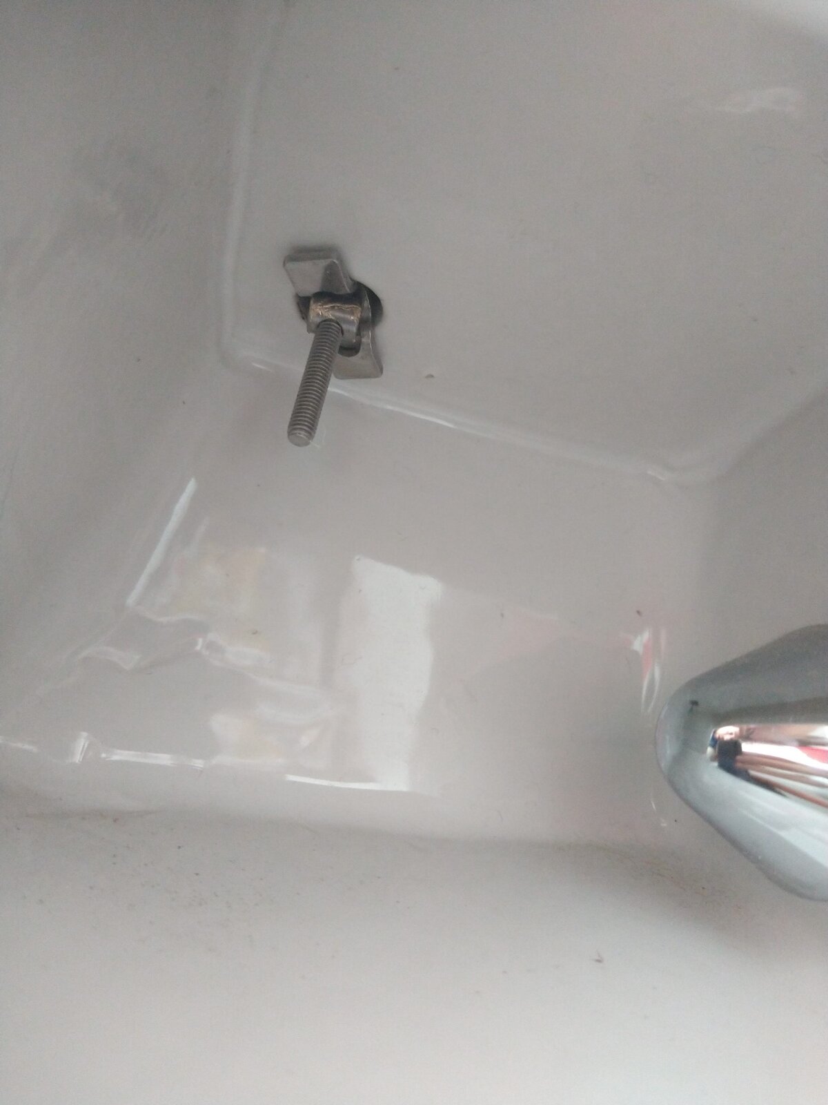

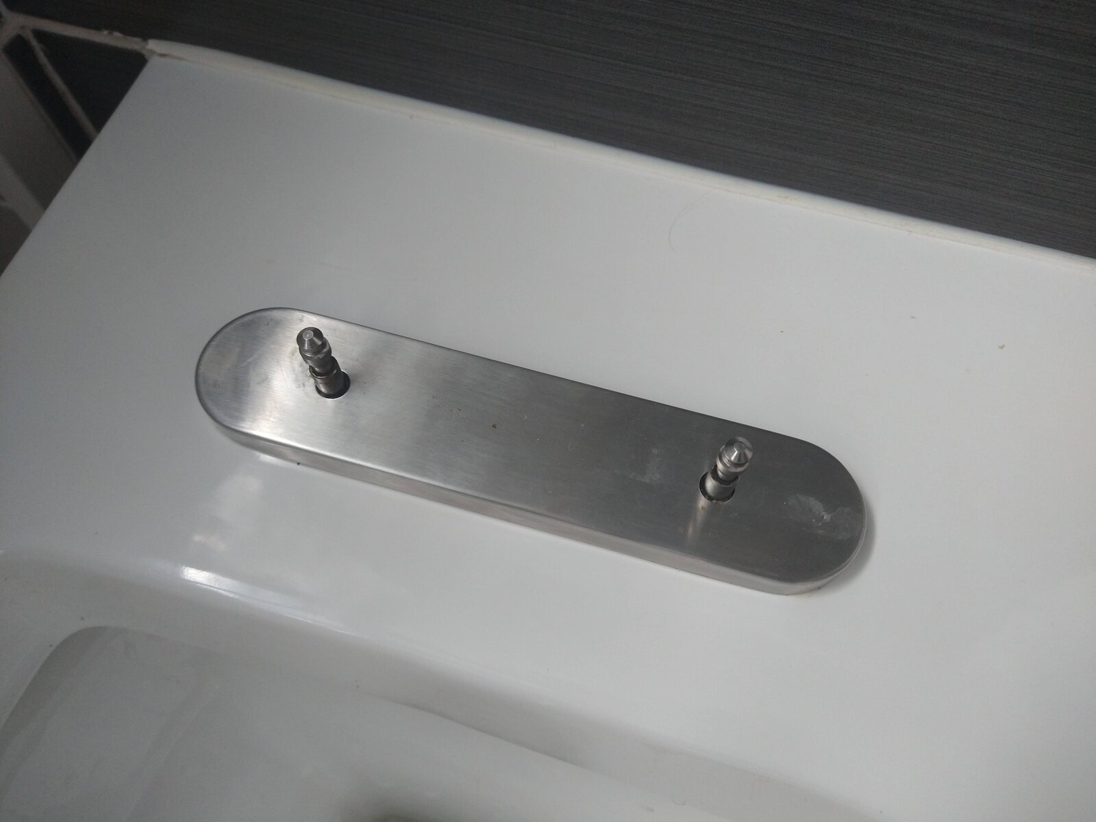

Hi guys. Long time forum lurker here. I have been having trouble removing a toilet seat base with quick release fittings. I have a varied level of DIY experience, but it does not extend to cover this! I tried some googling and reverse image search, but that just brings up a series of photos of car doors (not exactly what I was going for).
Any ideas on how to remove this base? I've included a photo of the base, and one of the fixings. It's probably simple in practice, but I've not encountered it before.
Thanks in advance!

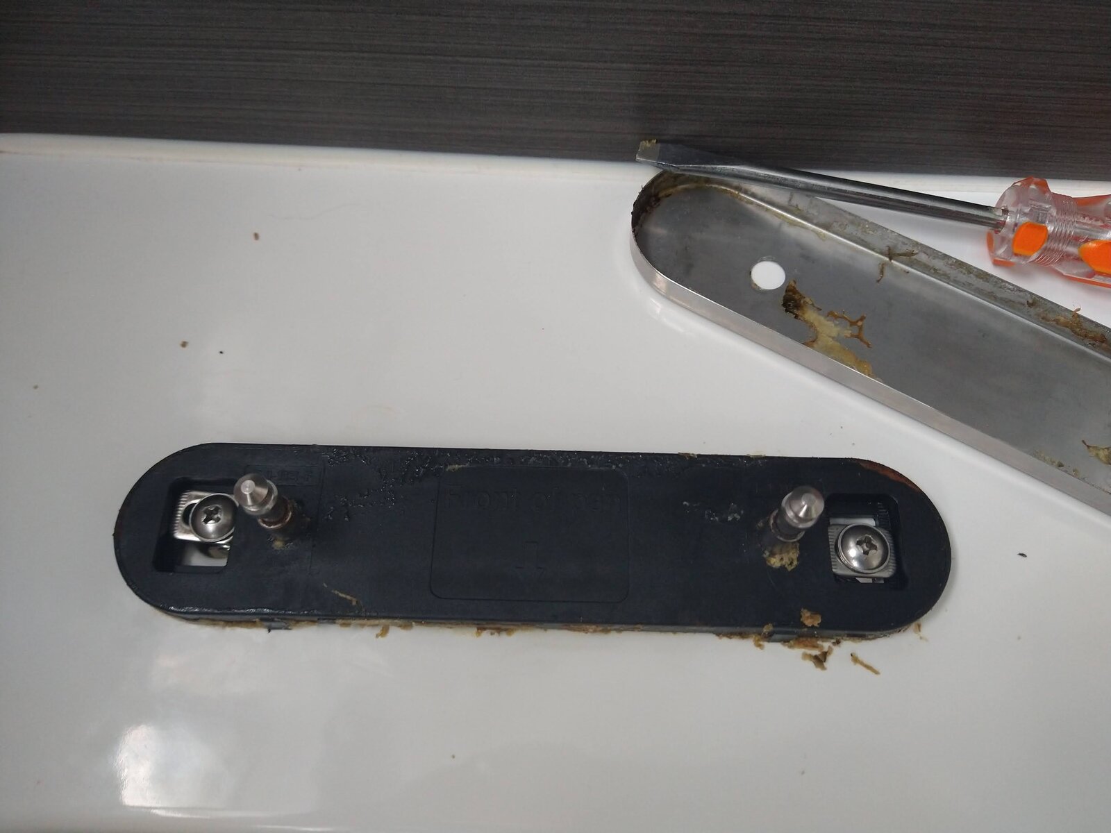

That's what I was thinking too, but I've been trying to prise it off but there's not much movement on it. I'm reluctant to use too much force with it in case I damage the pan.
It was as simple as you said in the end! I think the bathroom fitter must have glued the chrome top plate down and that's why it wasn't shifting. I just tore into it with a screwdriver with cloth underneath the blade to protect the ceramic, and it popped off.

That's been a victim of the male inhabitants of the house I'm afraid, especially the ones that cant pee straight, basically it's pee that has stuck that down over time coupled with a tight fit.
Ah, a wonderful parting gift from the previous occupants of the house then!
