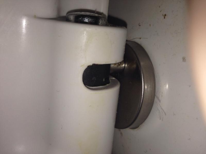

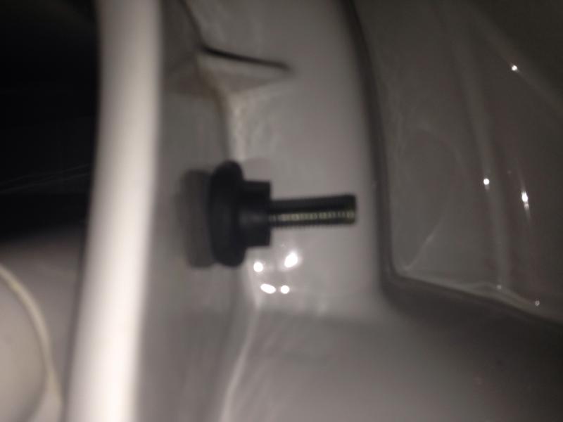

Hiya,
I need to replace a toilet seat. Normally I'd do it by unscrewing the nylon thumb-nuts underneath. However, this toilet-seat was fitted by a bathroom-fitter. Instead of a nylon nut, it has a thick, perfectly smooth black rubber lump/ring. Like a big, fat rounded washer. I can't get a grip on them with pliers or a wrench - they're too smooth and squidgy! Anybody seen them before?? I really need to get this seat off - it's hideous!
Thanks xxx
It may be top fixed, with the top fixing hidden under some trim. Why not put up a couple of photos one below one above - If you are brave enough :)
I never thought I'd upload photos like this anywhere... Yuk!!!
I remember an Ikea toilet seat we had - you had to attach these little sticky-up bits to the pan, and then lower the seat onto the 'sticks' until it clicked. If this is the same thing, mightn't grabbing the seat and pulling it up really hard work (so I can access the screw-heads)?
If you do that, you could end breaking the Pan. So don't do it.
It looks like the expanding rubber anchors on the bottom side, so it should be top fixed.
Yes you need to pull from the top, but try it a little bit each side to see if you can work it off. The chrome cover plates should then just lift off over the exposed pins to reveal the top fixing head into the rubber anchor below.
Care and avoidance of excessive force is the key to pulling it off. Look hard in case there are any other fixings on top such a small holes where a grub screw might need to be undone with an allen key. There are simply so many variations on the theme! - I don't recognise yours specifically.
Edit - check those chrome end caps on the hinge line, they may hide a fixing securing the top to the pins
I've done it! There's a chrome circle on the outside of each hinge. You press them in, and it releases the seat from the "sticky-up bits" so I can now remove the covers and access the screws. It *was* a bit cryptic. Thanks xxx
