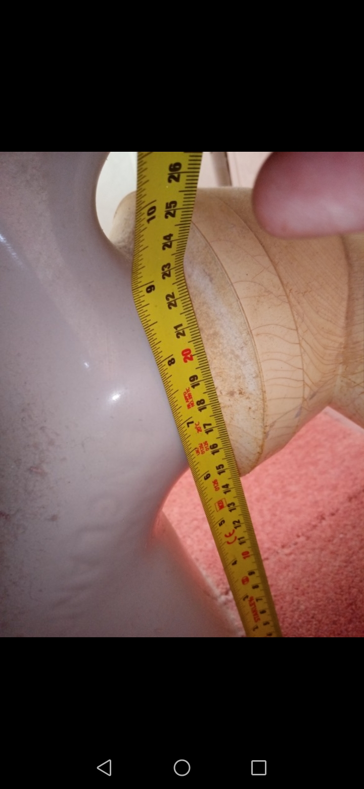

Thanks I did wonder if I'd be best of going with a new toilet. Due to its age. Or is it usual just to replace the syphon.
I think it is a 9 litre flush yes. These new syphons have internal overflows how are these set? Obviously the toilet has an internal overflow at the moment.
The only other thing that looked in sign of stress was the pan connector. Though it isn't leaking

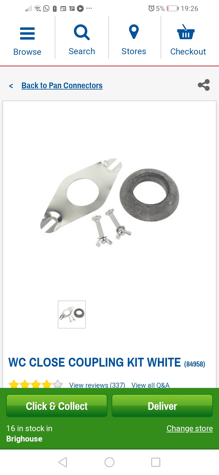

Can I just ask are these all the same size?

What did you do?
I actually recommended the fluidmaster but the old one (not that old) one was 2" so had an adapter as on the link earlier. The new donut washer was not the correct shape but i bodged it. That comes from experience unfortunately.
