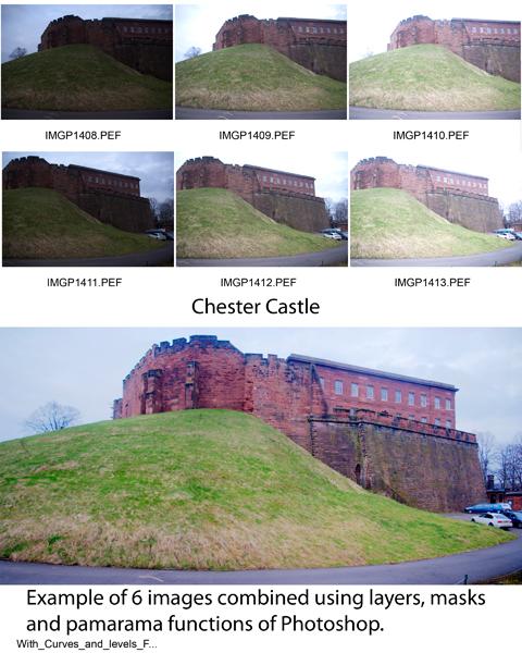

This combo image shows the 6 pictures taken and the finished result.
It does work I am not saying it doesn't but there is no punch in the finished result.
What I wanted is the sky but still have details of the stonework of the Castle.

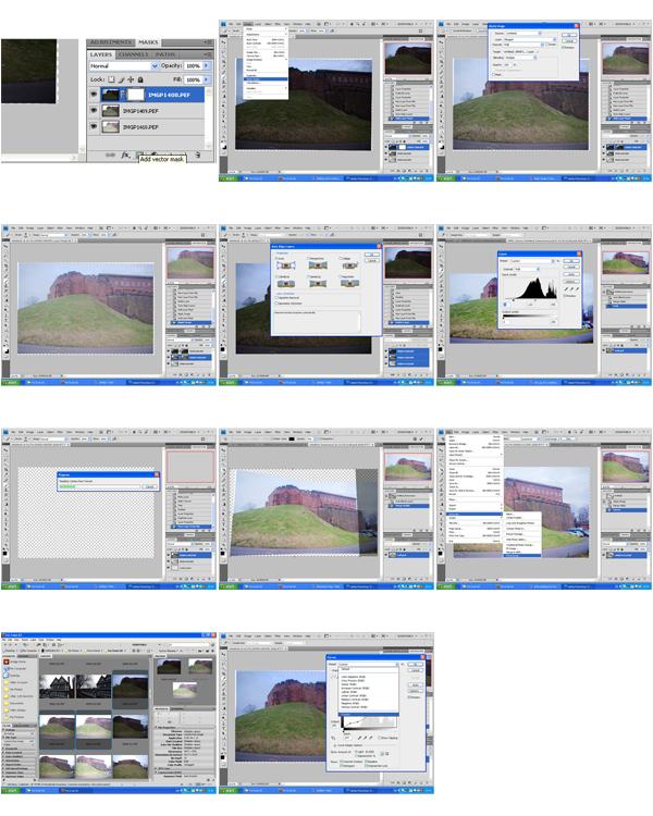

At the time of taking I knew it was not an easy shot so as you can see I took 6 pictures one because of the dynamic range and two because I could not get far enough back with my lens to capture all. This shows the various stages used to combine the images. Sorry not in order. Bottom left shows how I selected the images in bridge. Centre second down how I aligned images, top left selecting a layer mask, and top right applying the image. This is the area I am struggling with, there are so many options. Bottom centre selecting the curve is another problem area. This is the tone mapping. Which must have been out as second down on right I had to adjust levels again.
As I have said yes I have combined all images and got the full range. Using RAW 5.7 I could improve this a little by tweaking the images to start with. I know the problem lies with tone mapping. But how do I redress this problem?
