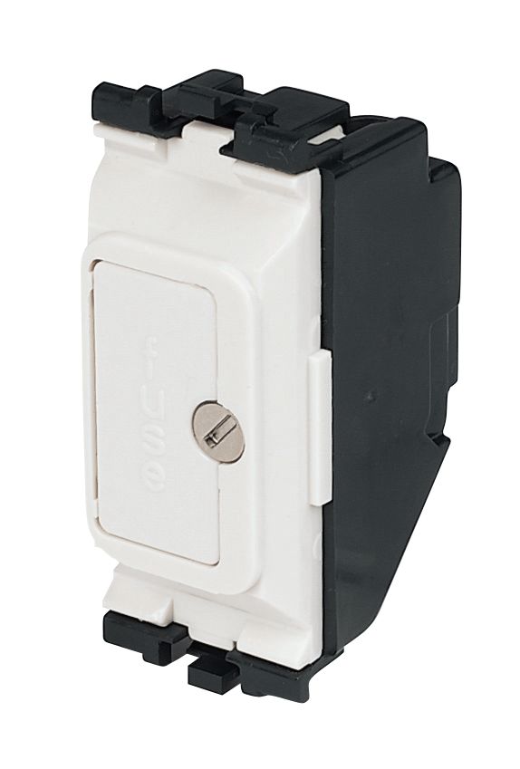

BAS. That is what I had in mind too. But unless you call it a grid-switch he will struggle to find them. The grid switch system is not just for switches. Fuse holders, neons, even some types of sockets can be included. The back box can be square as big as 4 single sockets. Double pole switches can also be used with same system and can even have names on them like "dish washer" there are a number of makes but I would look at MK.
Have a look
here for some examples. Here is a fuse holder as one example of the items that can be added.

The grid switches do come in many finishes have a look here shows many more options. This one
brushed stainless steel for example.
Have a look
