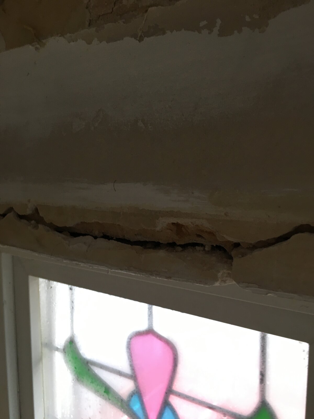

I’ve recently stripped back my small bedroom and removed a curtain rails to find the plaster underneath totally cracking and hanging off the reveal.
My plan was to hack it all off, build up a scratch coat, bead it and skim. Does anyone think something more is required?
The other rooms I’ve done up have not had such severe damage
The thing is its best to find the cause of the damage?
You mention minor damage to other window heads - is your house an old house with wood lintels?
From outside can you see any damage or movement signs to brickwork or render?
It looks like someone plastered about 2cm using skim and then the rail was secured into it with those humongous nails you get in old skirting boards. When I pulled them out half the wall came with them and it just cracked along the bonding Join between The undercoat and the massive piece of Skim.
So there is a 20mm deep coating of skim finish plaster - skimmed over what?
There's obviously been previous work - why, due to what cause?
Maybe when new frames were installed?
Cut nails.
Skimmed over some mesh. Yes I assume it was done when the frames were done.
Probably too late but just my own vaguely similar experience - Cracking around a window, took plaster back to brick to reveal a rotten timber lintel. rotted because some of the pointing was cracked outside, so water over the years got to the timber. Ended up taking out the timber and putting in a Concrete Lintel
I was thinking that an original, sturdy wooden window frame might have been taken out and replaced with a weedy modern or plastic replacement, loosely fitted, enabling the brickwork to sag.
