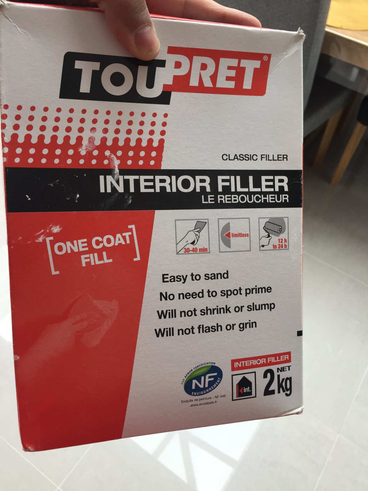

Based on an excellent suggestion from this forum I’ve been using this Toupret product for small and relatively large filling jobs. It’s been perfect and I’ve become very familiar to it. I use the large 12” jointing knife and it always provides a great finish.
I’ve never skimmed a wall using plaster and was wondering if I could use my experience with toupret and extend this to skimming entire walls using the Toupret product? I am taking paper off a wall soon and expect some imperfections with this.

Can someone please provide direction on the above please?
Thanks in advance.
Im not a plasterer but I'd never use something with filler on the packet to skim a wall!
Is there a similar product that I can use for skimming? I’m not confident with using the multi finish with a trowel.
I’ve heard of people attempting to do that, it’s a pretty cr@p idea and would generate a huge amount of dust, and can’t see it giving a decent finish.
There’s no other filler that’s any better either, hence the existence of finishing plaster.

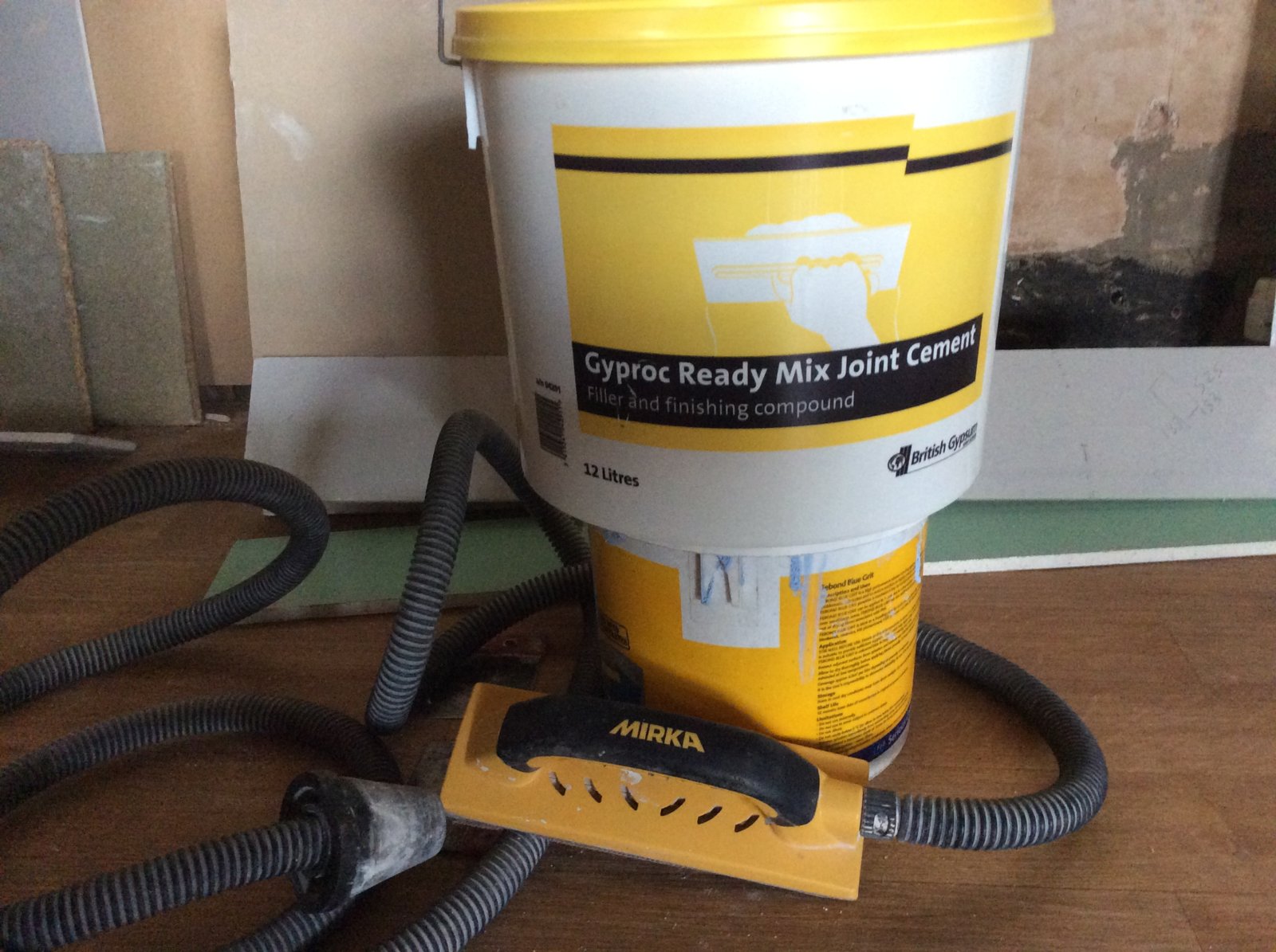

Ive used this for mass filling, way back I posted on how I used it to get good finish with minimum sanding
Found it, https://www.diynot.com/diy/threads/...-mixed-jointing-compound.473237/#post-3797277

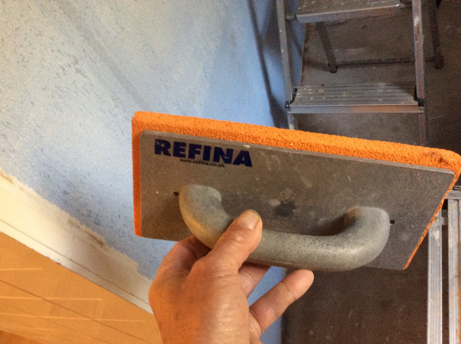

a refina sponge float is useful for flattening out or getting a wall back if you start to loose it

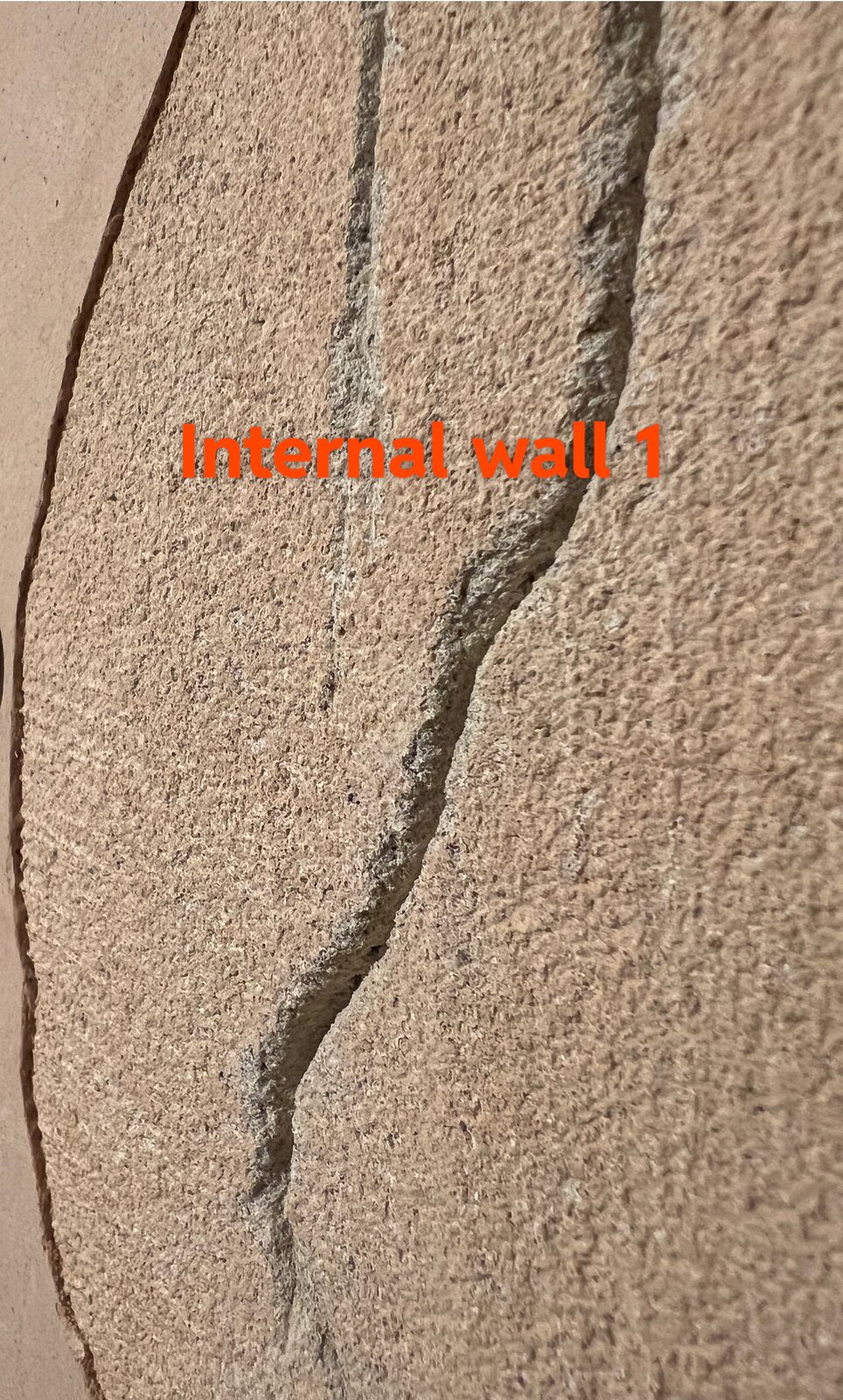

Hi
Hopefully you've gotten this all done. What did you end up doing? I'm in a similar situation. Have contacted many companies/ manufactures for advice. It's been a few months now I just have a few days to complete.
I'm thinking using toupret joint skim fill as a "skim" on these walls, then line, prime then limewash.
Walls are probably a lime/cement mix in a georgian flat. I removed the old gypsum skim as it was cracking anyways and it's internal
