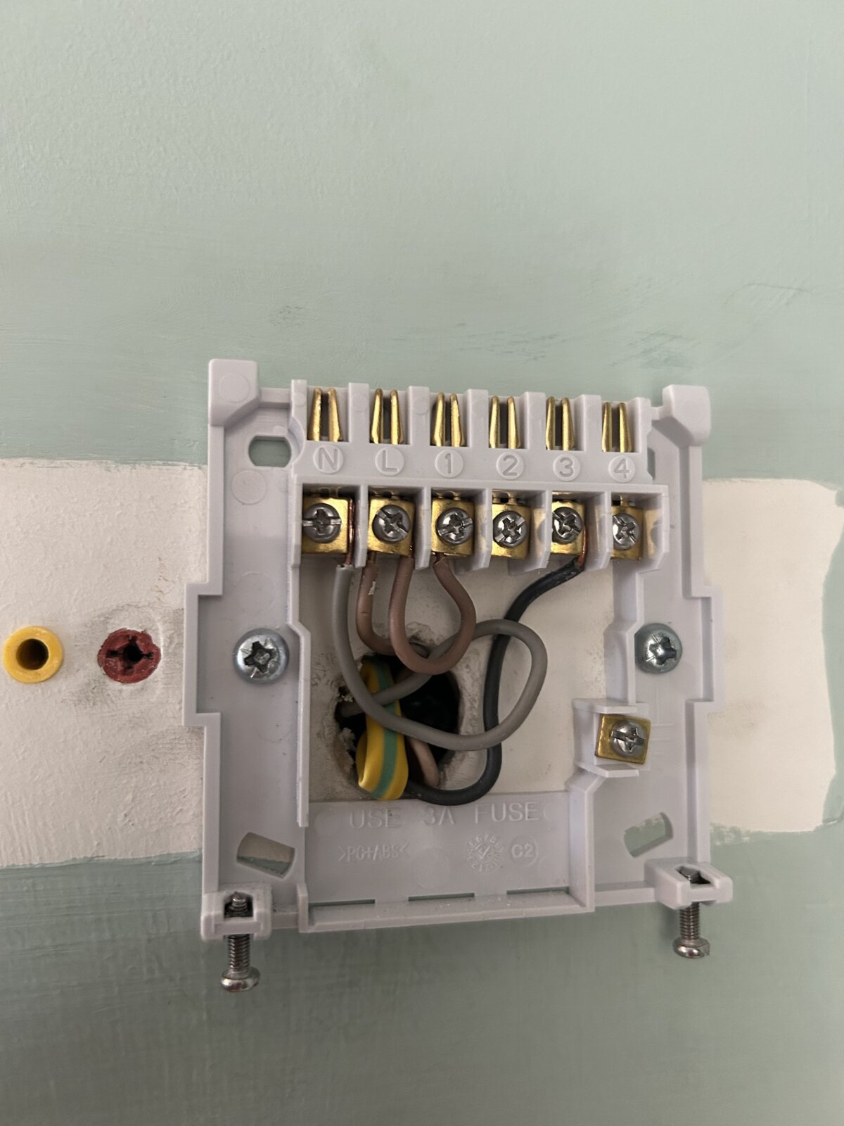

Morning all, currently switching my TP-One Thermostats to a hive system, I have successfully replaced the TP-ONE M thermostat with a Hive Mini and dual receiver but I'm now having some issues with the TP-One B.
The existing set up looked as following
Further to that there was a grey cable behind the wall, which I have followed other guides on here and connected to the N port on the Hive receiver, having done this I'm not appearing to get any power to the receiver, can anyone advise where I have potentially gone wrong in the image below
Any help is greatly appreciated
No good just connecting the grey without confirming it’s connected at the other end, will likely explain the power issue. Also, whilst the earth/cpc is there, it’s better connected into the terminal.
