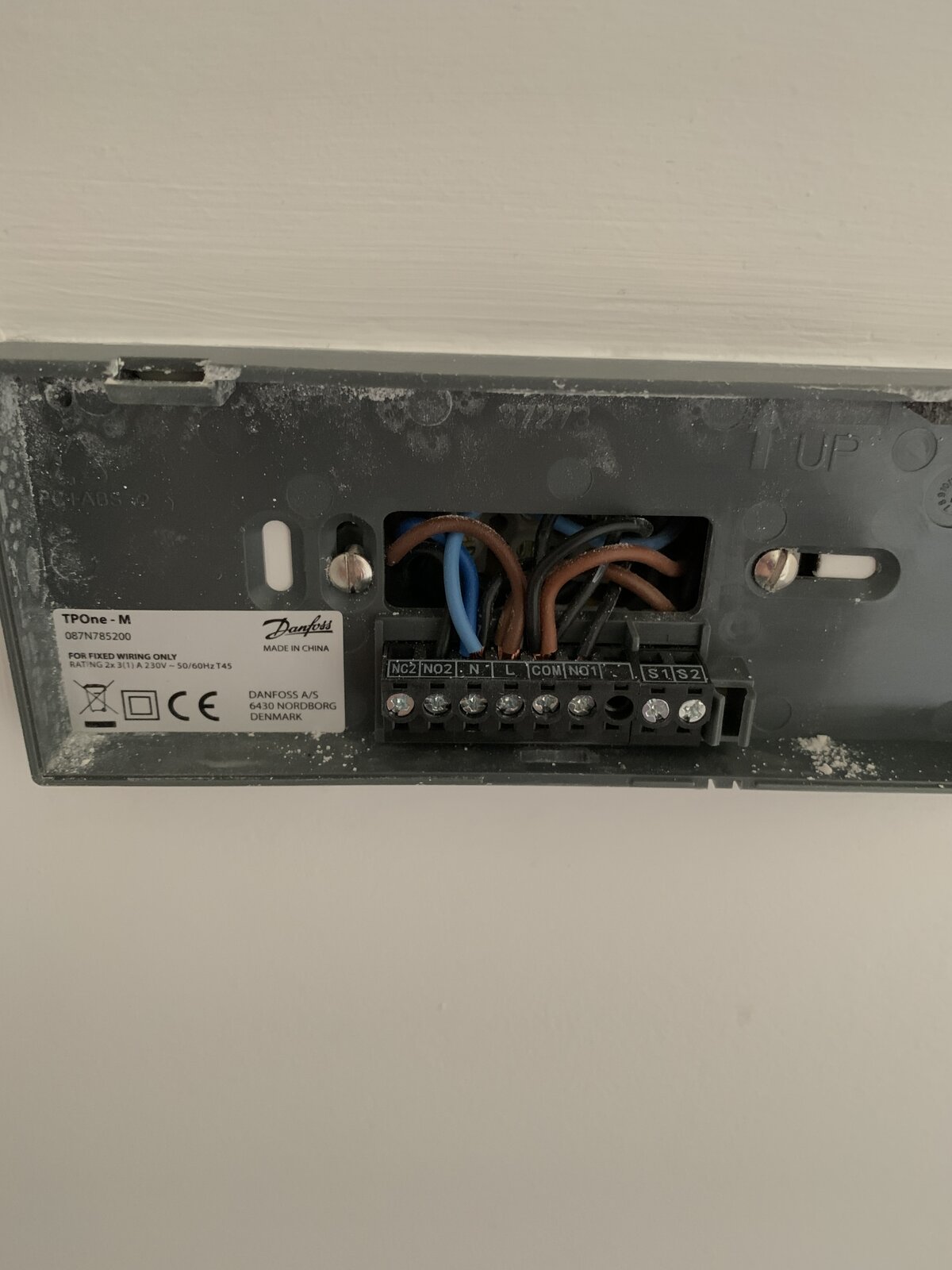

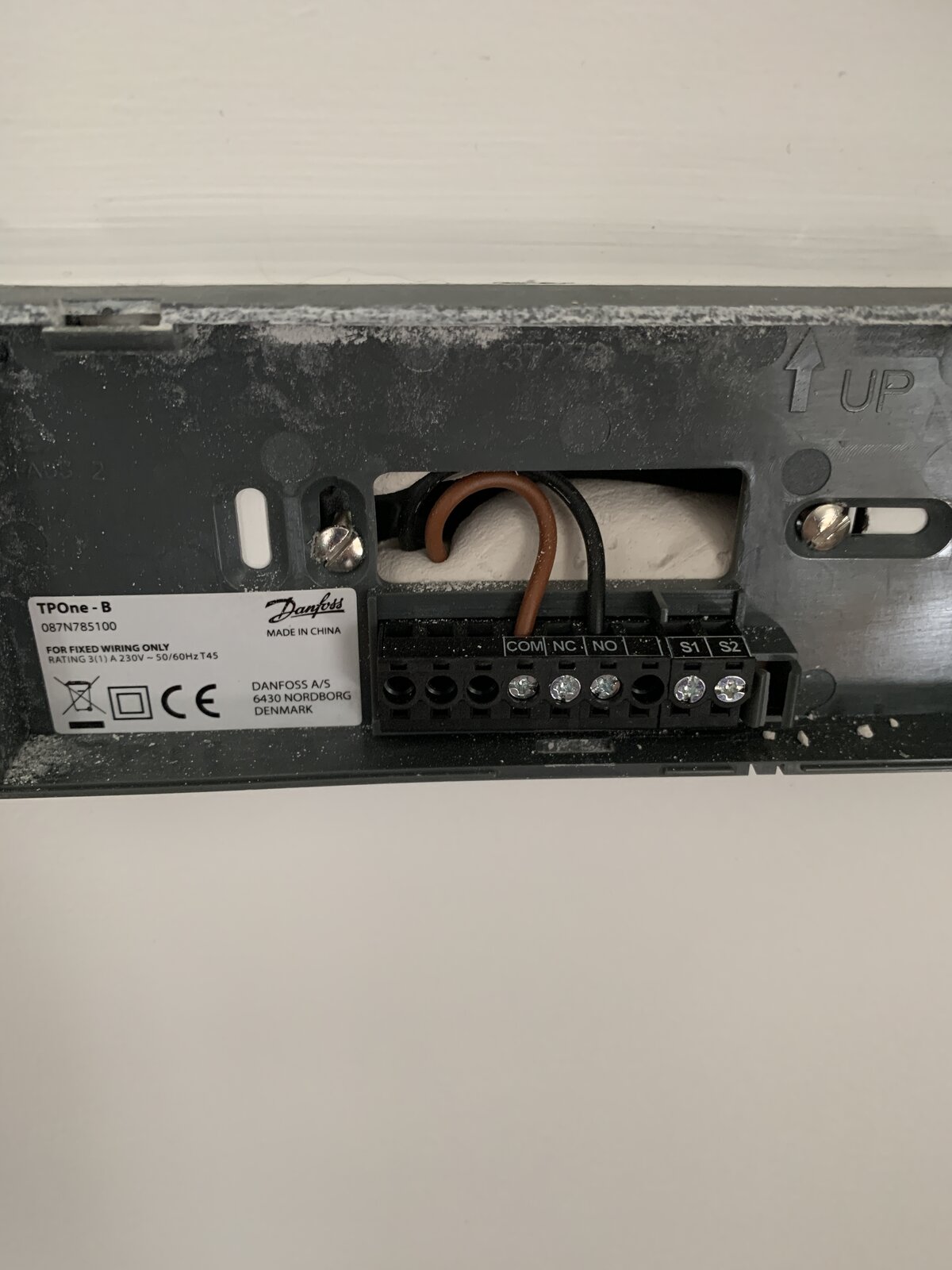

Hi
I'm looking to replace my Tp One M (zone 1 + Hot Water) and Tp One B (Zone 2) with a Hive (for One M) and Hive mini (for One B). The problem is that the wiring for my thermostats doesn't seem to match what I expected.
TP One M​
TP One B​
I seem to have multiple wires on the TP One M at Live, Neutral and COM and the Live and COM are not bridged (opposite to every other example I've found of these units). In other cases it is simply Live to Live, Neutral to Neutral and ON1 to Heating and ON2 to HW but I have all these extra cables.
My other complication is that the TP One B has no 230v supply, although it is probable that COM is live so I could bridge it with a wire. This still leaves me without a neutral and no lucky spare cable as was the case here.
Any help is greatly appreciated.

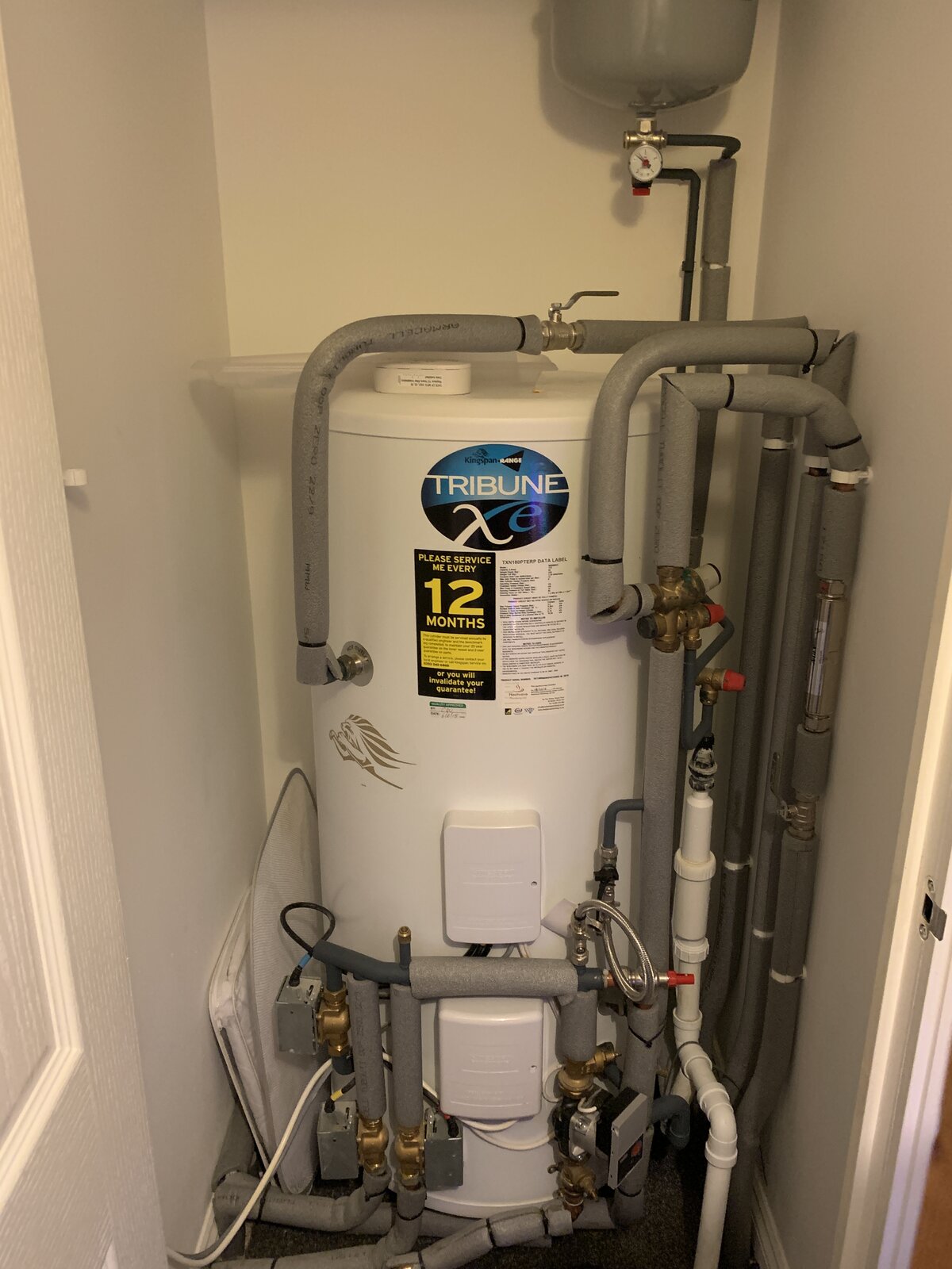

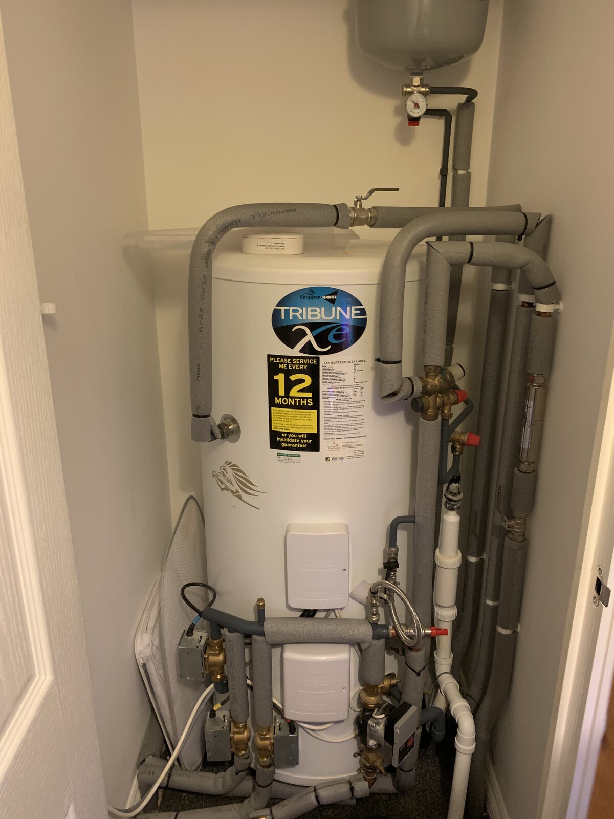

The wiring centre is not on the cylinder, post pics of your set up including the cylinder and existing zone valves

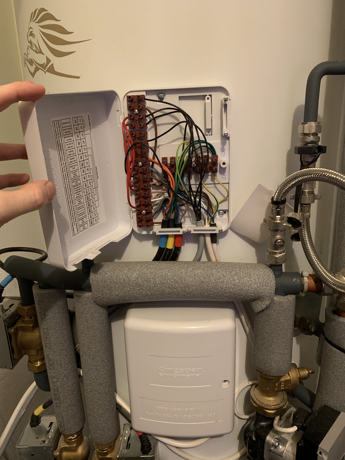

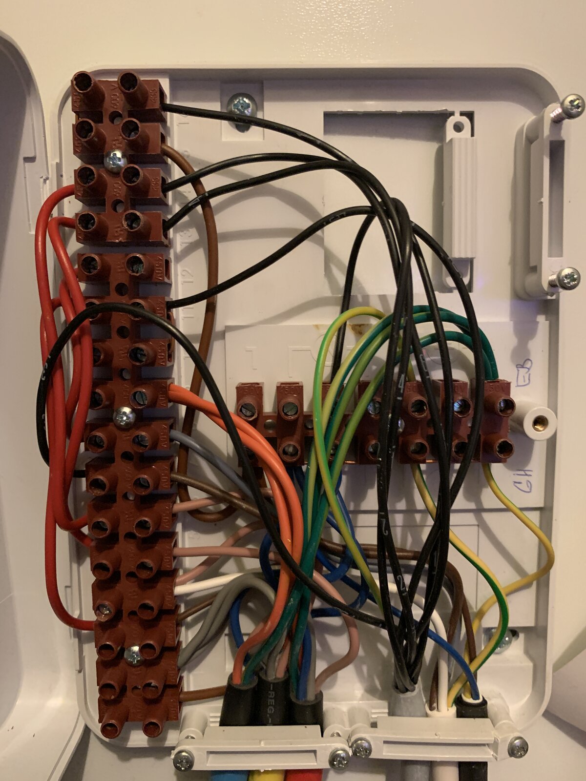

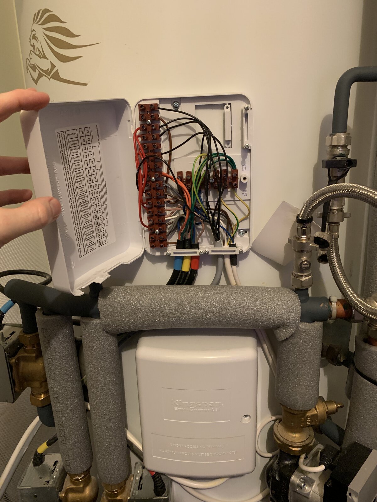

So beyond the two Danfoss units on their respective walls and the Ideal heat 15 boiler with isolation switch, I am only aware of the plumbing and electrics in the airing cupboard relating to the CH and HW.
The cylinder is a pre-plumbed Kingspan unit given I’m in a new build. I’ve attached images of the cylinder and valves along with the two white housings on the cylinder.
The upper unit looks to be the wiring centre to me. The lower one should be the back up immersion heater and cylinder thermostat

That is indeed your wiring centre, you will install the two receivers on the wall and run cables to the wiring centre, or you could put the dual channel receiver where the TP one m is, but the single channel receiver needs 4 wires, you only have two, if there are additional cores behind there you might be able to put the receiver there
I don’t think there is any other cables for the one B so I could only get Live by bridging COM (assuming COM actually is live as per other installs) so I shall have to place that receiver in the cupboard.
If I replace the one M by installing the hive receiver in the same location, can you tell if my wiring will just swap over or if there’s something more complicated with my apparent abundance of wires going to the one M?
