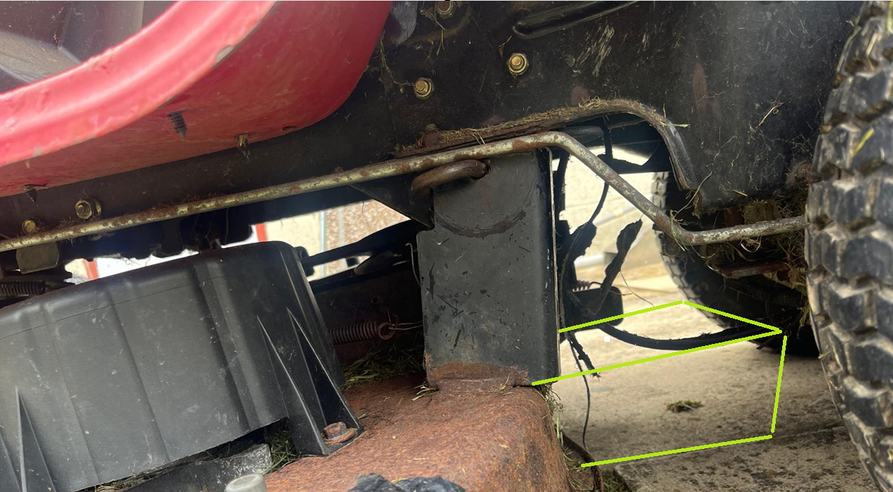

Lawnflite 703. It's a twin blade cutting deck, and it's basically shot. It discharged via a slot in the deck at the rear, with a plastic duct, leading up and over the back axle, into a big collector bag hooked onto the back, which I never used - simply because our grass is so thick and heavy, it would usually choke up the duct, then the deck itself.
Other than that, it works fine...
There is/was a bit of steel duct rusted out, on the rear edge of the deck. However, it now discharges all over the rear belt drive, due to leaks on the duct, so my idea is to fashion a short bit of duct, out of stainless steel, bolted in place, to have it discharge straight out, and onto the ground, as per the green lines. Anyone see any reason why this would not work?

It discharged out of the duct, at the rear, via a square duct, about 2 feet up from the ground. The wind would then blow it all over. I'm thinking if it discharges straight onto the ground, it will perhaps not be blown about so much.
The sculpting of the deck will tend to throw the grass upwards towards the missing chute, but what you propose will work. With contra rotating blades, a side discharge isn't as successful.

It took me a while to get round to it, due to sorting other issues on the tractor, plus numerous hospital appointments, weather and etc., but today, I finally got there. Other issues were a broken front drive belt, a snapped weld on the brake pedal. This latter was a 20mm shaft, spot welded, end on to a second 20mm shaft, which was the brake lever. I welded it up properly, but due to poor access, it ended up out of line with where it should have been. Press the brake pedal, and it also caught, and pressed the 'accelerator' pedal. To get the pedal to clear, this morning I had to bend the 20mm steel rod, with a scaffold bar, to realign it.
The thin, very rusty, steel rising up from the rear of the deck, I simply cut off, with an angle grinder, to allow my new bit of fashioned duct, to sit on the deck a bit lower. For the new section of duct, I made use of some scrap stainless steel. The scrap, was a section of old cooker extract hood, simply reshaped a little, then bolted into place on the deck. Just a U shape, and completely open below. It was just the right width already.
Once all back on, I gave it a go. Despite the 'blowy' conditions, almost no cut grass became air-bourne. It just left a neat trail of cut grass behind it, and none on the drive system, which was my biggest concern.

Thanks! I sold its predecessor, for something like £200, to a fishing lake, to mow their path around the lake, around 10 years ago. I bought this one, as a replacement, paying more than I should, around £450. Like many of the up, and over the back axle designs, for cutting collections - it would frequently block the duct up, with the cuttings. My first modification, was to simply do away with the big collection bag on the rear, which then blew the cuttings up in the air, covering me with them, so I added a curved bit of duct, in place of the collector, to direct the cutting to the ground. That really helped, but the duct was beginning to fall apart.
It was still inclined to block, but it was much easier to unblock with a poke with a stick, from the rear. I had it in mind, to see if there was some way to completely do away with the up, and over duct, and modify the deck to directly discharge - I just wasn't sure it would work.
