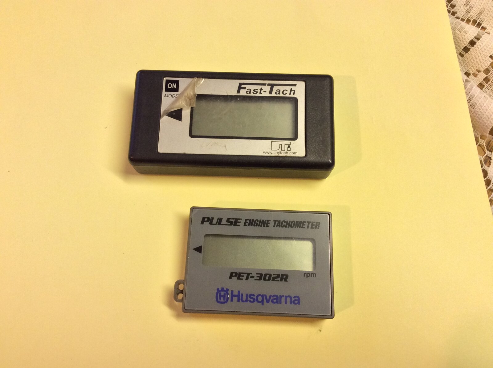

I use IR counter for deisels, props shafts,lathes etc but you cant beat pulse tachs for adjusing on the fly. The Husky one is handy cos its easy to clip the lead to the ht and mount the lcd somewhere visible for adjustments or mount it on the instrument panel just as a temp rev meter
My lathe has one built in. It was the difficulty of finding anywhere obvious to get a reading on the tractor, that put me off originally.
