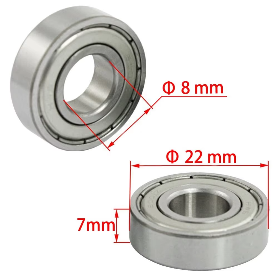

On a similar vein I have issue with kids (or adults) scooters, they all use the same size bearing which IMO are undersized for the kinds of abuse they're expected to cope with, no wonder I have to replace them constantly. It wouldn't take much in terms of (scooter) design to make them say 30% bigger and there's no need for the aesthetics to be hindered to make them slightly bigger. I suppose the fact that it's been a standard bearing size for decades that it'll never change.
