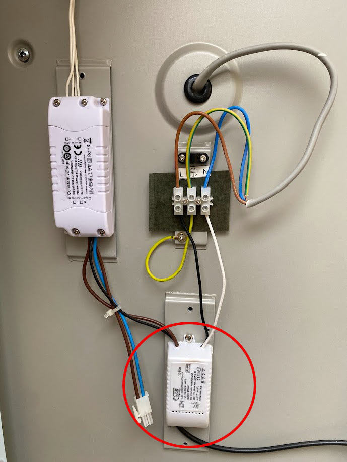

You need to locate and compare the IR switch, transforming the voltage down from ac to dc is separate
Your Amazon link looks appropriate, assuming that the sensor fits your hole, the wires are long enough, etc.

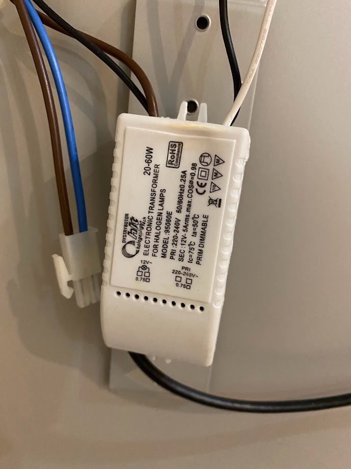

It’s confusing that the printing on your existing part seems wrong; it says nothing about containing a relay for the sensor switch. Yet clearly it does, based on the wires going in and out.
The part that's failed is circled with a close up in the other image
That "part" seems to be a 12 V Power Supply for 20 W to 60 W Halogen lamps.
(At least, that is what is written on it - although you (annoyingly) posted the photo sideway!.)
Is that Power Supply supplying all three sensor lights?
If so (and only two have failed) it is unlikely to be that Power Supply
BUT
the respective Sensors.
