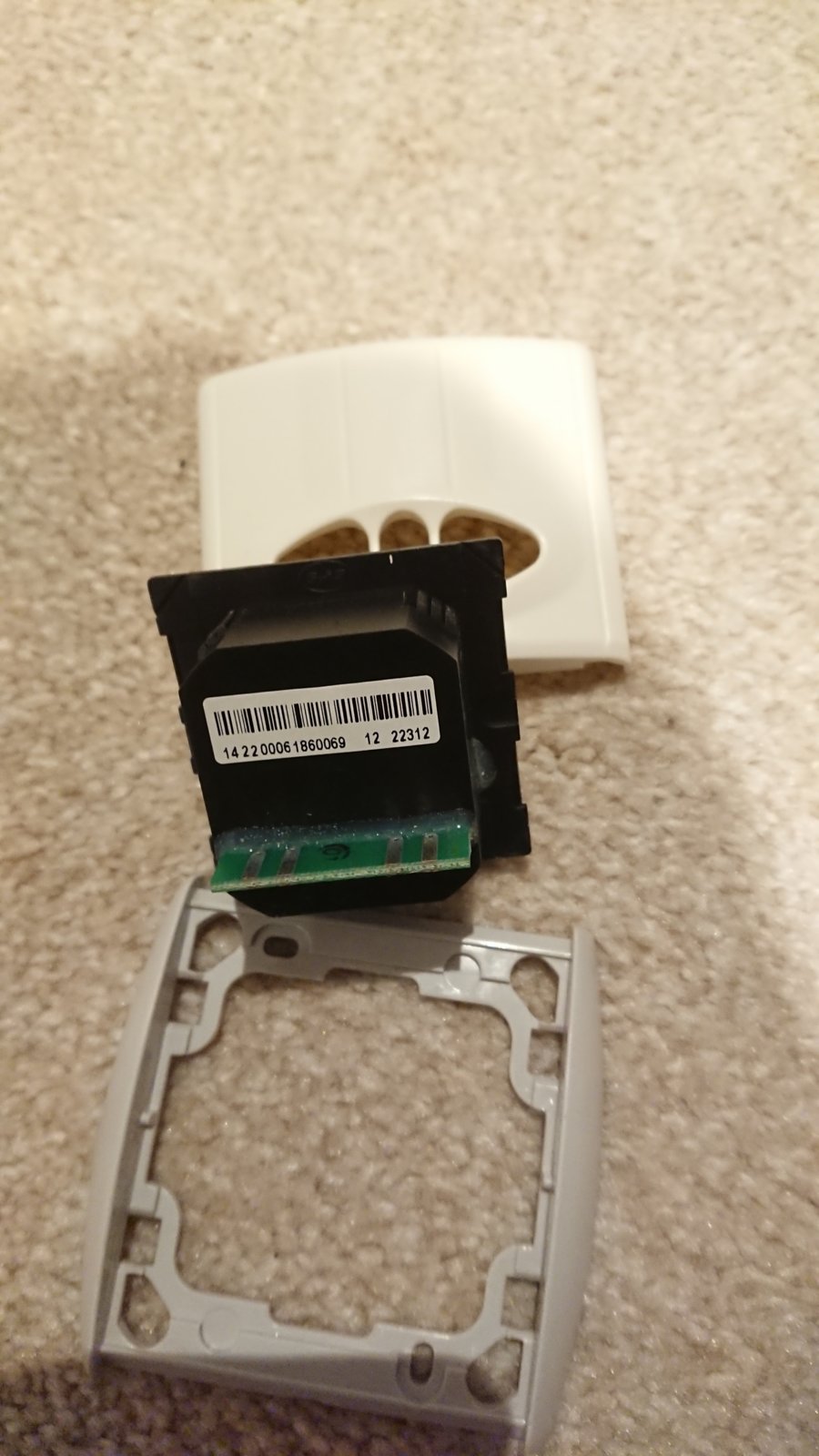

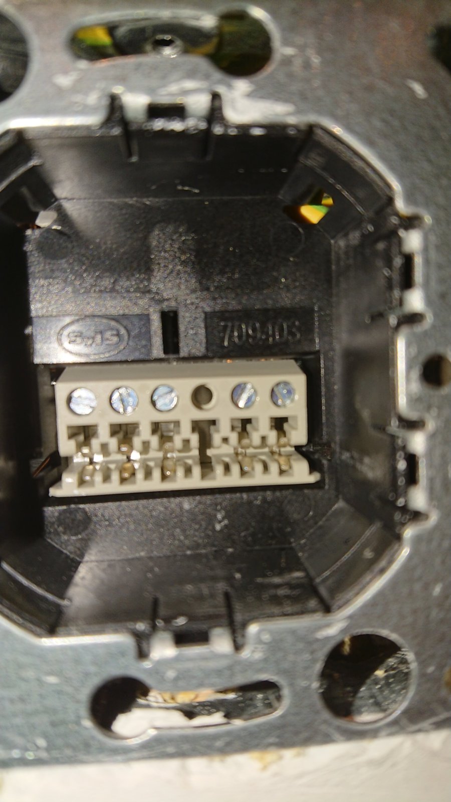

hi have a keylite electric window 24vdc moter powered by a transformer switch
the switch its self stopped working after a couple of months so on the phone to keylite as these are £95 so didnt fancy keep replacing them
they said they would send a engineer out to have a look
now here is my problem he said the switch blew as it is wired in a loop wire in to switch then out to tiolet light switch and said it needs to be a single wire into switch
ive said this to my sparky and cant see what differnce it makes
any one got any ideas or fitted these before
cheers
.... he said the switch blew as it is wired in a loop wire in to switch then out to tiolet light switch and said it needs to be a single wire into switch .... ive said this to my sparky and cant see what differnce it makes

Would need to see the switch, some switches have push in terminals and they are only designed for one cable, forcing two cables in one hole can cause bad connections and burn up the switch
not push in but screw terminals
