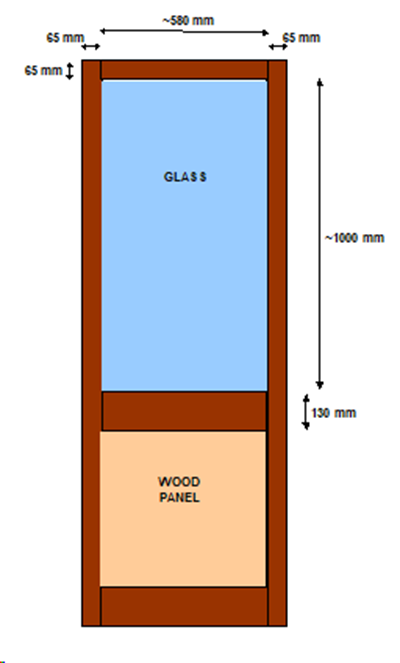

Following upon the comment made by @aveatry, I've done a bit more thinking.
The door I need will be about 705 mm wide. As far as I can make out, the great majority of 'narrow' wooden doors out there (both new and 'used') are about 762 mm wide, with outer stiles (the upper part will be glazed) each about 94 mm wide. By my calculation, that means that I would have to chop about 28.5 mm off each side, reducing the outer stiles (from ~94 mm) to about 65 mm. I initially thought that that might be 'pushing things' but, on reflection, think that I might get away with the ~65 mm outer stiles (without losing too much structural integrity). What do you think?

My question is therefore, as before, as to whether we/you think that chopping the outer stiles down to about 65 mm would result in adequate structural integrity. To be clear, the below sketch shows very roughly what I would end up with (albeit an over-simplified sketch showing things 'rectangular', which they aren't!). I'm inclined to think that I would probably 'get away with it' - do you agree?
65mm doesn't leave much. Espicually being outside and subject to a lot of expansion etc, I am not a carpenter but perhaps do awayvwithbthecglass or screw on some 6mm ply in the inside side
That was obviously my concern, and the reason I asked the question.
However, I'm a bit reassured by the fact that the stiles on the existing door are actually almost exactly 65 mm (just very slightly less). I strongly suspect that the door, which has been fine until quite recently (and, even now, is not too bad - just a bit of 'rot') ), is very probably 'original' in which case it has been in-service and 'exposed to the elements' for well over 100 years :-) ... and it is still essentially 'structurally sound', despite the rot. I've known the house myself for over 60 years, and I'm all but certain that the door has not been replaced in that time - so, even if it is not literally 'original', it's certainly been there for a very long time :-)
I can't (well, don't want to) get rid of the glass, since there would then be virtually no natural light in the building when the door was closed. However, there' nothing magic about the size of the glass at present,so I could easily 'make it small'by putting some timber around it(and thereby increasing the effective width of the stiles - e.g. as per sketch below. However, I'm far from convinced that that would be necessary, and nor am I sure how much structural improvement would result from screwing/gluing bits of timber onto the stiles in that fashion.
Given that the existing door, with ~65 mm stiles, has done OK for at least 60 years, quite probably well over 100 years, I'm rather tempted to go with that again - given that's the simplest option (just needs 'chopping down' a 762mm wide door! Do you think that would be foolish?

Returning to the door, I do not have to make any major up-front decisions. If I acquire a 762 mm wide door and chop the sides off it, I can then at least make some sort of judgement as to how 'wobbly/bendy' it seems to be ('now'), and only then make the decision as to whether or not to add some bits of wood to extend/'strengthen' the stiles.
