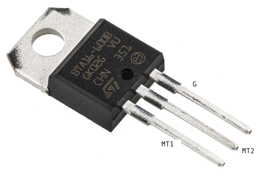

The triac sits in the pcb control board of a Bosch Classicx 1400 washing machine. The image I've attached is merely to show the terminals, the part no for mine is BTB16 600CW.
I've watched a number of videos on YT about testing them but its confusing.
With the multimeter set to Ω, there should be a reading between and MT1 and G terminals.
Between MT1 and MT2 there should be open circuit until MT2 and G are bridged but to my mind that's only allowing MT1 and G to make circuit and doesn't confirm that MT1 and MT2 are connecting to make circuit.
Can anyone clarify for me please?
