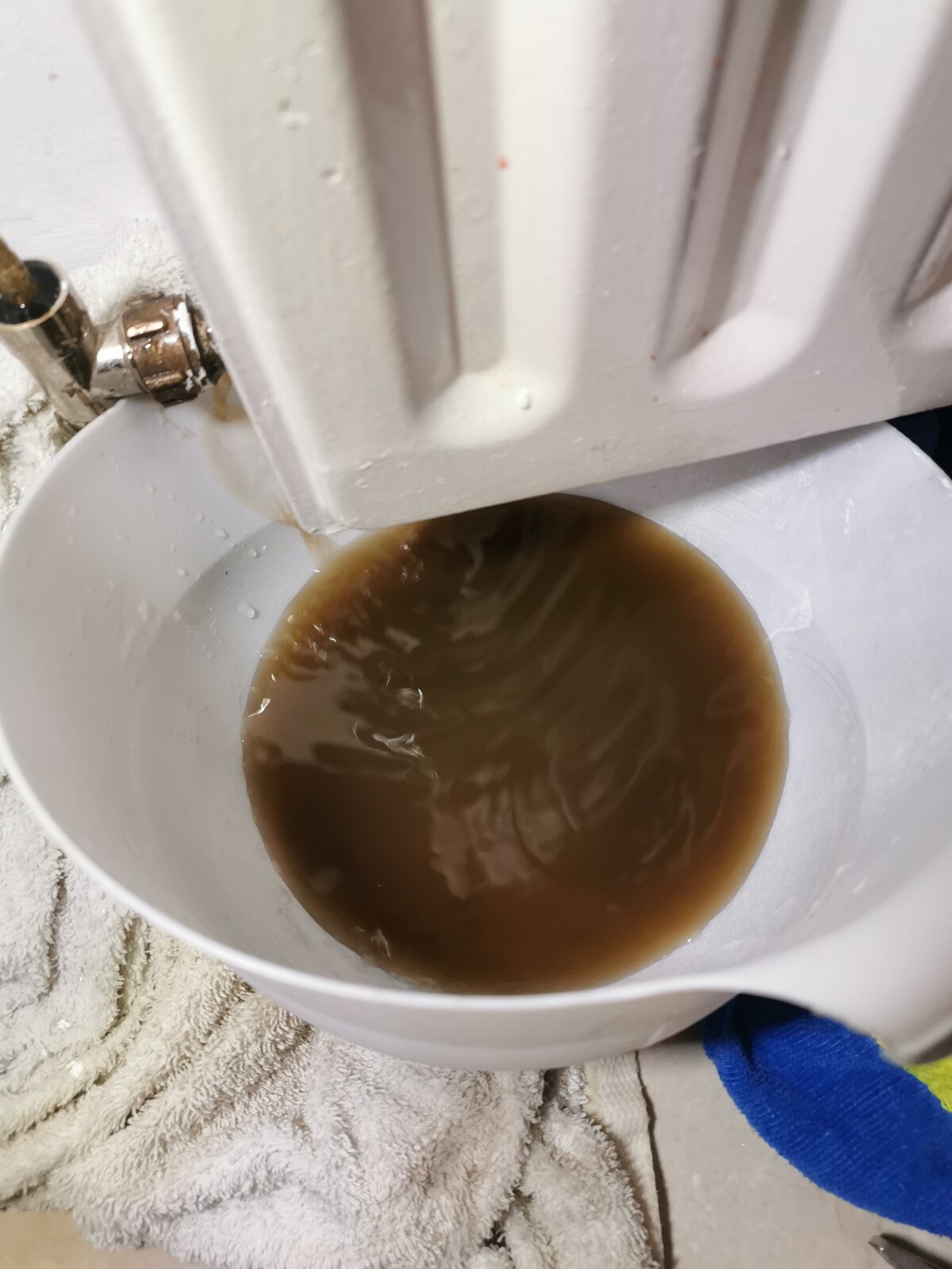

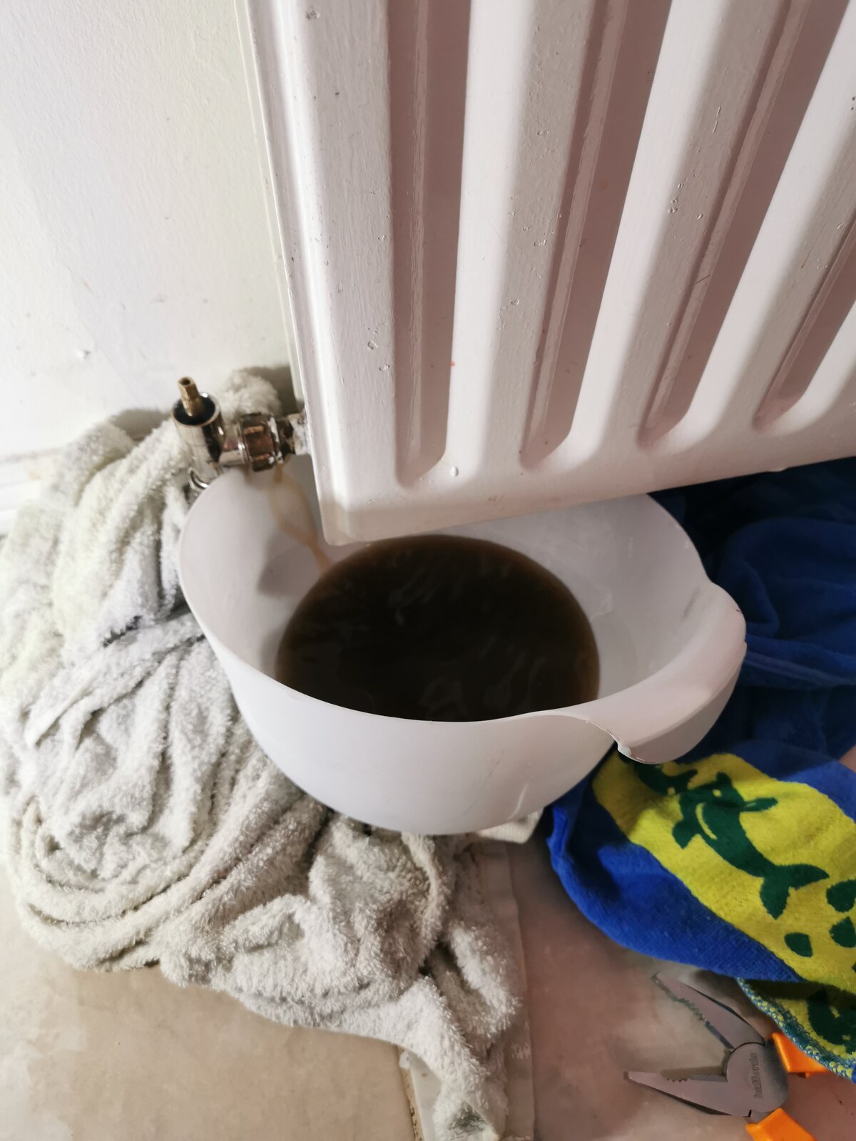

Here's a pic of the water that came out lol
