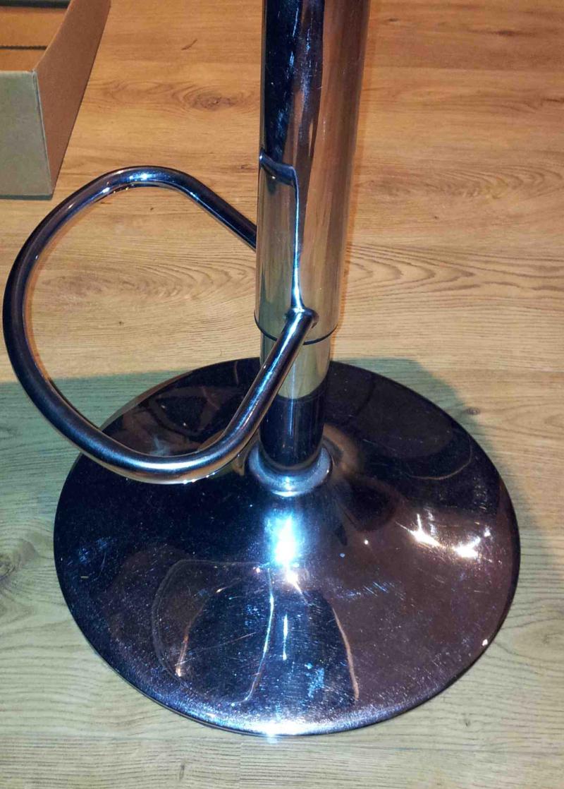

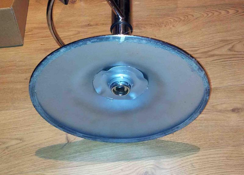

the trim that goes on the metal base of one of my kitchen stools disintegrated. The base is one of those pressed metal disks that raises gently towards the centre and on the outer edge curls under slightly..
Any idea where I can get a replacement? I can't find the order email that tells me where I bought the stool and it is a few years ago now..

The trim is a black ribbed plastic that hooks on the underside of the stool base.. I can get a pic of the stool base that lacks a trim if that would help?
Can't believe I am the only person who has had to replace one of these and the base seems a fairly standard item but I can't find a search term on google that gets me anything.. any help welcome..

Looks to me like it could be done with a C-section plastic strip. Have you thought about getting some lightweight plastic air hose, the small stuff about 8mm or 10mm OD and slitting it to make your own C-profile? It needs to be of the same flexibility as that plastic "strip" new and reground circular saws come wrapped in to protect the teeth. Come to think of it have you thought about asking the local saw doctor service? Those guys must buy it by the reel and cut to length because there are so many sizes of saw blade out there
You could cut a thin disc of thin mdf to fit snugly into the recess, cover with felt, it would then prevent it scratching the floor when moved

Found a seller on eBay but they want 16 quid per ring, was thinking about a U section edge trim, but wondered whether it would be strong enough, so have found this one.... http://www.componentforce.co.uk/category/692/heavy-duty-steel-reinforced-edging-strip
Had the same problem and can confirm the U section works, was a bit worried it would mark the tiles but no problem so far. Thanks for the tip!
