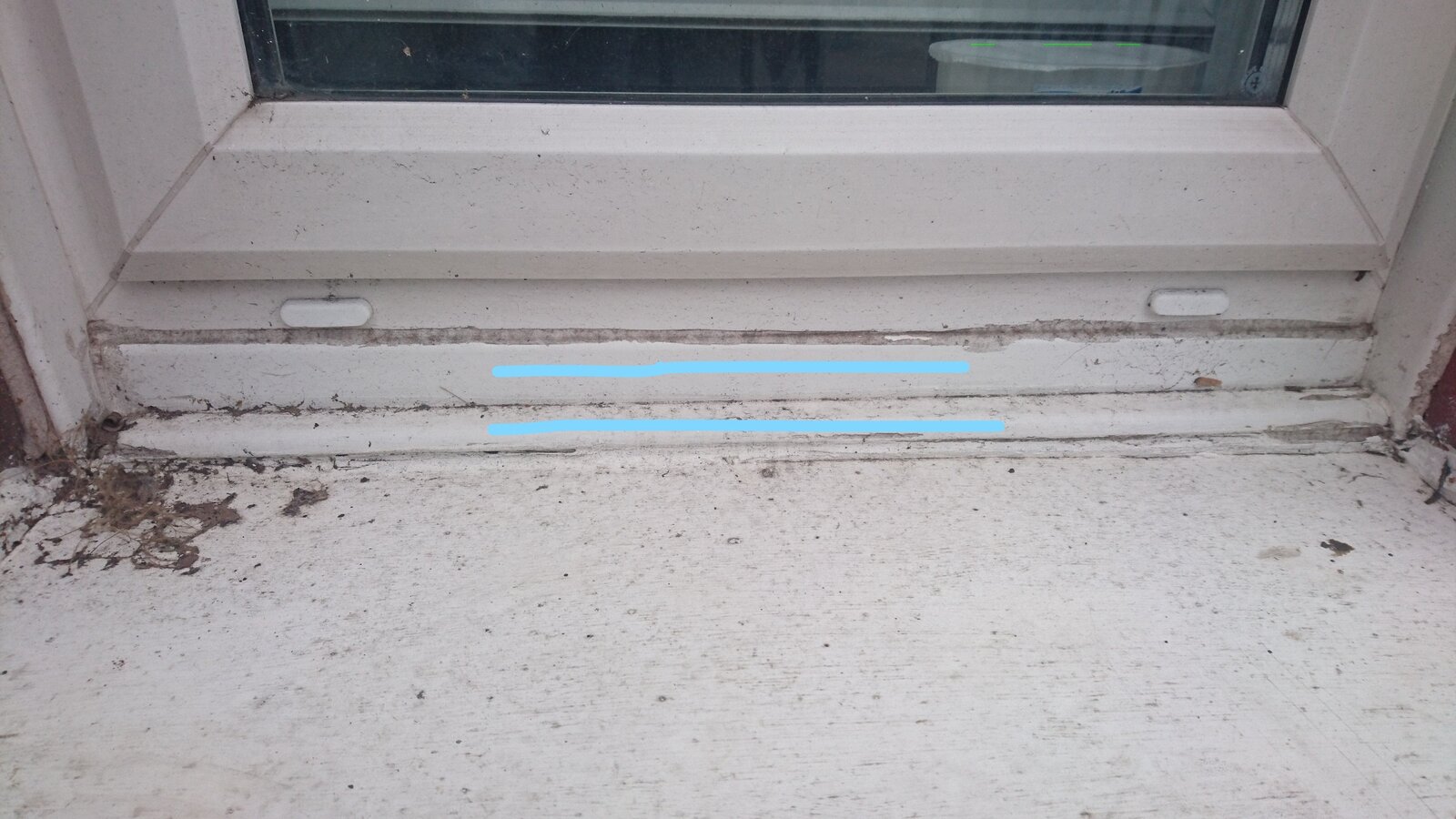

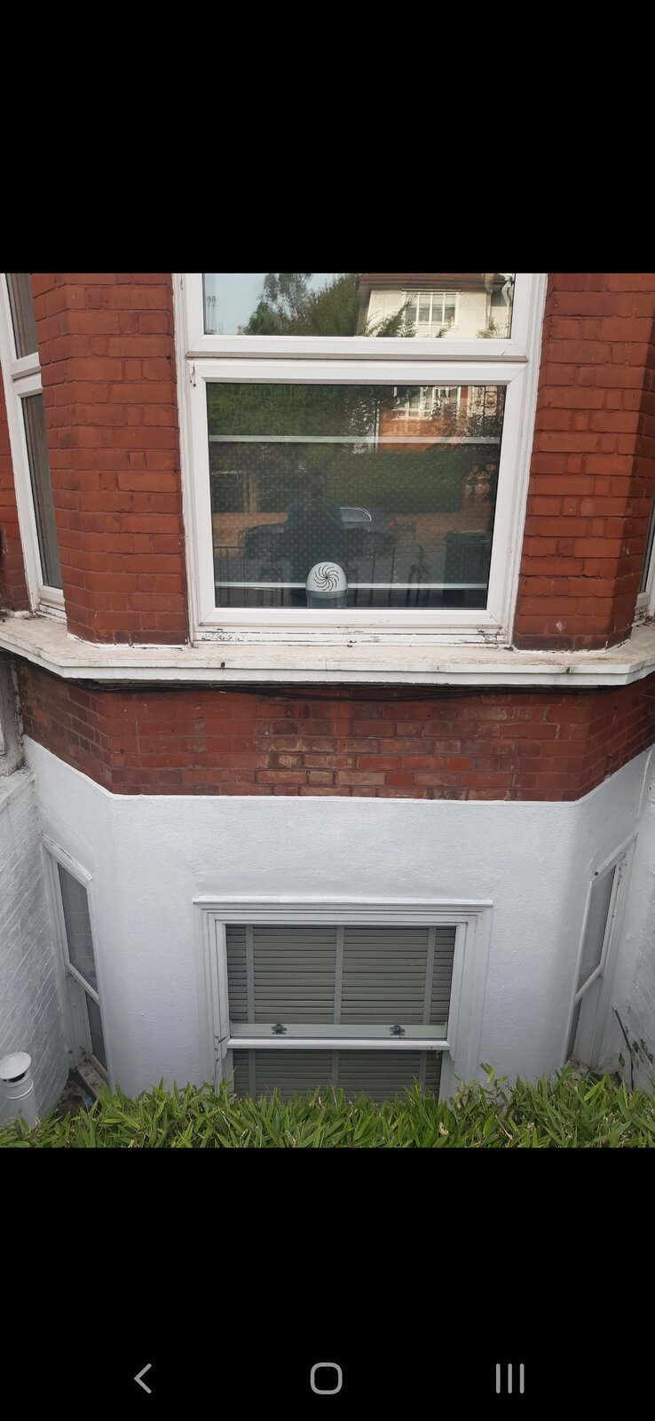

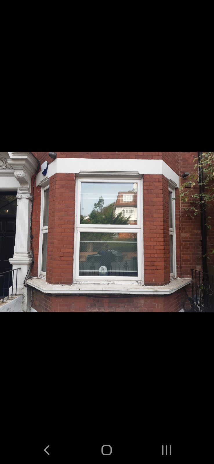

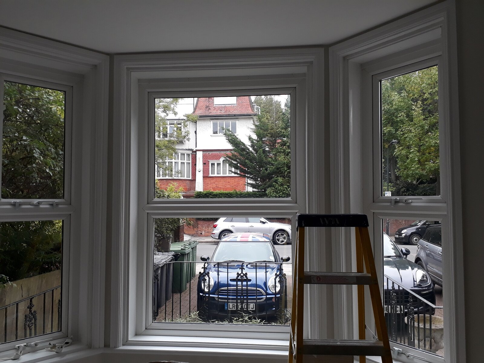

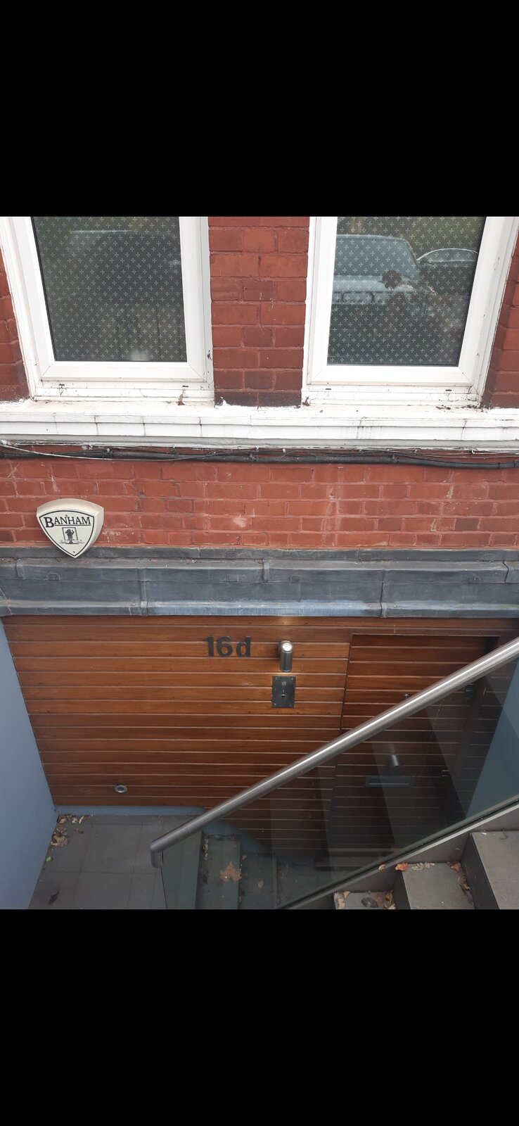

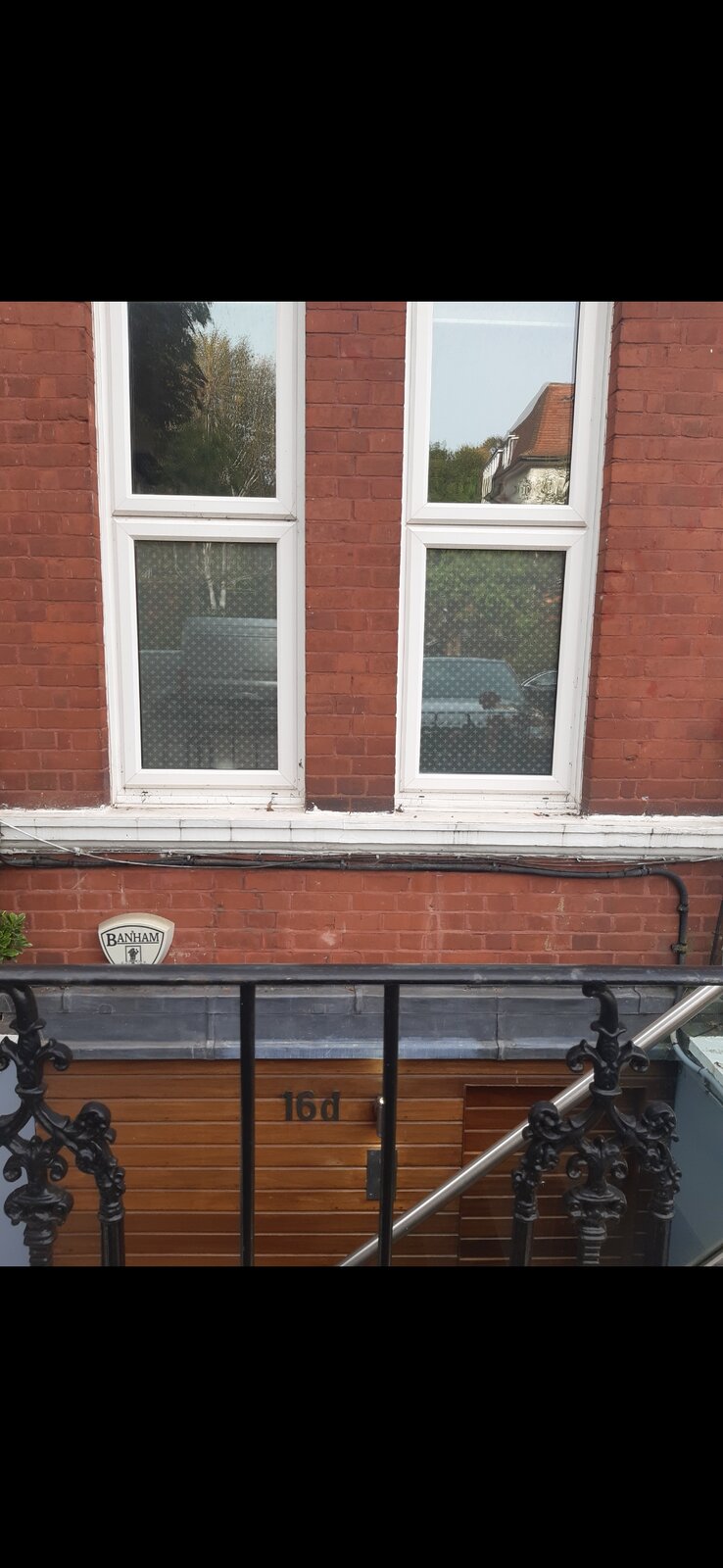

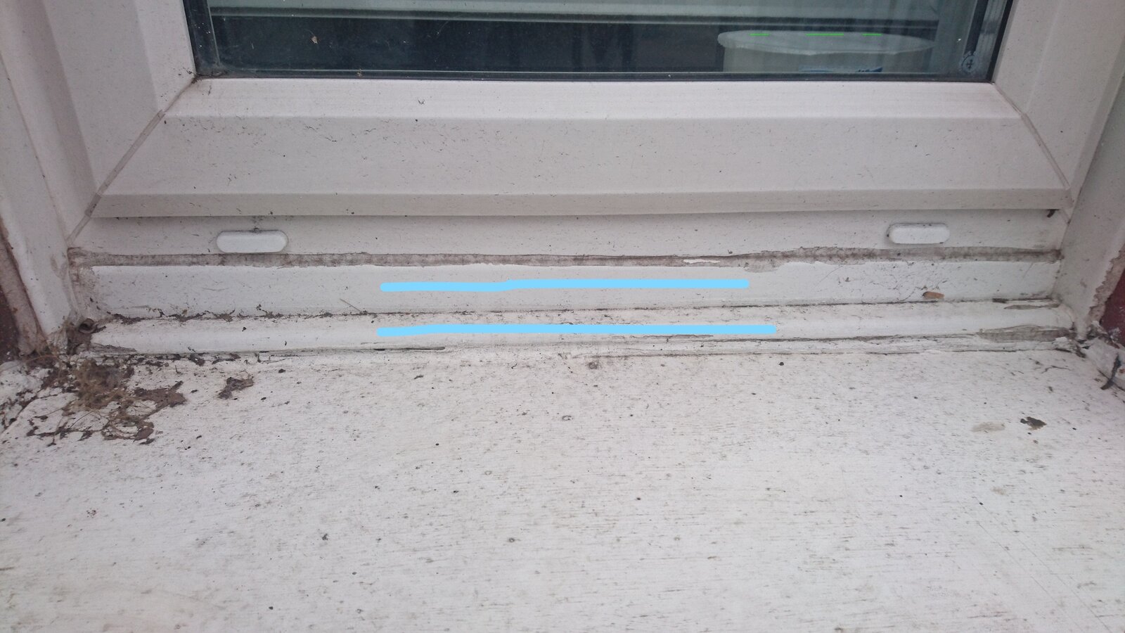

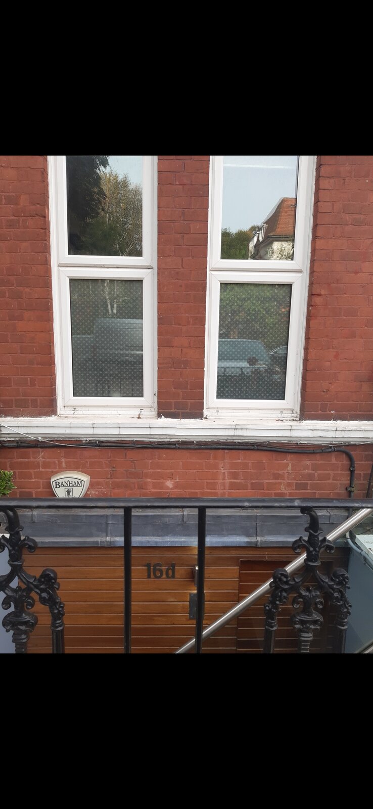

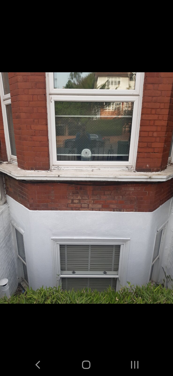

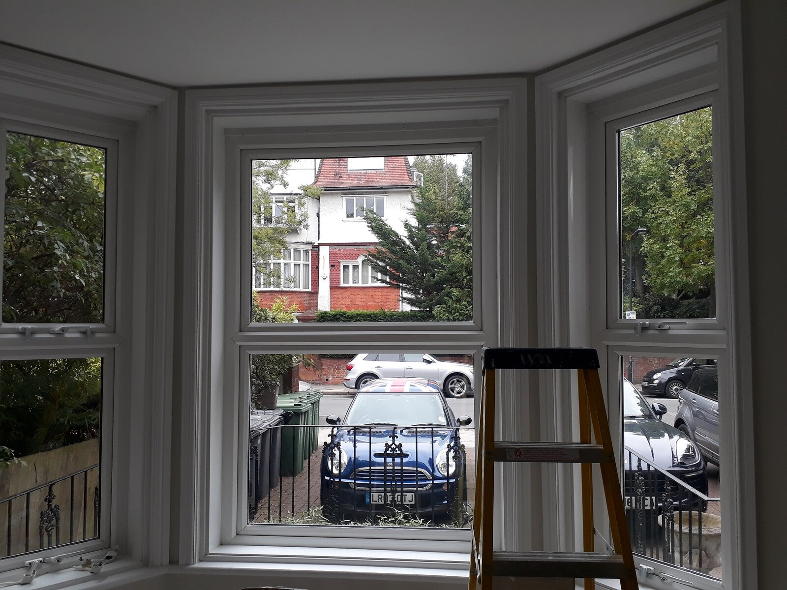

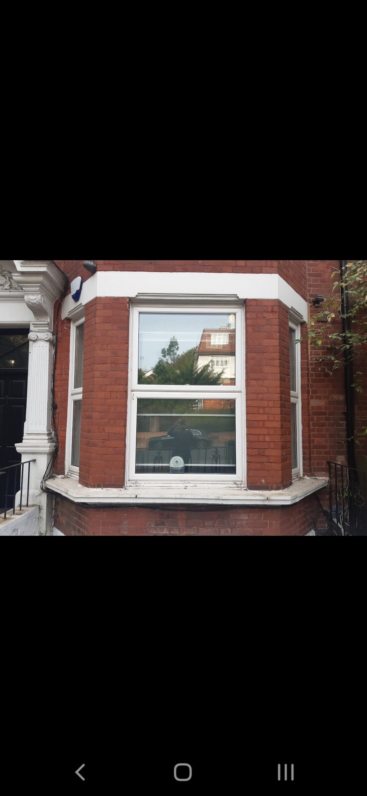

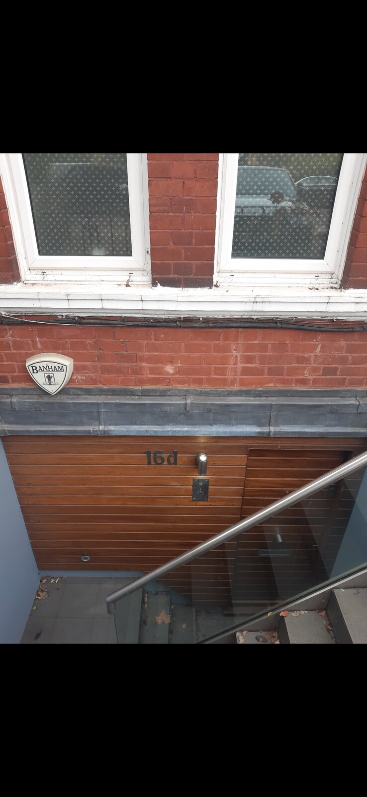

Not sure how well you can see, but pictures here of the existing upvc setup.

Thanks for the pics. Looking at the inside, trim pieces may indeed be required here and there, however not necessarily quadrant. As for the outside, I think your approach is the correct one. The key is not to overthink it I suppose (from a consumer perspective.) Assuming they have measured correctly, looking at the building structure, I see no reason why there should be excessive gaps.
And if you're happy to, post a pic of the finished job so we can see the outcome :)
