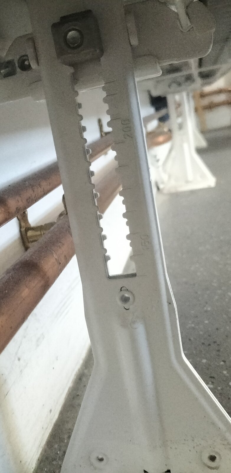

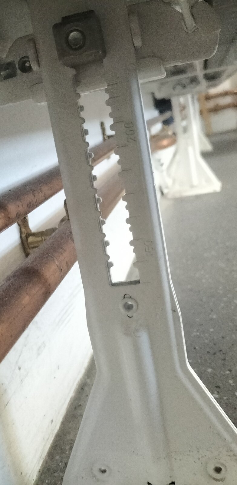

Anyone fit any of the K3 convertor rads that come with legs? The legs look adjustable what's the best way of hanging them?
There the type of legs.

Thanks customer wants over a wider rad. Any advice how to hang with the legs not got/seem the rad yet. Legs look adjustable wonder if hang on wall then attach legs after
Obviously will weigh more.
In the past when had to use these, walls were brick so no issue- did not need the brackets.
Thanks just wondering if you hang the radiator. Then fit the legs to suite afterwards?
The legs are a supplementary support, like you get with the older columns, there would normally still be wall brackets. They reduce the pulling force on the top wall brackets given the extra panels weight. Yes they are adjustable to support varying heights. The nut and square washer loosen allowing the top bracket to be moved up and down the slots in the leg.
