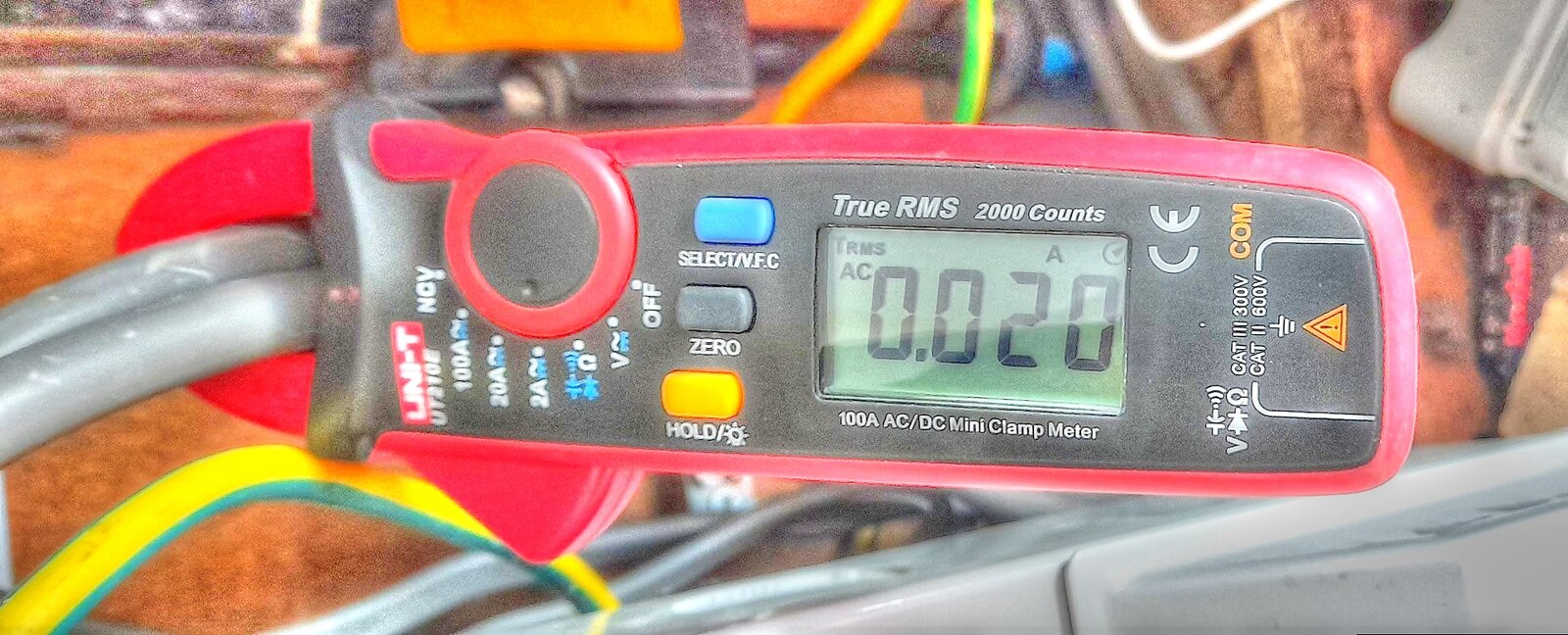

Sometimes a fridge or freezer can be enough to trip an RCD with an N-E fault. Depending on the supply it doesn‘t take a lot of current to cause enough of an imbalance.
My first experience with N-E faults was a rural TT supply with a 100 mA RCD from the late 70s and occasionally during heavy rains a soggy JB in an outbuilding would cause an N-E fault and the RCD would trip randomly. One of the loads that seemed to cause the trip was a chest freezer.
The upright freezer has been the problem for me for years. OK the same type of element used in washing machine, tumble driers, dishwasher, kettles etc. Even with the delay before the element is powered up, one can normally work out it trips when the washing machine is used.
But the upright freezer is never turned off, and the defrost heater seems to activate at random times, so insulation tester neutral to earth is about the only way. Failing that, supply for another RCD, easy when there is a socket on the cooker supply from a different RCD, not so bad if house split side to side, but extension leads down the stairs is asking for problems.
Just re-tested back-ground leakage Earth leakage.jpg got a feeling the cooker seldom used in the back-kitchen, normally cook in front kitchen, but with all RCBOs not really a problem, will only lose one circuit.
