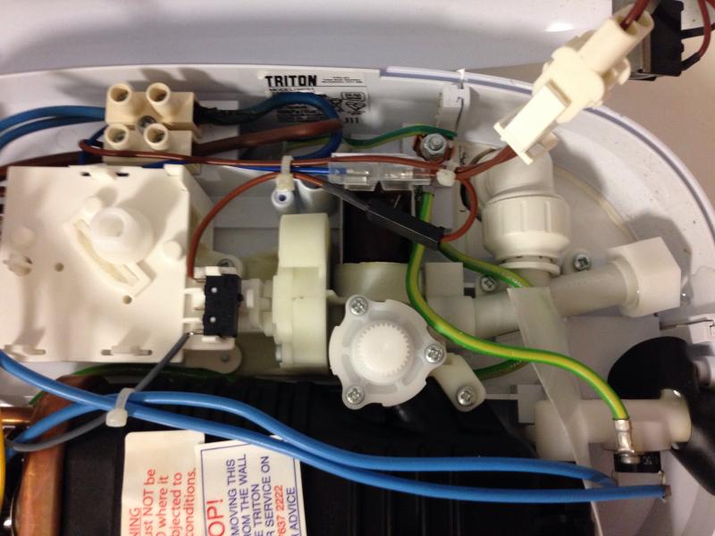

Hi
Leak seems to be coming from around the plastic pipe next to the solenoid
Is there a seal there or will I need a new complete part
Pic sideways? [/url]
Just under the white plastic next to the solenoid where the earth cable is in pic.
Will try and draw on the pic when on PC tommorow
Tanks
Would I need the solenoid aswell or just the plastic pArt
Also I noticed this burned looking wire, could it be anything to worry about
I'd be more worried about sorting the bad neutral connection than the drip.
Loose connection needs cutting back and refitting, and more likely a new choc block
