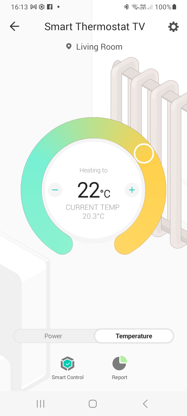

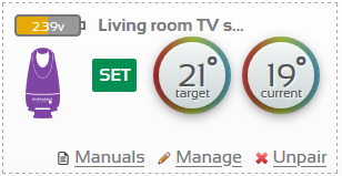

I also tried to balance radiators, I did improve them to what they were, but clearly not right. I found that if the flow it too low, they don't heat the room, which is what one expects, but if too high the TRV can't adjust in time, what would happen is the radiator would over shoot, then I would get a hysteresis rather than a smooth radiator heating and cooling as the room required. I am sure one can set the lock shield using a differential thermometer, I have now found mine, but not the thermocouples, so a bit useless, and most people simply don't have one.
So I used the target and current temperature reported by the TRV head, Flat Battery TRV.jpgScreenshot_20231017_161317_Kasa.jpg both heads show target and current, and if current exceeds target then the lock shield is open too much, with a modulating boiler, does not seem to work very well with an on/off boiler, I turned the wall thermostat up full so that was doing nothing, set the temperature required, and just kept tweaking the lock shield until current never exceeds target.
I am just an electrical engineer not anything to do with heating and ventilation except for stress relief, it is just what I have learnt trying to get the 4 houses I have lived in working. Late mothers house was only one with a modulating boiler, and the TRV's once set worked A1 in her house, they have not worked so well in this house, but main problem in this house is where the wall thermostat is located, in the hall, which is about central to house, but cools too slowly. I can set heating speed with lock shield but not cooling speed.
