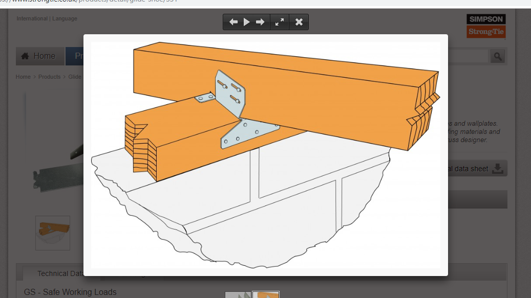

Looking up information on the truss glide shoes used for when using raised tie trusses its saying it can be used on one side or both side of the trusses. HAs anyone any information on why it would only be used on one side. Ill be using these type trusses in my garage so would want to be certain that id be installing them correctly. I will have an opening on the side of my garage maybe 2.8m wide which will have 6inch thick concrete lintels.
Another question, how far can the raise tie be on a raised tie truss. My peak will be 5.4m of the ground and if i ever want a car lift to take a swb transit, where should the tie be. would i get away with a tie of 12.5ft

Glide shoes one side or both I don't know, as for how far the raised tie can go will depend somewhat on the weight you will be loading on the roof and how much you want
to spend.
Slates for instance will be half the weight of tiles.
Glide shoes are fitted at each end of the truss.

Raised tie trusses require specific design and the higher the tie beam the more unstable (they become leggy) the truss rafter becomes. You will need to confer with your truss manu'.

Did you use slide shoes on both sides of the trusses or just one?

Glide shoes at both ends. I have loads more piccies but am too tired to upload tonight.
