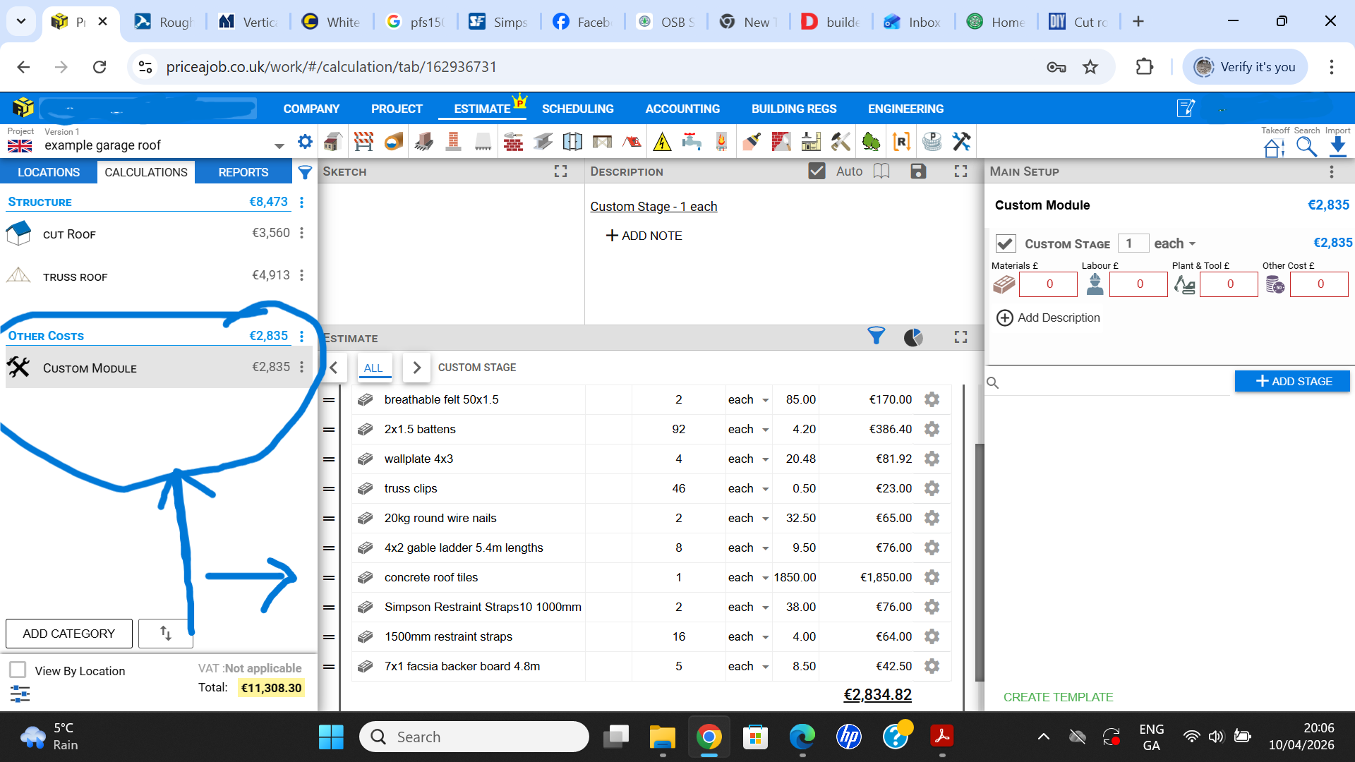

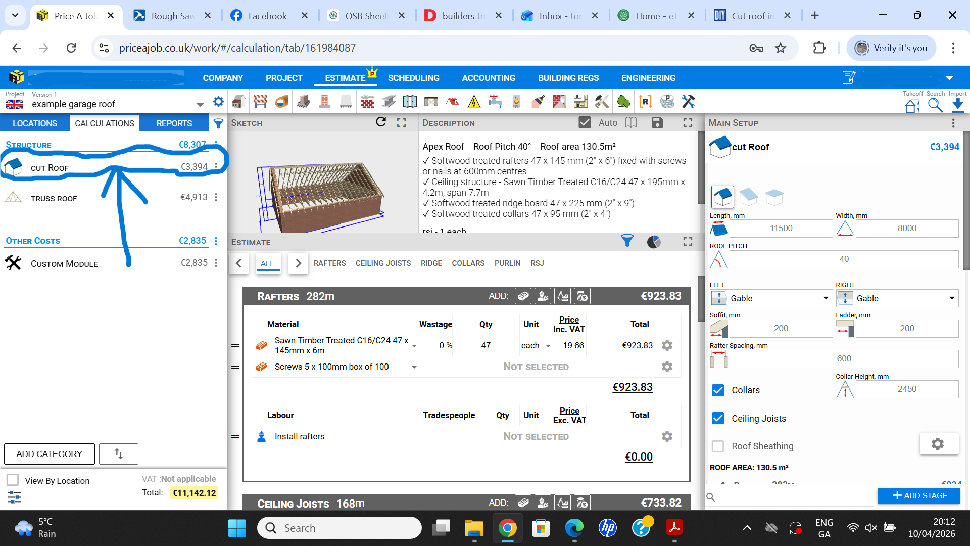

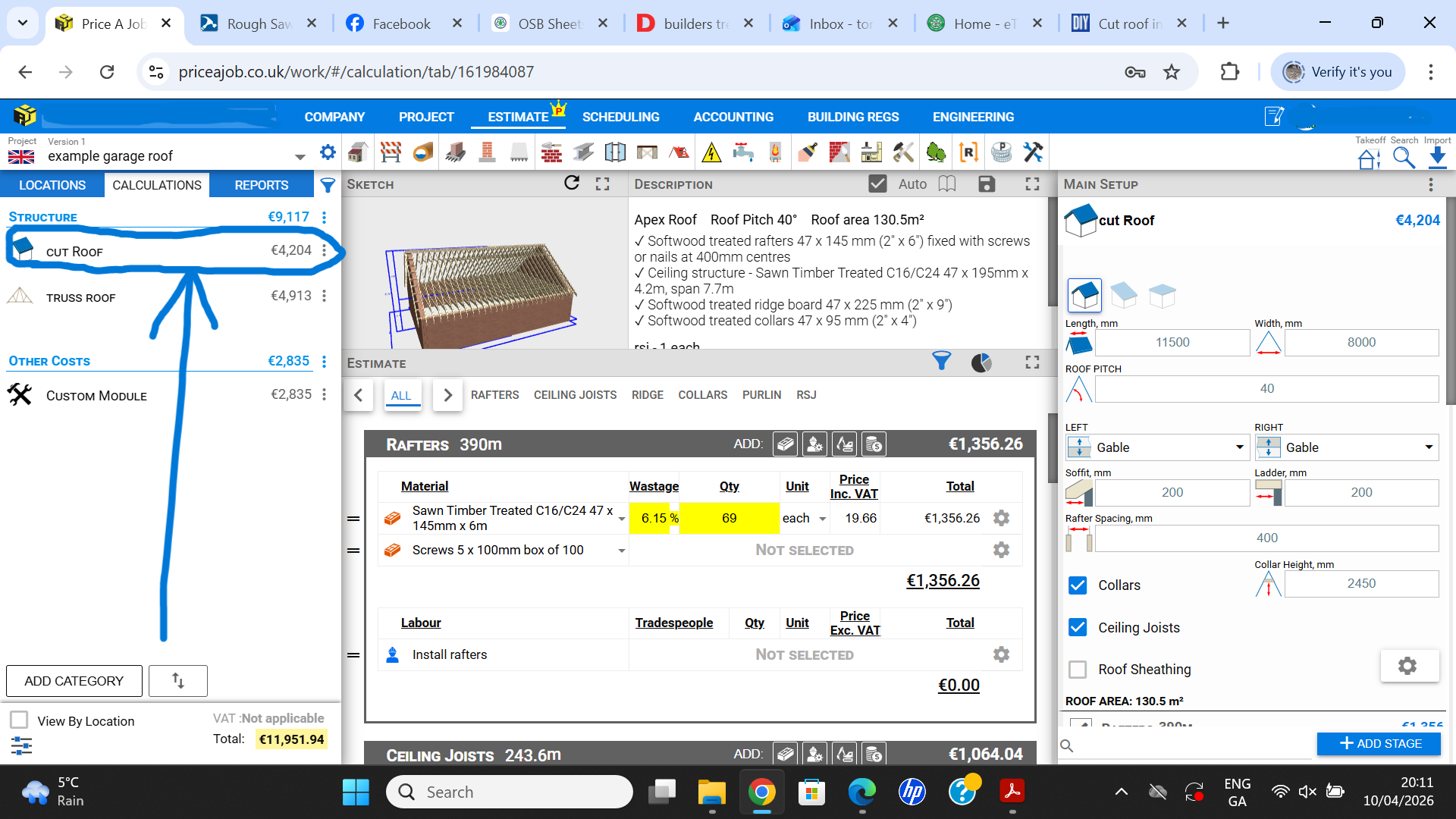

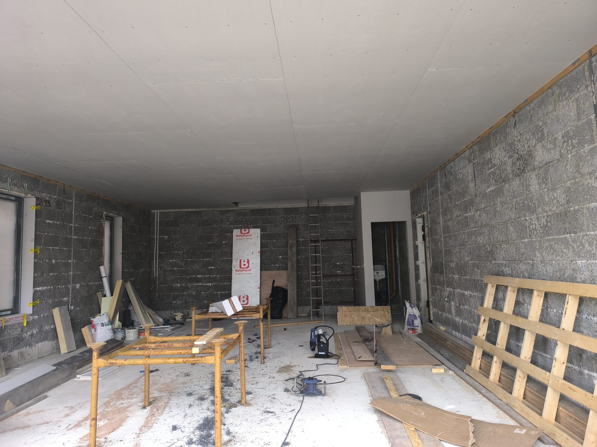

Cut roof instead of trusses

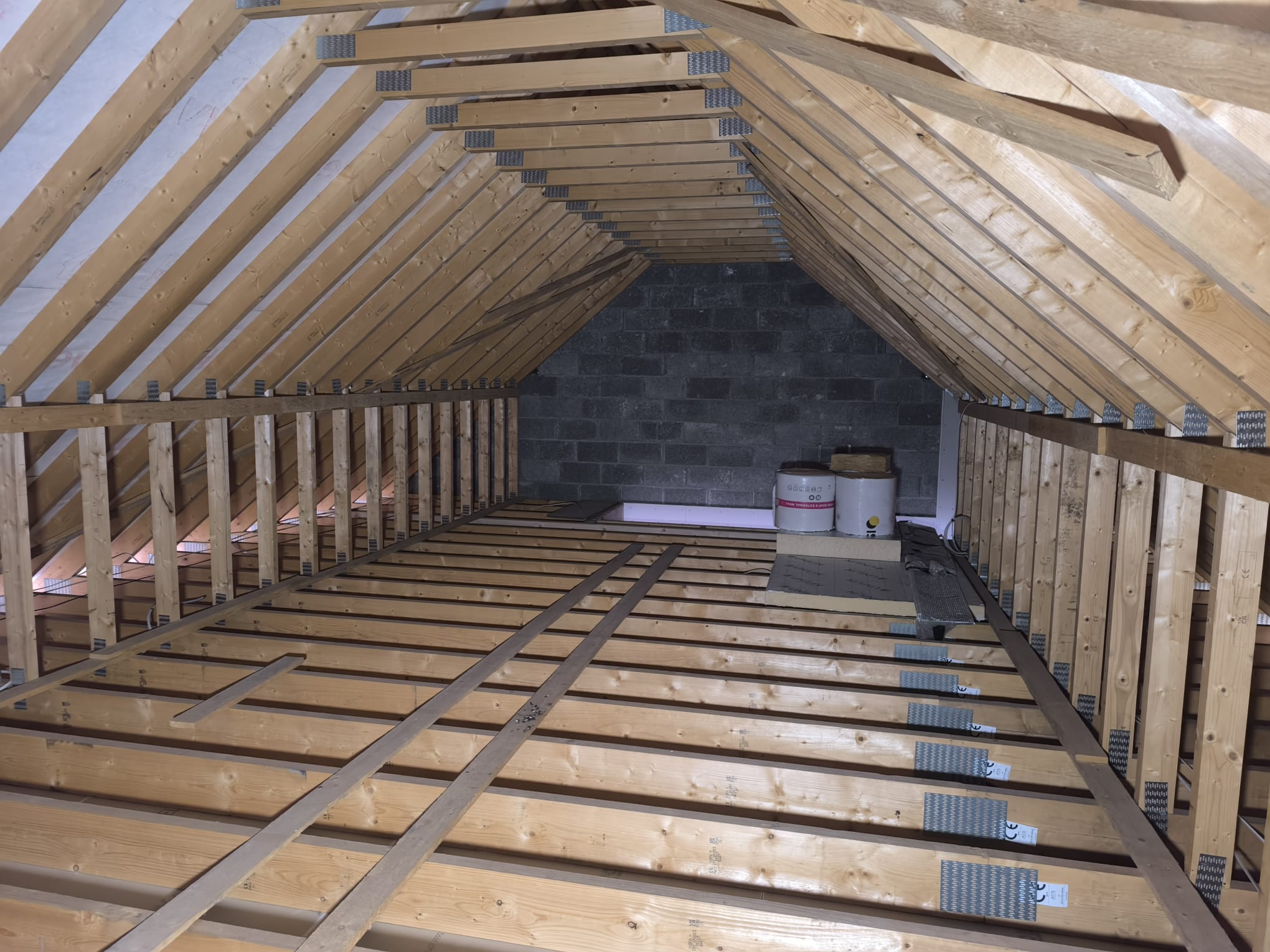

Finally found the detail I was after in all those pics

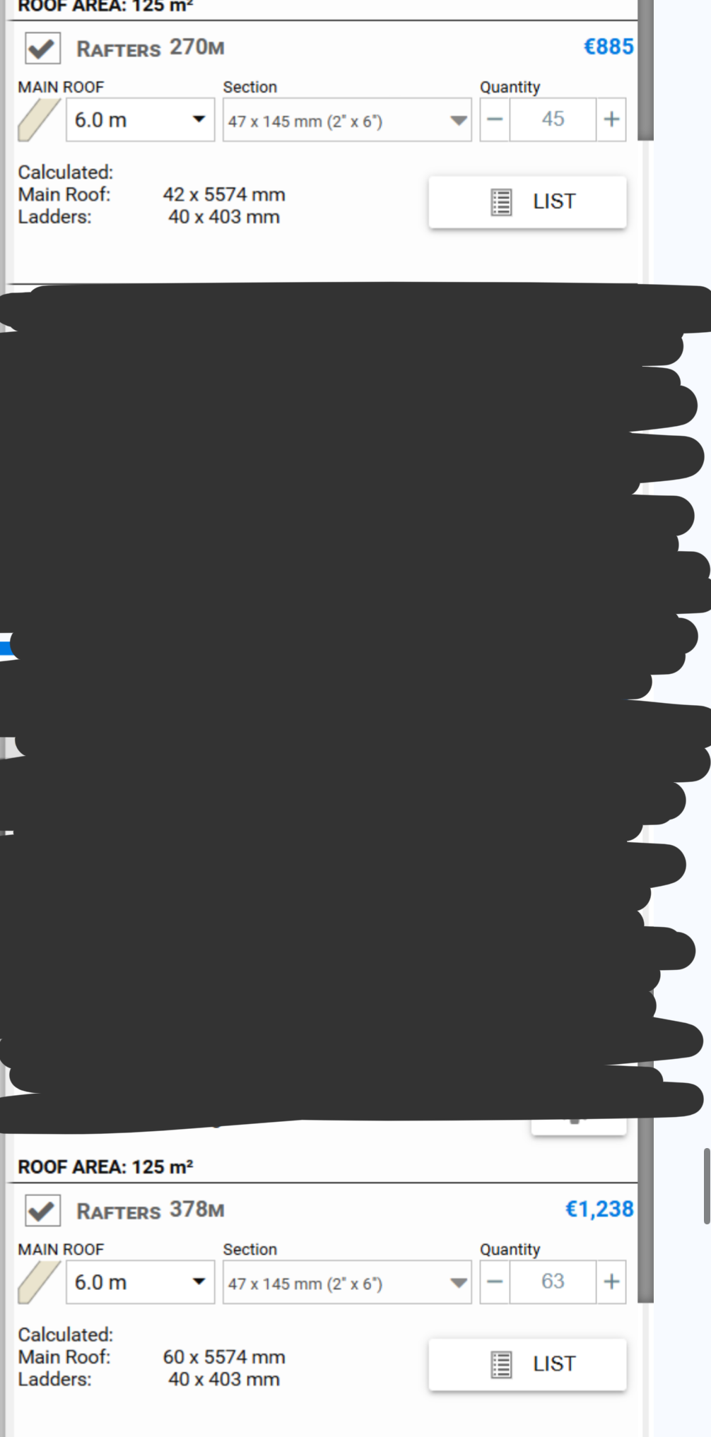

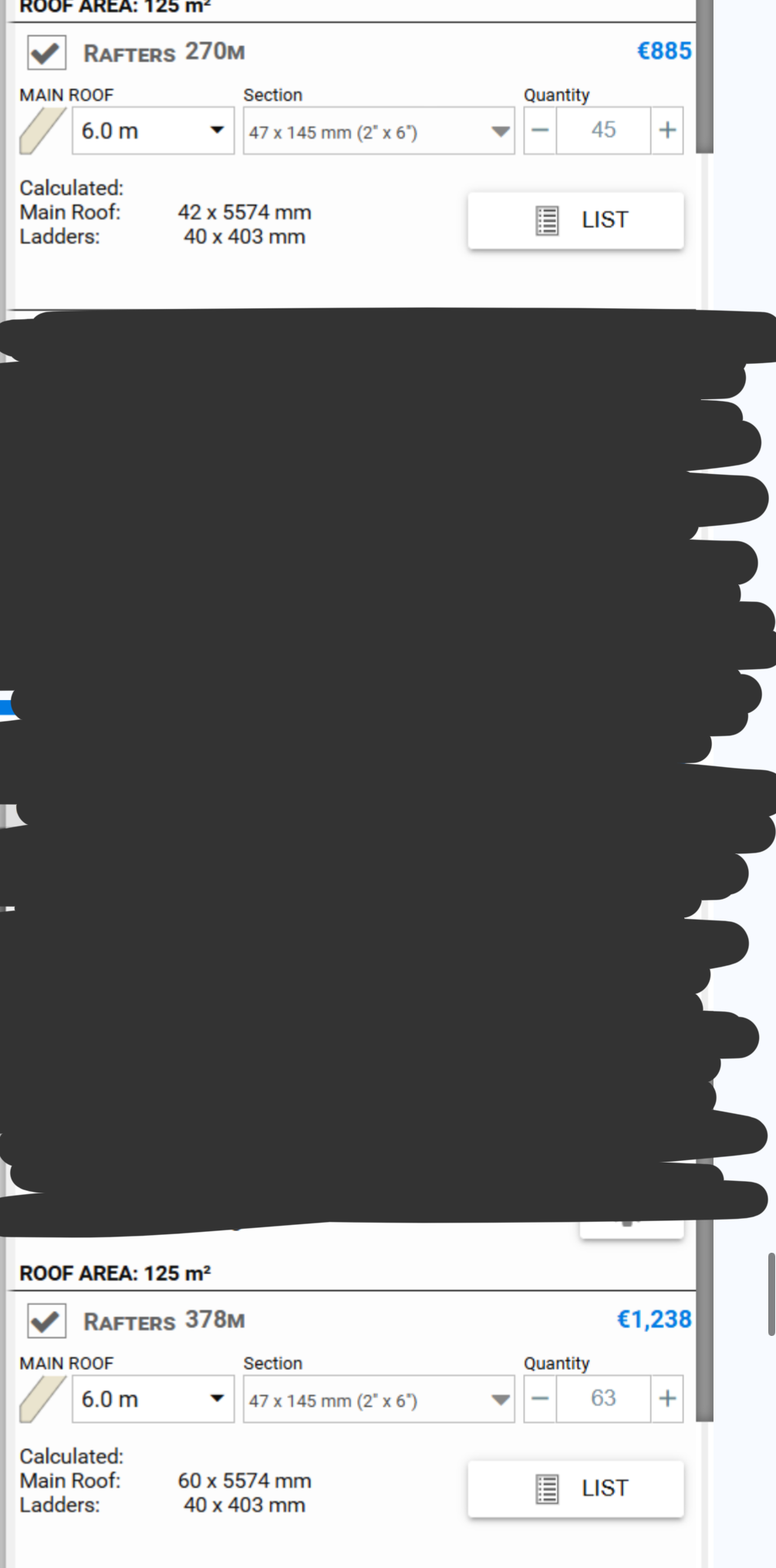

EUR350 difference between 600 rafters and 400 rafters. Buttons in the grand scheme of things..
But if your calcs say 600 will be fine, go for it
Maybe cost in the extra for thicker battens and see how it settles out
Thats a saving for rafters. Still need to factor in more joists and more collars which takes it up to 750e.

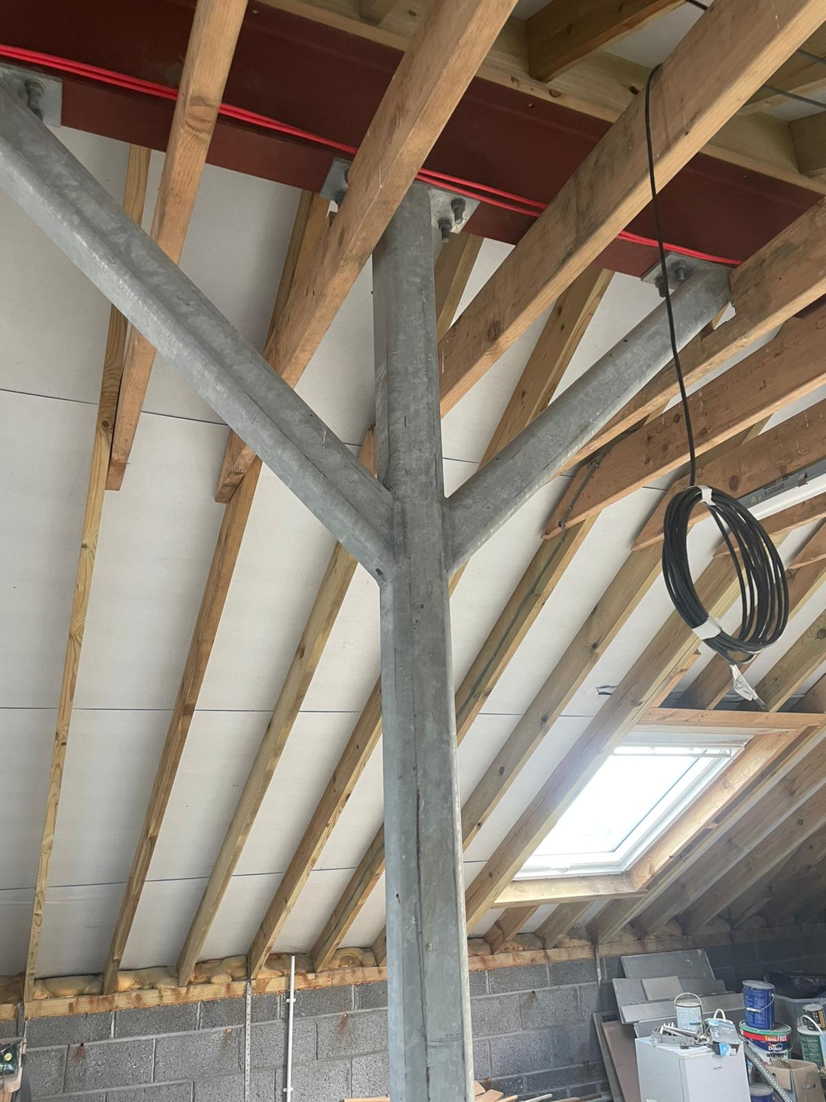

Oh, I thought your ridge beam was structural.. Not sure where that came alon

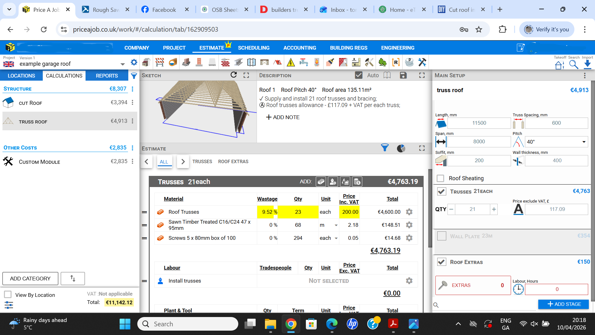

Have you considered a few metal trusses and some chunky purlins?
