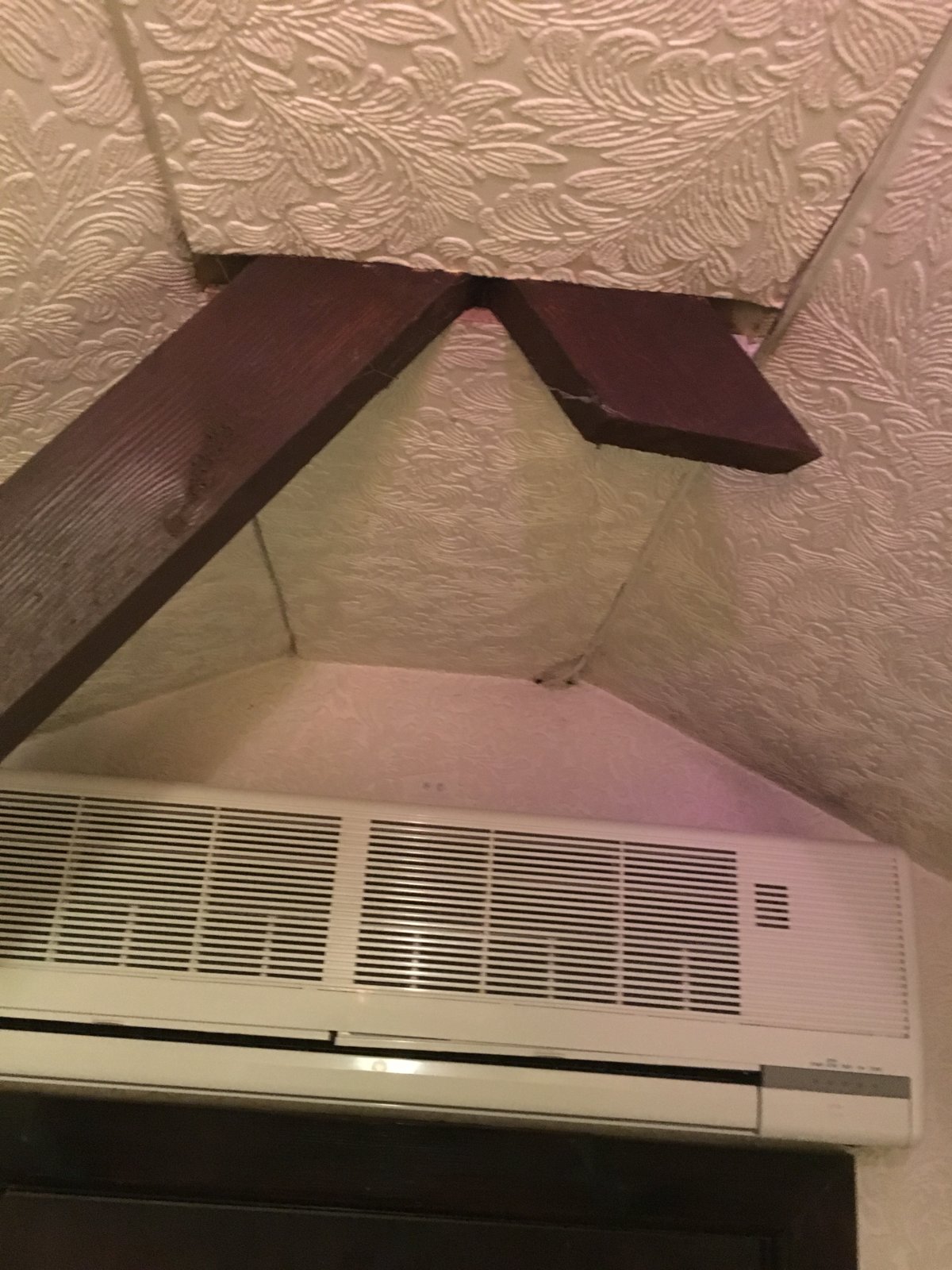

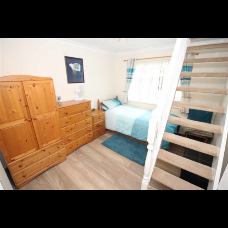

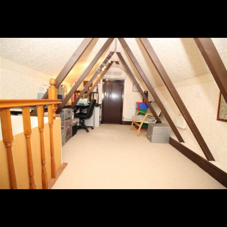

Hopefully posting this in right forum. Viewed a house with converted roof space which has a fixed staircase.

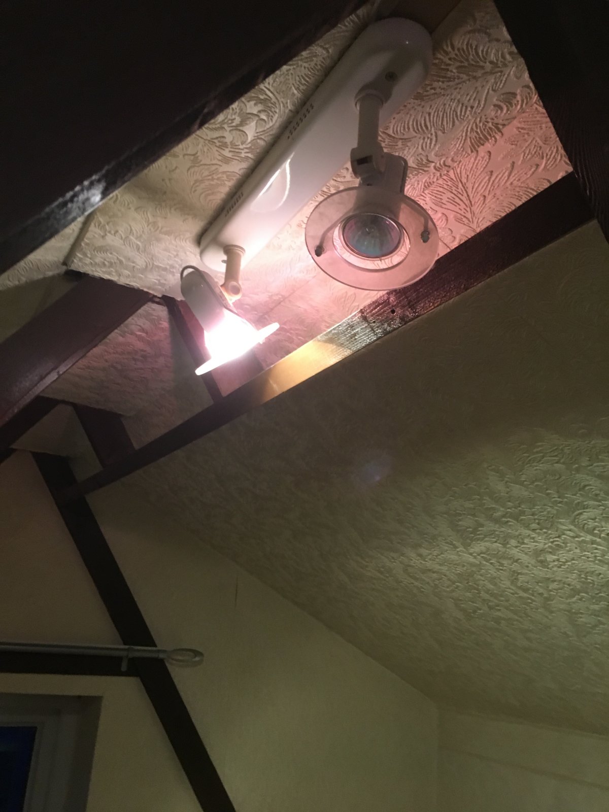

Information regarding building regs non-compliance would be appreciated. As would opinion on cut roof trusses above staircase ceiling aperture and in front of doorway to unconverted attic.

Several questions I would be considering, in no order of importance?
1/. Is there a sign of by Building Control?
2/. The stair appears quite steep? do you have to lower your head when exiting the loft room?
3/. The " cut" timbers are supported on very flimsy bearing?
4/. An "observation" ? The plasterboard around the sloping timbers are poorly fitted.
i have seen a couple of this style of roof, not all that common up here in Scotland one of the examples i inspected had a very weak joint between the sloping timbers and the ridge, it was a simple bolt + washers, on the one I saw one side of the sloping beams had sheared at the ridge, where the sloping timber had in effect pulled through and sheared the top end of the sloping timber.

"building regs non-compliance"? How long have you got?
The staircase is a complete no-no for a start (eg too steep; risers should not be completely open).
Worst point is the cut trusses - absolutely insane;
They probably haven't installed a proper floor;
Thermal insulation to the roof?;
Means of escape/ protected escape route? Staircase should not be located in a bedroom;
No sane person would use that loft for a kids' bedroom - too dangerous.
As you suspect, there will be no building regs certificate. You can get a regularization from the council, but in the end it will cost you £££££££s to make it compliant. Even if you bought the house as it is, when you eventually come to sell, the same problems will crop up. Personally, I'd run a mile.
