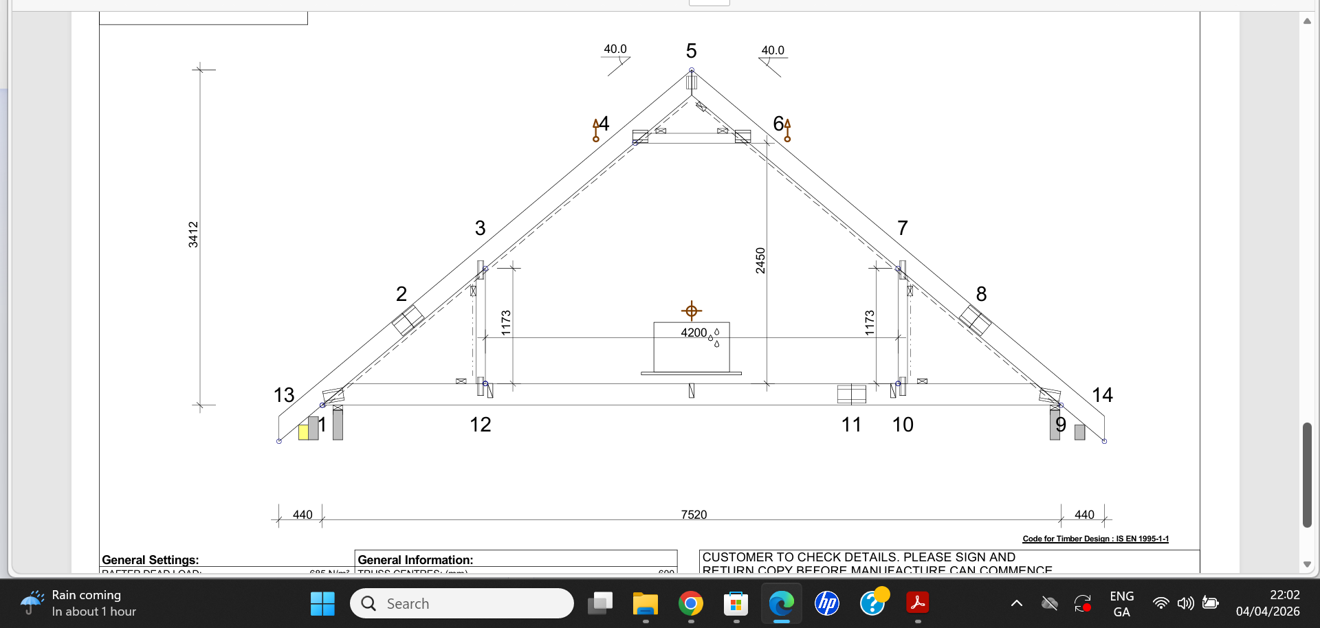

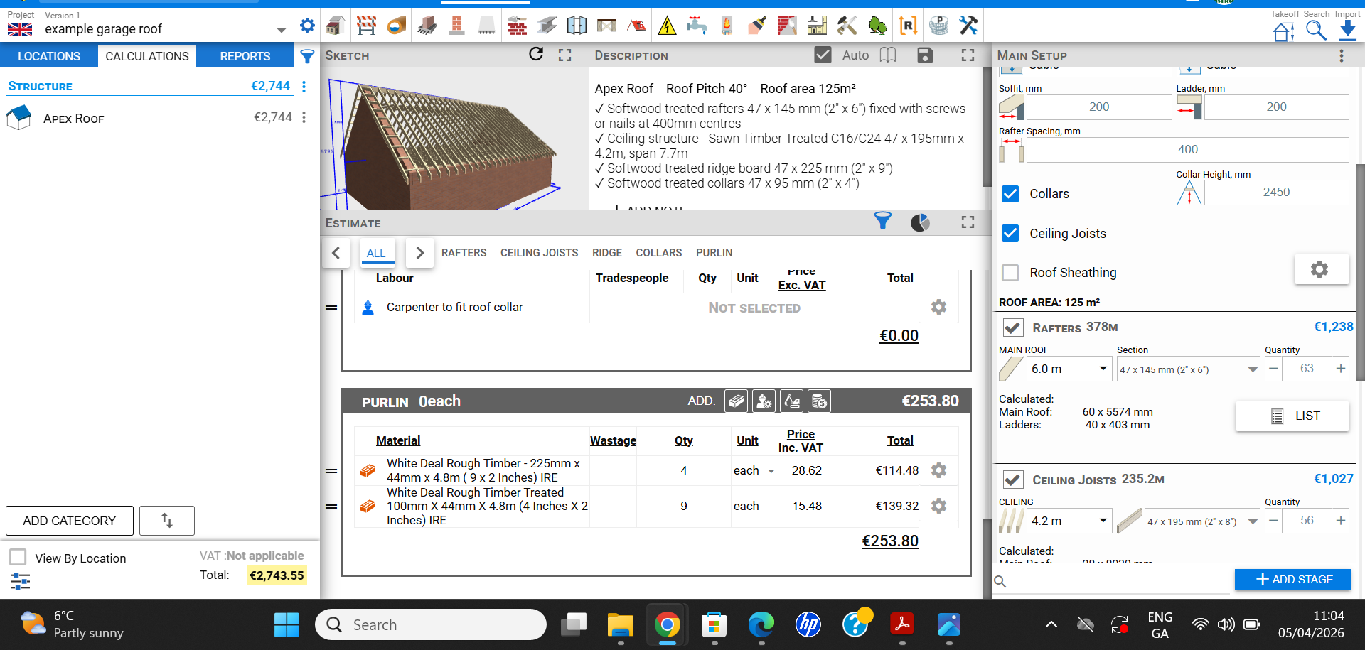

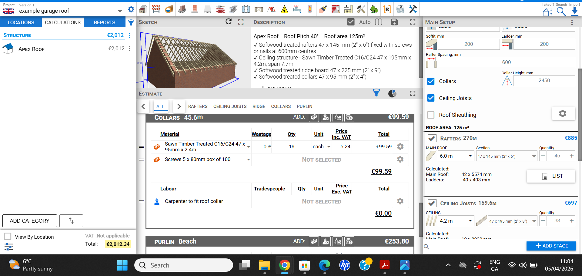

Cut roof instead of trusses

Trusses dont win here thou. Get your calculator out and do the maths noseall!

Flat roof with simply supported engineered joists that you make yourself?
