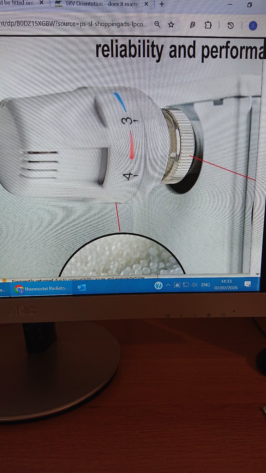

Question from a non-plumber!
Photo from Amazon appears to show the TRV head attached straight in to the top entry of the radiator without a valve or a pipe in to it! Is this really possible?
I ask because I would really like to have the stat where I can reach it but without altering a lot of pipework.
For a TRV to work, it has to have the water flow into the radiator passing through it so it can regulate the flow according to the temperature of the room.
If you could somehow get a TRV which didn't have any feed pipe connection (which your picture apparently shows) how could it work?
Here's a photo of a radiator with the TRV at the top that's not fabricated:
It's from another thread on this forum. Note the pipe comes out of the floor and up the side of the radiator to the TRV. I don't suggest reading the whole thread, it will just make you depressed; just be aware that if you connect the TRV to the top of the radiator in this way, it must be on the flow (input) side.

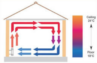

I also found if on the return, setting the lock shield valve so no over shoot, resulted in it taking longer to reach a new temperature than having the TRV on the feed, how much depends on radiator size, and we are looking at circulation so circulation.jpgreturn air is what we want to measure, so just to one side at the bottom is idea placement for most TRV heads, unless using a remote sensor.
The idea is, having a radiator on an outside wall, means the sensor is also against the outside wall, so can turn on the radiator premature, hence option to sense on the opposite wall, but once the circulation is established it does not really matter.

Loads more photos like this ! are they all fake!!?? My feeling is that the head should indeed be on a valve but then I keep finding this sort of thing to confuse me even further!
Found loads more photos like this which is what I would like but I do think it needs to be on a valve or pipe. But are all these photos fake to boggle my mind!!?? Keep hoping somebody has done one like this!!
In that photo, I believe the TRV head is simply being held against the radiator's unused top port.
Where are you finding these images? If you are searching for "TRV at top of radiator with no pipe", because that's what you're hoping to have, then you're going to get images of TRVs at the top of a radiator with no pipes - real or not.
Many thanks Denso 13--that picture and video are just what I needed to convince me that there does indeed have to be a valve! Wish I had one of those radiators! All the good ideas seem to bite the dust!
