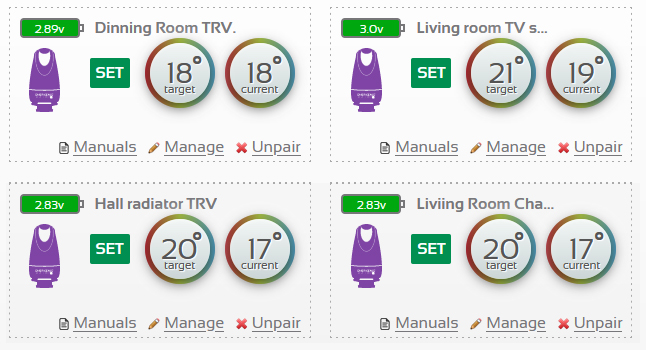

I used electronic TRV to set the lock shield 4 TRVs-1.jpgif the current exceeds target then the lock shield needs closing a bit, unless heated other than central heating, like sun through a bay window. Once set with electronic TRV heads, I found swapping back to mechanical worked great, so I could have used just one and moved room to room.
