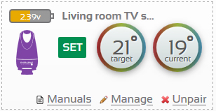

Mother house with a modulating gas boiler, fitted electronic heads Flat Battery TRV.jpg I slowly reduced the lock shield valves until the current never exceeded the target, and they worked very well, however the new owners did not want the electronic valves so swapped back to mechanical and now with lock shields set they also worked well.
This house tried the same as mothers, and had to open up all lock shields fully, the eQ-3 does not show current only target, so can't set that way, one Energenie was broken by carpet fitters, replaced with Kasa and that one has option to work out time taken to heat up, would never work however as boiler starts at same time as TRV so if boiler not running clearly nothing can heat up.

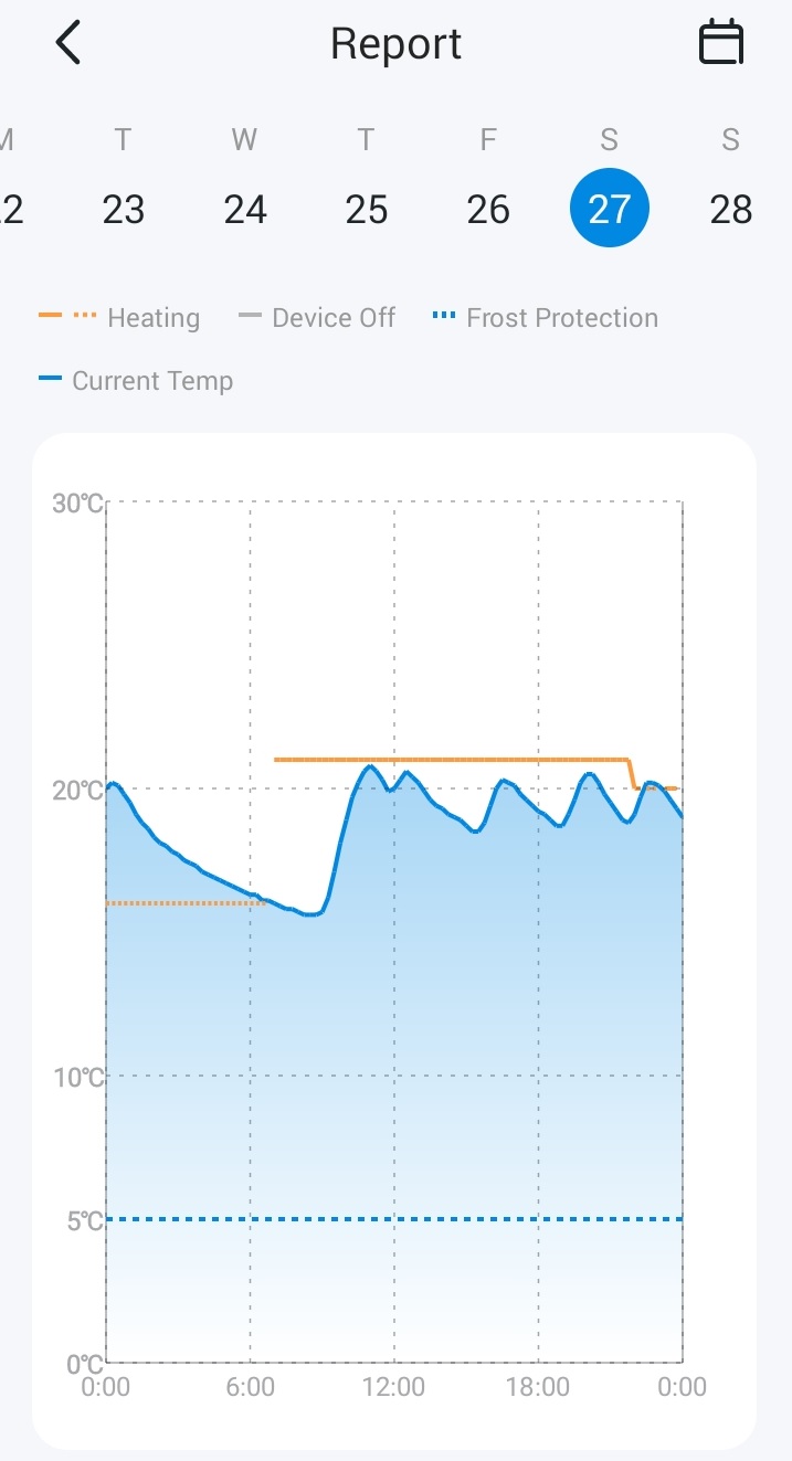

I like the report from the Kasa (TP-Link) head, Report full day.jpgthis shows me how well the room is heating, as to if one needs the report is another question, my first house the central heating simply worked, all rooms got warm, only compliant was static build up, and trays of water in the air intake stopped that, it was expensive to run, but did not realise at the time as nothing to compare with, only real complaint was during the winter of discontent we had no heating when electric went off, so got rather cold. I vowed then never to have another house which relied on electric for heating.
