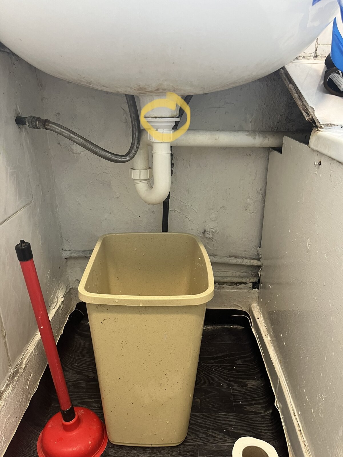

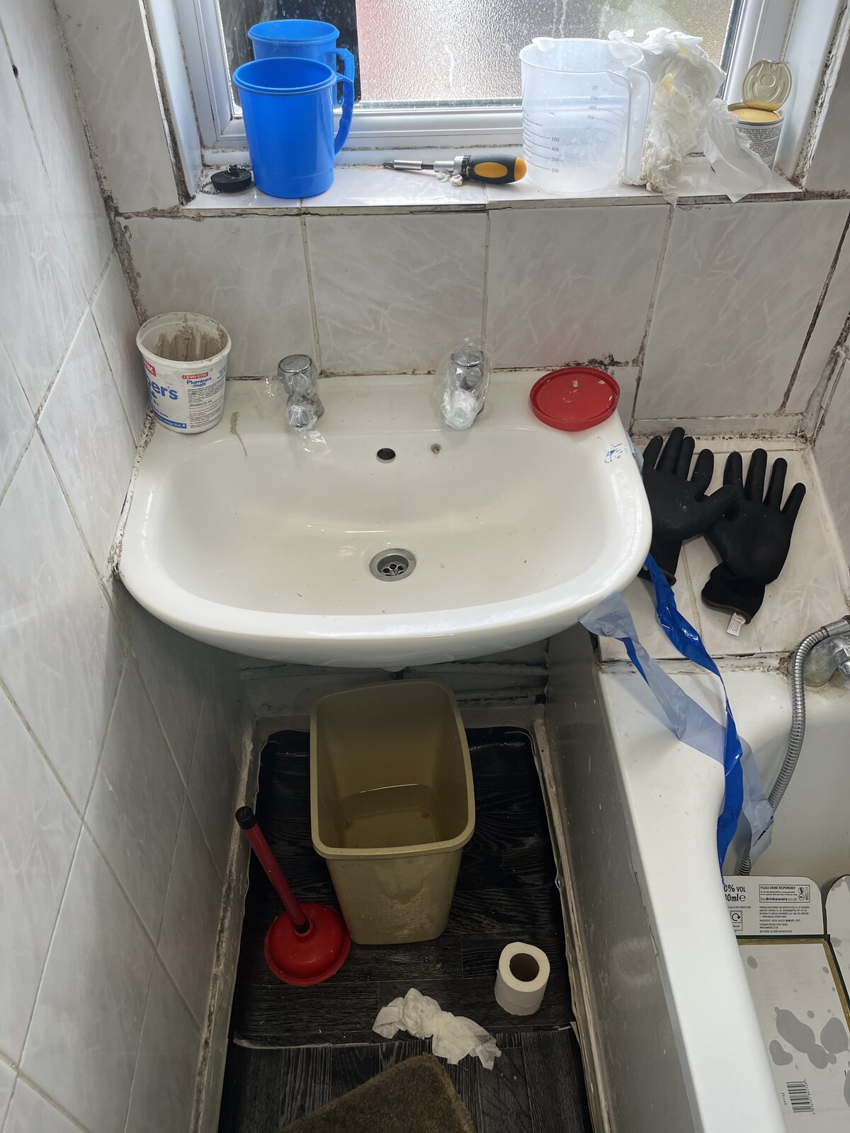

Leak coming from the yellow circled on the picture. It seems too big and it doesn’t secure fully causing water to seep through.
What could I get to replace it ?

Seal may have gone or it's not tight enough. You do get universal wastes like that that where there is a larger lip below to fit different designs of sink.
1st thing would be to take it all off and check the seal. If it isn't too bad then a good clean of all surfaces and then a smidging of silicone and tighten it all back up again may sort it out for you.
That seal is totally gone had a look.

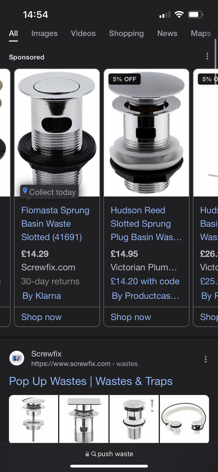

Could I not get a normal basin waste like the one below and just replace it for that.

I'd be very surprised if the seal has just 'gone', they don't tend to just disappear like that but no reason you couldn't just use a standard 32mm basin waste I wouldn't think, as in your pic. If it has an overflow then it's a slotted waste, no overflow then no slot.
Yeah I meant it deteriorated I’ll just get a 32mm basin un slotted waste that should do that job isn’t it
