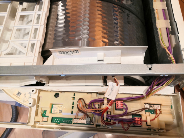

Here's the front control panel. I don't think there are any caps here.

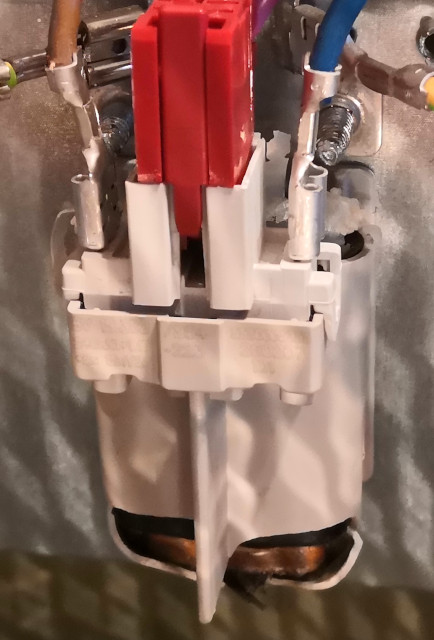

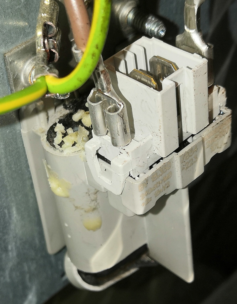

A possible pop candidate is this. The black plastic at the bottom looks torn and could be cause by the pop explosion. What is it and how do I test it?
I didn't know what you were talking about. Now, it dawned on me you are talking about capacitors. Those would pop.

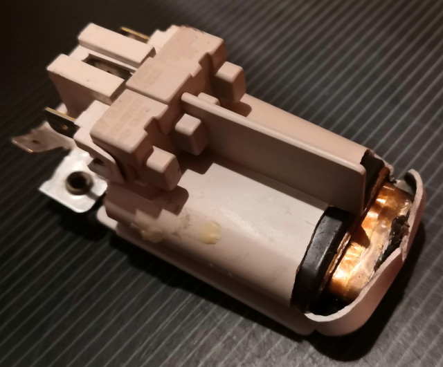

They are not ordinary capacitors, they are special ones, rated to be across the mains supply. As said -usually yellow, but can be other colours, even black. That last photo, looks like a likely candidate, but too blurred to be certain. It looks as if the mains filter, is built as a complete package component, in that machine - so may not be cheap to replace it. To test it, you would need a high voltage capacitor tester, which would cost you more than a new machine.
Going by the expelled electrolyte, the filter capacitor does account for the pop. The dryer does have a little water beneath it. So, what is more likely? 1: water shorted the motor, triggering the RCD and blowing the capacitor. 2: capacitor blew, triggering the RCD, with the water leak being unrelated.

Is there any consequence to using the machine with the exploded filter while waiting for the new £15 part to arrive? Here's a clearer view of the explosion.
