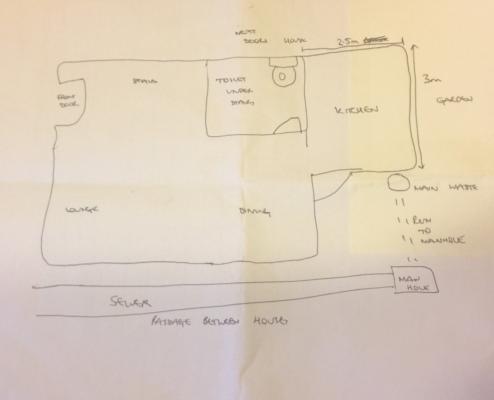

The sewer runs down the side of the house. To travel to the sewer I’d have a 5.5m run through a dining room with oak on solid floor so I had ruled that out.
I’ve drawn sewer on plans...
I’m seriously considering running it without a macerator now and just accepting a lower flow on the limb outside and putting an access port there!
Thanks for the advice.
If the manhole is deep enough you could still follow the route around the house but have some or all of the run underground!
Thanks... Thats a good idea actually. I could just dig up some paving and meet it underground.
Would I need access points/covers when it goes underground or at bends? Also how often do you put manholes etc... I need to look how to plan this if its an underground run but don't know where to start
Underground drainage needs building regulations approval & inspection.
Just sat and tried this... I cannot fit a 4" pipe behind the oven in the kitchen (without massively chiseling the wall back and potentially supporting it against neighbours wall)... I couldn't face pulling all of the units forward. Looks like its back to the macerator...
If you must go the macerator route strongly suggest you spend more $ those 2 you mentioned really are the lower end of the market. A few now are designed for easy retrieval of things accidentally flushed away.
