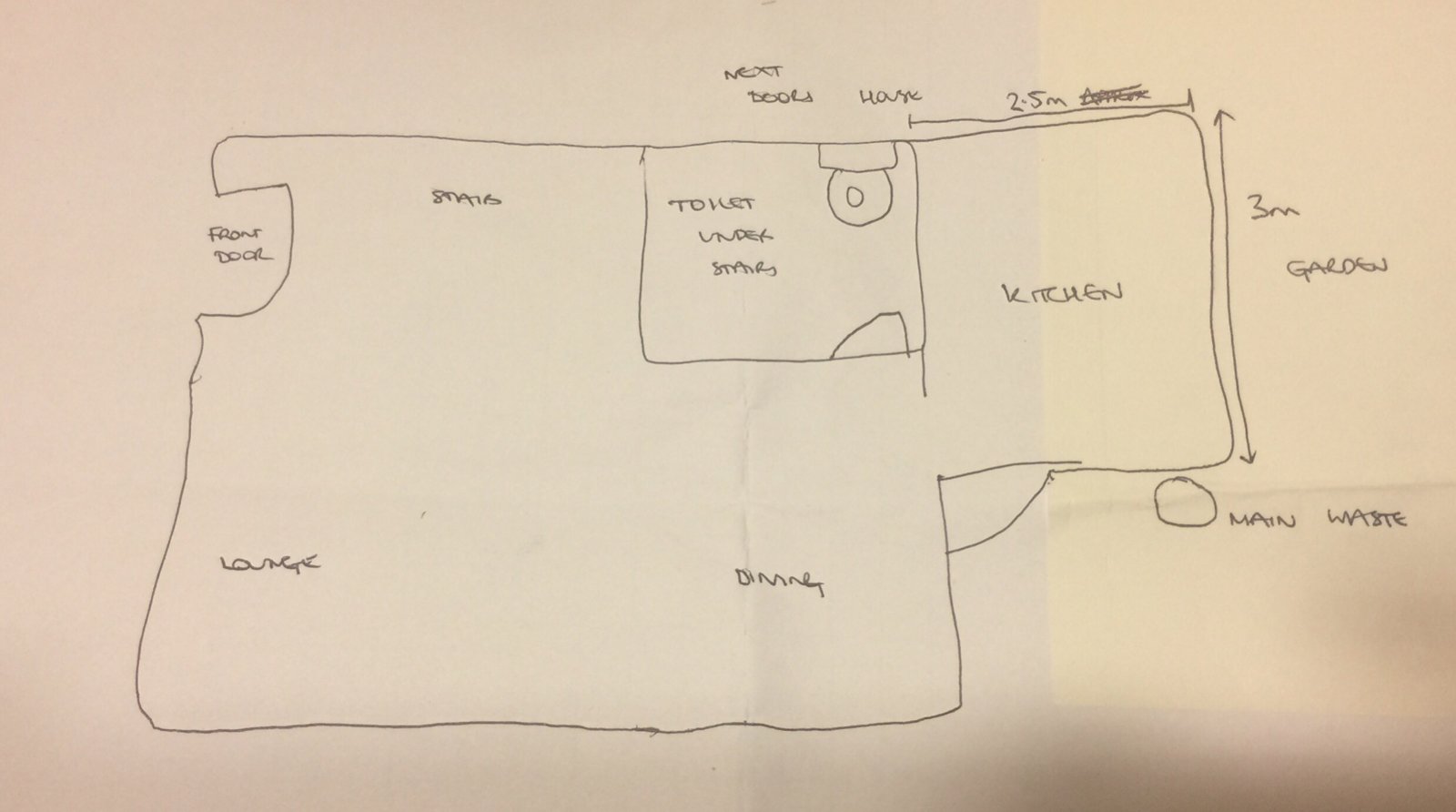

Thanks for that. I cannot get the fall on the 4”. It’s for a small under stairs cloakroom and i wish I could.

Are you aiming for the much quoted 1:40 fall ? Less is fine , depending on your layout. IMHO a saniflow is a LAST resort ;)

What’s the minimal drop? It’s going under stairs (toilet and basin) and I can’t lift the toilet to get the drop. Whilst 4” would fit It would be almost flat for most of the run, I’d get a bit of lift initially with a macerator to get the fall. Furthermore I’d imagine having to plumb the sink into this for part of the run as I definitely don’t have room for two pipes.

Whilst the rule is 1:40 I`ve seen much lower work ok. Go too steep and problems of water draining but not waste can occur. Just make sure the flush valve releases a good flush of 6L of water.
A plan sketch of the install with dimensions/distances would help us help you.
Here is a plan... my art I know...
I could probably get away if I run it 1:40 to garden and then make the gradient less with an access point in the garden?

I couldn’t raise the toilet due to the stairs (there is already low headroom) and the house and garden are level.
