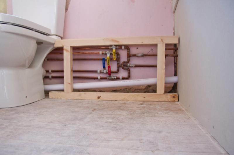

Well usually you would put them on any outlets ie taps, toilets and the like. Reason being if one causes a problem you don't loose hot/cold to the rest of your house. IE our show is fed from a separate feed than out bath. If one started causing problems I could isolate one and use the other with no issues.
For our bathroom I have 2 full bore isolators to the room to shut it all off, then separate ones for the toilet, hot and cold for the sink, hot and cold for the bath and hot and cold for the shower :)
I wouldn't put one right after the boiler as if you wanted to isolate the house, you can just shut off the power to it and the water mains anyways. besides if you were working on a tap you'd need to shut off the cold inlet anyways as well as the boiler. So either way the results the same. Unless you have local isolators to the fittings.
Here's an example. This is accessed by means of a hidden tile. That rooms been fully tiled so we have the 2 yellow handles for room isolation (full bore). Then the Blue/Red for the Bath (full bore), then the right 2 are smaller bore for the sink, and there is one under the bottom yellow handle for the toilet. The shower is isolated from the roof as the pipes drop down from the boiler above.
