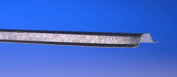

Reason i ask is that we live in a row of terraces and every couple of months we get them ripped from the wall by drunks coming home late at night causing damage etc.
I know you can get plastic coating to hide wires indoors but is there anything for outside? If so what should i ask for?

trunking, you can get it at most diy stores
Breezer, mini-trunking is not UV stabilised so would turn yellow in time and slowly start to break-down, the same with other forms of plastic for internal use...unfortunately. It's a shame that this is the case as MMT1 would be ideal for this purpose.
The best stuff for this would be galvanised metal capping, and paint it to match the brick work, or other surface, before fixing to the wall. This will last the life of the house then and will not end up looking tatty in a few years time.

This may be an easier alternative to trunking, bit more protection aswell.
Steel Capping also available from most DIY shops ;)
