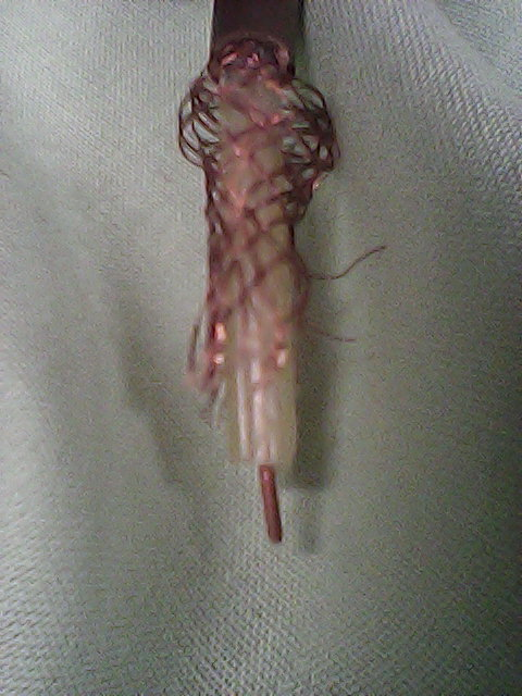

Having recently installed a new 12db gain aerial in the loft, I get around 85% signal and 100% quality yet the TV still gets pixelation.
The cable in the loft and TV socket in the g floor room were already installed when I move in early 2022 so presumably installed when the house was built in 2003/04.
The cable is marked 'pro-power 75ohm low loss coax' but it does not have a shielding foil under the outer metal braiding.
Is the cable acceptable for Freeview?

To be fair, it's not the best - it has limited screening ability, and so might well pick up all sorts of RF noise, such as thermostat clicks, anything switching. Modern coax would be much better, such as CT100, but there is more modern than that FP100 I think.
It might be cheaper bought by the full coil, than by the metre.
You have low loss coax with pretty poor braided screening. ProPower seem to be a CPC/Farnell own label brand? Their website is not playing ball so I can't tell if all copper or nastier stuff.
It'll likely work OK unless running near other things that produce interference, when the lack of screening will become a big issue.
CT 100 was dreadful stuff... Air spaced. No longer made. Other brands use the CT100 name for some really dreadful coax. Avoid!
Webro WF100, Philex (spit) PF100, Triax TX100 are known brands. All copper core, braid and foil are the key with foam core dielectric.

Yes, the pixelation is across all channels when it happens, even with good signal.
Having given it some thought, the cable I mentioned runs down in the wall from the attic to the the g floor room. The wall is the divider between mine and next door. The houses are wood construction and next door's electronic gadgetry could well be causing the bother.
I'll experiment with a WF100 cable routed from the attic, down the staircase direct to the TV.
