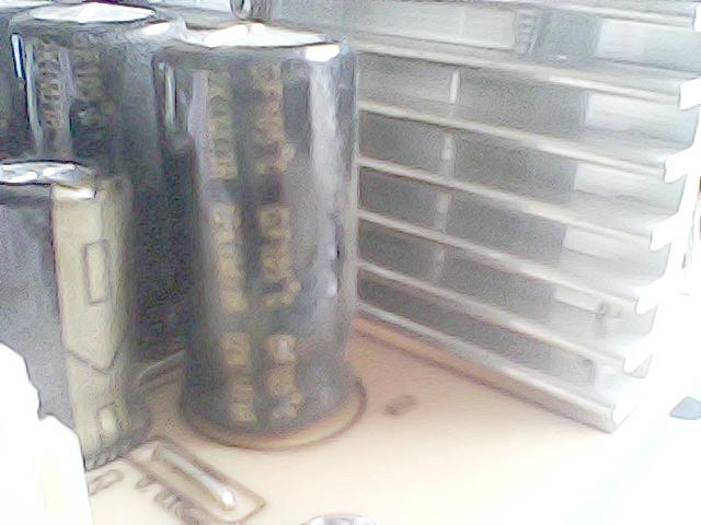

The TV is usually left on standby. When switched to ON, the screen flickers for about a minute then settles to a good picture.

I took the back off and found three capacitors with a slight bulge so perhaps the culprits?

If a capacitor had failed, then IMO the flicker would not have stopped after a few minutes. Although the flicker must be in some way heat dependent which indicated to me there is a dry joint somewhere that closed up as the set's temperature increases.

I'll get the capacitors replaced. Perhaps one of them have a dry joint.
These caps are the same spec stated in the article I quoted above.
Are they suitable replacements?
They are the same type, electrolytic, so that part is fine, as is the style. The other two things to watch for are the voltage, which must be the same or higher, and the capacitance value, which must be exactly the same as the originals.
Note they are polarity sensitive, so must be inserted the correct way round.
I've checked and the caps in my TV are the same spec as those in the article. 35v 470uf

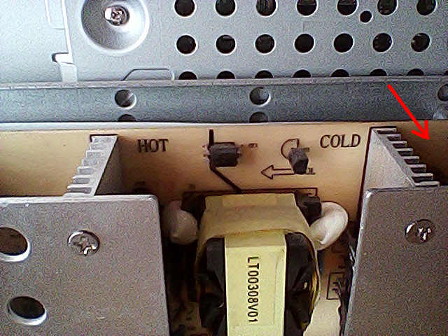

I've also noticed that the PCB the caps are mounted on is marked HOT and COLD, the faulty caps being on the side marked COLD.
I can't say I have ever seen that before, my best guess is it refers to the mains input side, live - hot, and the low voltage side - cold

I asked them about the HOT and COLD marking on the PCB.
I quote their reply,
HOT represents all of the high voltage side of the board, and COLD, the 'safe' low tension voltage side of the board. You see in your photo, the small 4 legged Optoisolator bridging between the high voltage and low voltage side of the board, this allows the low voltage side of the board to give control signals back to the high voltage side, without electrical connection, its done by light inside the optoisolator.
Exactly as I suggested then.
