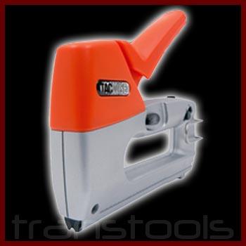

Despite my suspicion that use of a tacker gun caused my problem in the first place I was impressed by the neatness of the job they do. I generally remove cable clips when I'm decorating the area involved but restoring them can be a trial.
So, I'm tempted to get one (which I'll use very, very carefully!). Can you recommend any particular brand/model, please? I don't really need 'professional' quality, just something that'll last through a few decoration cycles and for which cable staples are easily obtainable. I have in mind something around £20 though that's flexible.
Joe
If you have damaged the cable in the past its either because the tacs are the wrong size or too much pressures was applied this is what i use,believe me after you`ve tacked 40m of cable and then damage it and have to re do it you soon learn to check the size a pressure first :p
Tacwise Z3 CT45 Metal Cable Tacker screwfix
