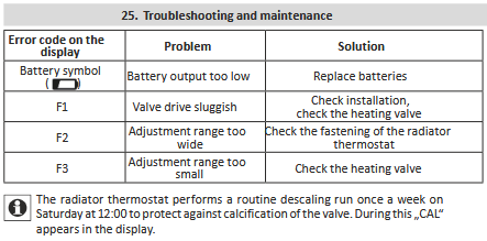

With mine, I get a warning on the head.
and the heads exercise the valves once a week.
