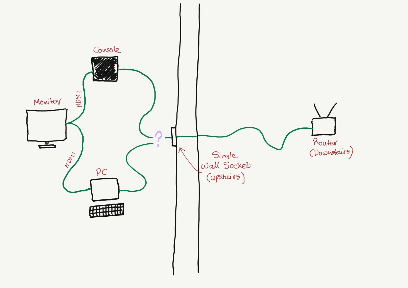

Hello,
Is it possible to connect two ethernet cables into a single RG45 type socket while keeping a connection for both?
We currently have a desktop PC and a games console sharing the same wall socket connection but have to keep unplugging one or the other to use them. Would prefer an option that doesn't degrade the current internet speed (if that's a thing!).
Thank you for any advice.

Managed to get a diagram knocked up to show my problem.

Just buy a cheap switch and another ethernet patch cable, plug the 2 ethernet cables into the switch and then the third from the wall socket to the switch.
I have a couple of netgear switches but you can get tp-link gigabit switches from £10
The latency/timing delays will be so small they would be irrelevant I'd imagine.

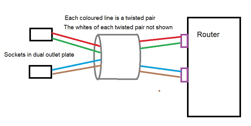

If the cable from the router to the existing socket is 8 core ( 4 pairs ) then one solution might be to split the cable at each end into two circuits of 2 pairs each.
The router assigns IP addresses to each ethernet based device that connects to it- on a per cable basis. So no, you cannot use a splitter.
Follow Joe's advice. The router will assign an IP address to the switch, which in turn will assign separate IP addresses to each of the two devices.
I would not advise splitting the 8 pair ethernet cable in to 2 lots of 4. The cables are twisted pairs. The extra 4 (unused) cables are designed to reduce cross talk. And if you did that, you would need to try and fit two ethernet plugs at the router end and fit a double wall socket.

I would use an 'Ethernet switch' as a splitter.
It will take one Ethernet cable from the wall socket and then two Ethernet cables to the two items you have that need a connection. Also gives you some more spare connections to other items you might get in future.
No other work and no programming needed. Simply plug three Ethernet cables into switch, mains power into switch and your main (downstairs) router will sort it all out by itself.

A hub is an old fashioned device, completely obsolete now. A switch is needed. There will be no noticeable 'timing delay or contention'. It's still all just one layer 2 network.

An unmanaged switch will just forward all traffic to the router. The router will will still assign unique address to each device. It is not a per cable basis. Using a switch is the simplest solution here.
Thank you for all of your help everyone. I've just bought a switch as per the advice!
