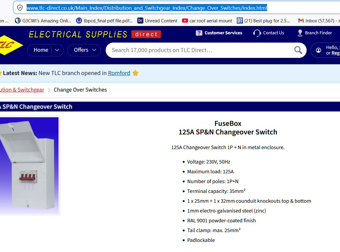

It does not seem to like the link, I assume this is the page you were aiming at?
The link works for me and takes me to here: https://www.tlc-direct.co.uk/Main_I...tchgear_Index/Change_Over_Switches/index.html
Link didn't work for me either, but searching using the changeover term would this be appropriate?
Link

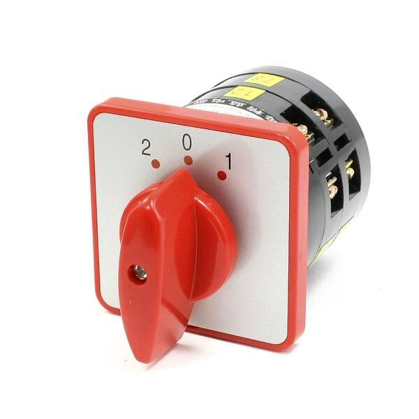

Heschen Universal Rotary Cam Selector Changeover Switch
If clicking on the link doesn't work - simply copy and paste it into your browser.
It would be sensible to use a 3 position rotary switch with a centre OFF state, This ensures the two supplies cannot be accidently connected to each other when switching from one to the other. ( faulty or welded contacts in the switch )

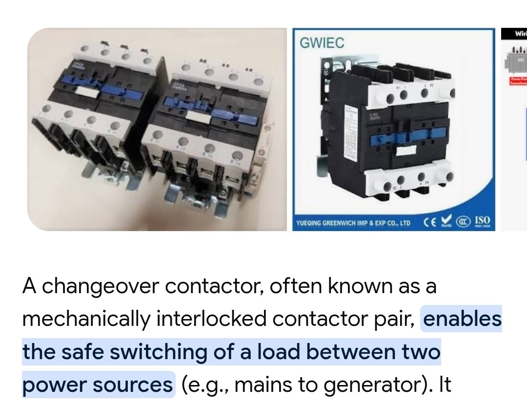

I'd probably do it via a contactor you can use any switch or key switch or timer or whatever to change over.
This is purpose designed/produced for the purpose
Other makes exist.
I don't know where you got that from but:
A mechanically interlocked pair is 2 contactors
Whereas
A changeover contactor is a single contactor.
Not 2 with interlock?
Either version of a mechanically interlocked pair OR a changeover will do the job.
The difference is using a mechanically interlocked pair will result in a contactor being operated at all times.
Yep (y)
