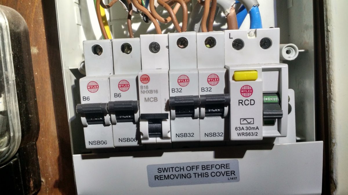

Two wall sockets keep tripping the fuse box.
that offending 6A was clearly knocking around in the back of his van for a while, just wanted to get rid!!
Fully agree with you because compared to the other ones it looked tired and nackered.
The breakers should be checked to make sure they are not part of the recall.
That circuit should have been mentioned when the time came for the spark to test, inspect and certificate it.
I would get rid of the lot into one board and get shot of those stripped-back tails at the same time. And the rubber tails....And the tackily connected bell tx...
How is the bonding to gas/ water/ oil etc....?
@mediter Thank you for the picture. As you guessed, the 6amp MCB is incorrect. The circuit is wired in 2.5mm² cable but, as there is only one conductor, it has been wired as a radial.
So, you need to put a larger MCB in there, but not more than 20amp. Wylex have 16A or 20A MCBs available for that board. One of those should sort you out.
Thank you so much for your help. At least it is something easy to sort. Now my daughter can have a reading light that works... and whatever else she can plug in.
Once again thank you.

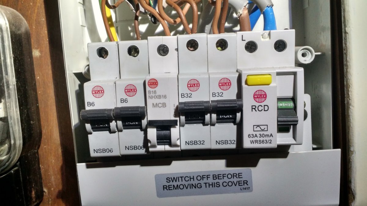

Finally I have good power coming through the plugs with no drama. However, the replacement I bought is different than the rest and I am just wondering if it is the correct one. Please have a look at the picture and kindly advice. It is the one in the middle which is quite diffent than the rest.
Wylex have changed the design of their MCBs so the one you have bought is the latest. You wouldn't get one to match, unless you look on the second hand market, and I wouldn't recommend that.
CU makers have a habit of changing the look and style of their breakers, and it's a real pain as it spoils the aesthetics of the install. MK and Hager Have recently done this. functionally it will be fine though.
They changed the design after Breakergate. All breakers pre Breakergate are like the original breakers in that board: a thicker switch bar that is higher up the body.
As an aside, I personally think the new design is pants: there is less to get hold of if you have old, arthritic fingers to switch the circuit back on. It would have been better, in my view, to keep the same design but distinguish the new batch of breakers by fitting a different coloured rocker.
