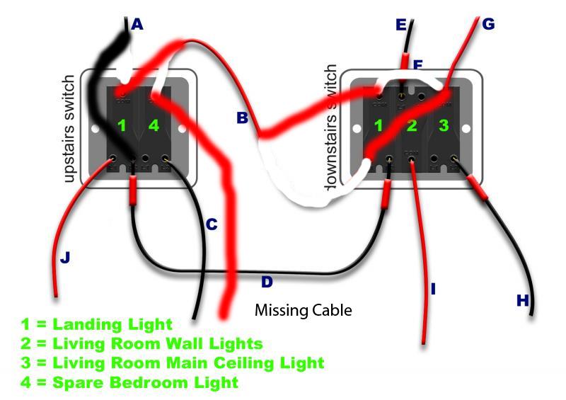

I have attached a diagram which I have created to illustrate what I've currently got. It looks nothing like the two way switch wiring diagrams I can find on the internet.
What's happening? What do I need to do to make the light work from both upstairs and downstairs?

If that is truly how your lights are wired then
1. Your living room wall lights cannot work as the switch only has one conductor to that switch
2. Your spare bedroom light will only work if the downstairs landing light is on.
Where does conductor A go to.
Can we see actual pictures of the switches and wiring.
Can you advise how you have determined which wire is which. Methinks you have made some assumptions that will lead you down several garden paths.

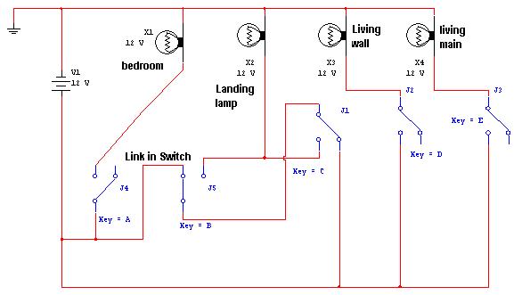

The odd wiring is because done with Multisim which allows me to test it all. Ignore the earth software will not run without it but it should not really be there.
To give some idea here is a standard wiring diagram
Took more care with this one to draw circles around the wires forming a cable. X2 is the two way lamp and between the two switches it shows three wires. In your case there are only two wires and the bottom of the two switches gets its line supply from another switch in the group.

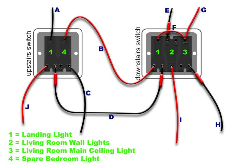

The following diagram is I am sure what I have at the moment.
So wires E and I make sense, they are the Living room uplighters.
It's probably worth mentioning that the spare bedroom light is on the upstairs fuse where as the landing light is on the downstairs fuse. (I am knocking the lot off when working on them).
I have also discovered by playing with different switch configurations that the way the main light in the living room is switched effects the landing light.

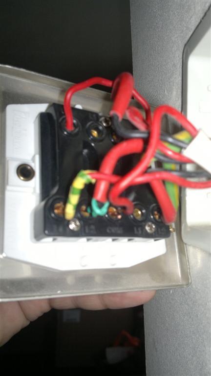

I have taken a couple of photos although they are not very clear. The bits of insulation tape are simply there to identify each wire I'll remove them when I've done.
It's still nonsense.
Switches 2,3 & 4 should have a permanent live at one end and switched live to a light at the other.
Switch 1 should have permanent live to one single end at one switch and switched live to a light at the single end at the other.
The two terminals at the double end of both no 1 switches should be connected by two wires.
All the permanent live connections can be links from one supply wire.

First the down stairs switch.
The line link should go to L1 or L2 not Com so that's wrong.
Upstairs complete mess up as down stairs link should go to two way switch only. There seems to be a wire missing. Most cables come with red and black so should be same number of reds and blacks. You show one more black wires than red wires.
I will guess wire C has a red wire unused in the cable which should replace wire B in the diagram then the bedroom light would work with no connection to downstairs? Assuming this works then. B at top switch is now not being used so.
Now I can only guess as I can't test any wire but I would start (with power off of course) by swapping the link with B at bottom switch.
Now replace A with B at top switch.
Now put A in with D at the top switch.
I think that should work. Please did I get it right?

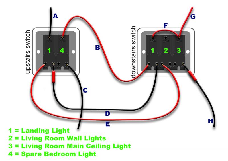

As a PS if the down stairs lights affect landing then likely link taken from wrong side of switch 3
I disagree.
All it would need to make the diagram 'look' alright would be to swap the two red wires at the landing switch.
However, without testing, no one can be certain.
This is what I am guessing should be there. But as you say we can only guess we have no readings to go on.
Other than considering there is a line wire tucked away somewhere nearly the same diagram as I posted last night before he realised his mistakes.
I agree with EFLI that swapping the reds would make it look, on paper, OK.
But, as the amended diagram stands, the spare room light would not work unless the downstairs landing light switch is in a certain position.
Although we can guess that G is line feed and H is to light it is only a guess.
The same applies A, J, and C three wires and really only guessing where they go.
There are some things we do know. Neither bedroom or Landing will work correct as shown.
With two wires between switches one must go into Com and will be on it's own and the other will go with another wire in the same hole with the switch connected to light.
