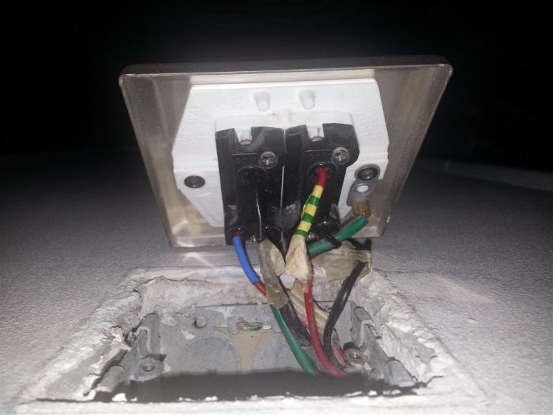

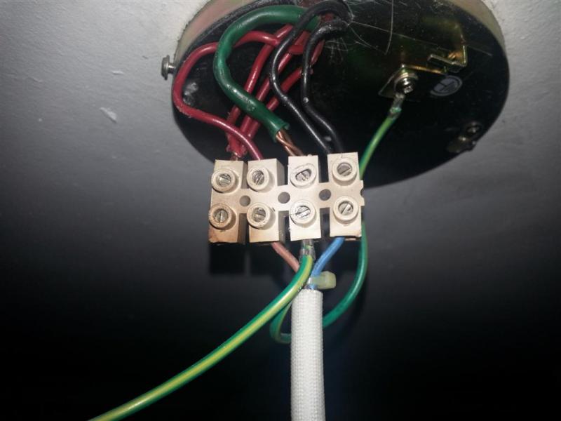

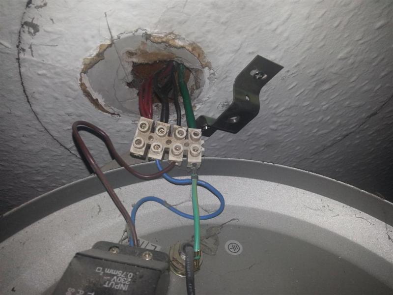

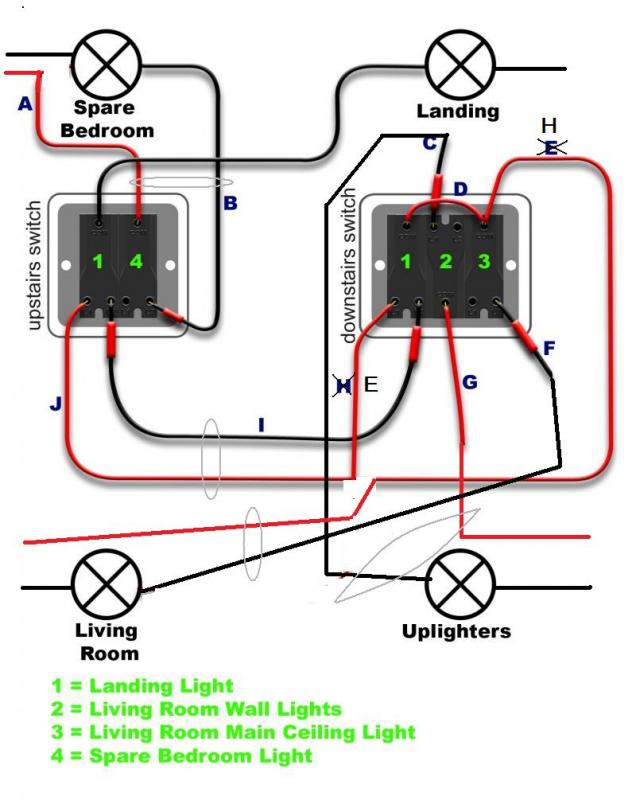

I spent all day yesterday trying to figure out what wires go where. I realised that in order for my test with the multimeter to check continuity to work I would need to ensure that the the wire I was checking was completely disconnected from the rest of the circuit not just at the switch. This is why I was getting false readings before because the wire was still connected at the light. I took photos and marked where all the wire currently go. Although they are not right I don't want to start changing anything until I have understood what is wrong.
I have uploaded photos for each of the main fittings and the switches. and my revised diagram of my findings. The diagram is now making more sense but I suspect it is still not right.
A and B now make sense as the switch for the spare room.
I ran out of time to check C & G which is why I have not shown them as connected (as I am learning assumption is the mother of all cock ups) but I am pretty sure they go to the Up-lighters as they work fine, and this would make sense.
F has me totally confused, it made continuity with a red wire in the upstairs landing light?? but with nothing else even when there were no visible wires connected. obviously it would complete a strange circuit if it went back to the landing light and would explain the switching behaviour if the live feed was coming from the living room light. What is F connected to in order to make continuity with a red wire?? Also why on earth would you wire it up like this?

Firstly, switch 2 is correct. Do not change
Wire A will come from the supply at the spare bed light, not the lamp.
Can you tell us which wires are in the same cable?
Your switch/wire diagram makes no sense at all. As stated before, you are leading yourself up and down many cul de sacs and getting nowhere.
I'm not sure how you are determining where these wires go to, but whatever method is wasting your time.
If your diagram is true then none of the lights would work.
Your diagram cannot work at all. eg
Spare bedroom. There is a lamp across the switch. But no live feed and no neutral anywhere.
Landing light on switch 1? are you SURE? There cannot also be the living room light connected at the other end.
Where does F go to?
Where are uplighters connected?
Wire J should be a live feed to the downstairs switch, but you seem to think it is a 2-way strapper to switch 1 - not possible.

I am now pretty sure that the diagram is correct for the wires going to and from the switches 2 & 4 (the ones for the spare bedroom light and the Up-lighters). To me at least these make sense and work as they should. I have not shown any of the other wires on the spare bedroom light because it all works and I don't think has anything to do with the landing light. If it wasn't in a double gang switch and there was room for it in the spare bedroom (so it didn't have to go on the landing) I wouldn't even have mentioned it. It is on the upstairs ring. The live feed and the neutral come from the bathroom.

What about G? It sounds like you've got the living room switchwire and the live feed to the commons muxed ip.
Still feel the key to all of this is to start by making sure the strappers are correct. Once you know they are correctly connected, you can build on that.
When you have the strappers sorted, you need to ID the live feed at the GF switch and the landing switchwire at the FF switch.
That will sort your landing light out. Then the rest will be a little easier to fathom.
