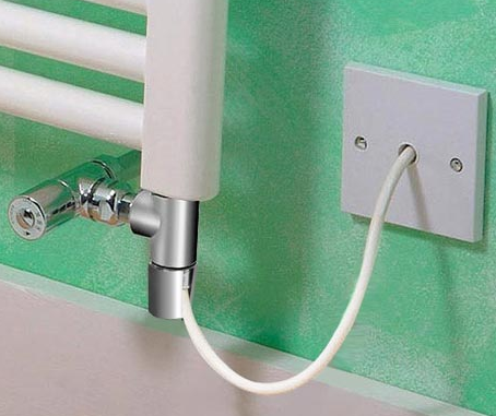

That towel warmer could be on its own circuit heated by electric only,great for summer use :p
I agree! It would be useful at the moment. I should have installed a 'dual fuel' version. :(
