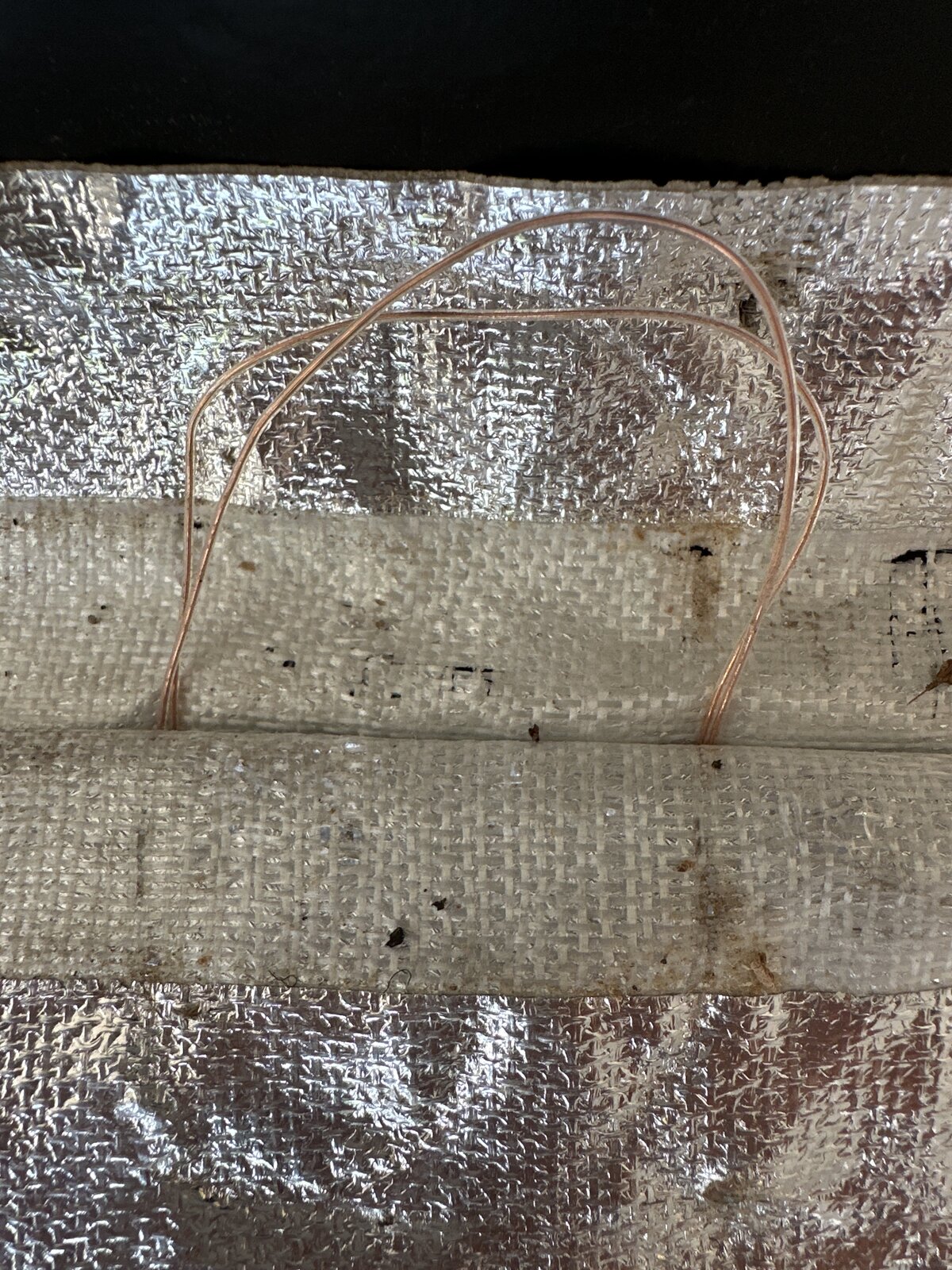

So Iv got a house that had already installed underfloor heating that was working fine. Had some things done in the house and when cutting an only laminate piece out that was stuck the flooring guy has damaged the UFH. The damage was clear to see. So twisted the wires back together with a hope of putting the system on checking its working fine problem is the second the UFH turns on it immediately trips the electric
Tried soldering the wires together and wrapping in electrical tape but see getting same result, abit lost on why its not working, im no electrician so I know the obvious answer is get one in, but getting one in on short notice is no easy feat
I have attached a picture of the type of wire thats been cut
Thanks in advance for any ideas

Is that bare wire we're looking at? Where's the insulation?
Thats the wire thats contained within the foil sheets, iv peeled them back to get to the damaged wire. The damaged wire is at the top of the loop, you can’t really tell from the picture but the wire is costed in like a clear plastic

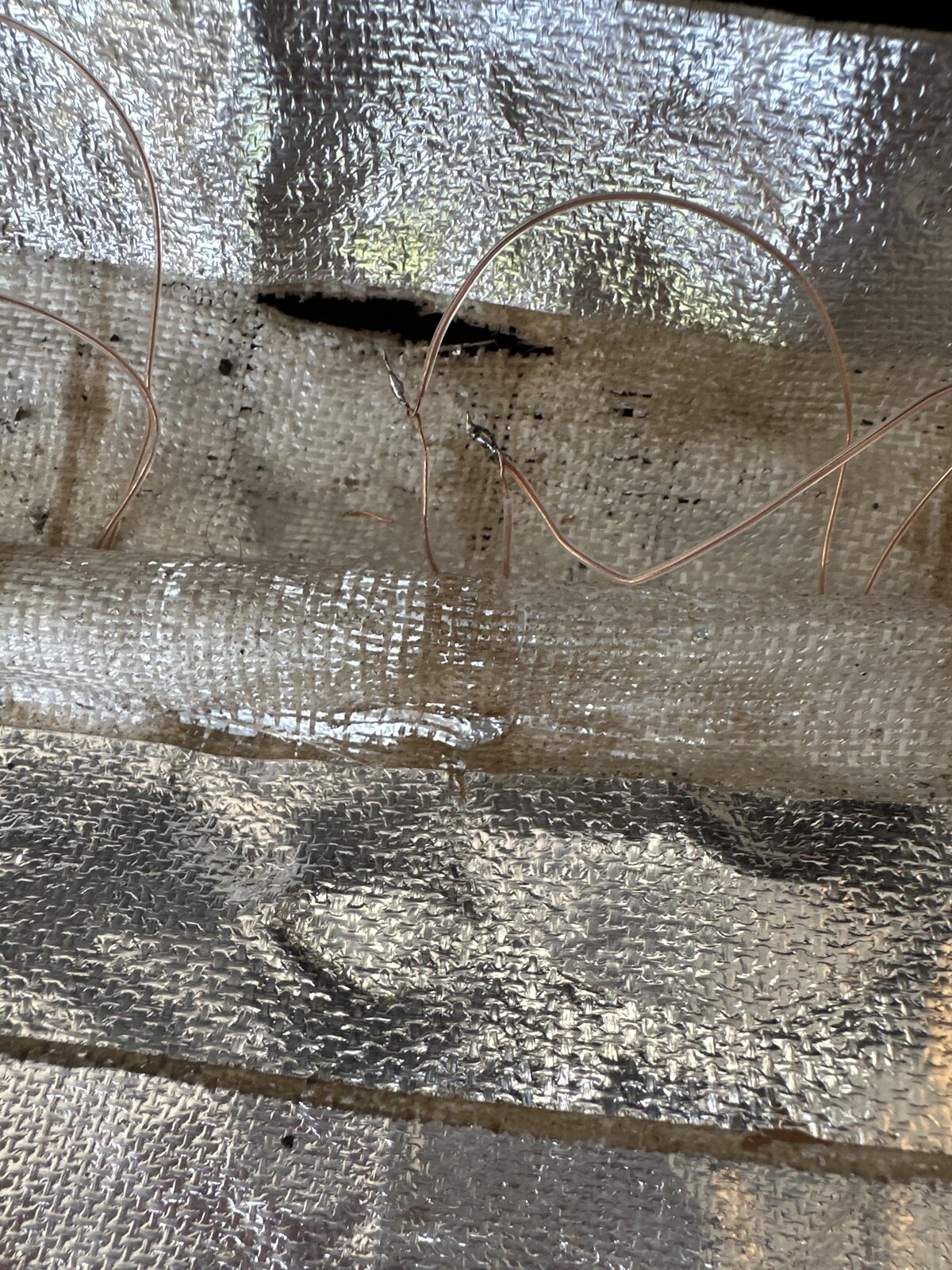

Lets have a look at your mend. Specifically, how many wires did matey cut and are you sure there is no other damage
my mend looks shocking (excuse the pun) Theres two wires per loop and he’s cut through x4 ( top of two loops).
Iv only done the bodge job on it now to test the circuits working. I will get a repair kit and do a ‘proper’ job on it if ai manage to get it on without the fuse tripping out
Im fairly certain theres no damage elsewhere, iv pulled some laminate up but it came straight up, no visible damage to any other foil and no tools or cutting was done anywhere else apart from here at the bottom step

I am sure one can with epoxy lined shrink sleeve repair the non heated bits of UFH, but the element if extra insulation is added may over heat, so in the main if damaged only option is to renew it.
I had same problem with mothers wet room, no option lift tiles and fit new mat.
But not all electric UFH is the same, some use resistive cable, the cheap type, and some use a resistive chemical which increases resistance when heated so self regulates, unfortunately when I was laying it, that type needed a earthed mat fitting above it, so not as easy to fit, so used the cheap stuff.
I can see the silver cover, which may be the earthed mat, but there are so many types, some is in sections and there are cutting points, and as shown there are repair kits for some types, but really this is not a DIY job.

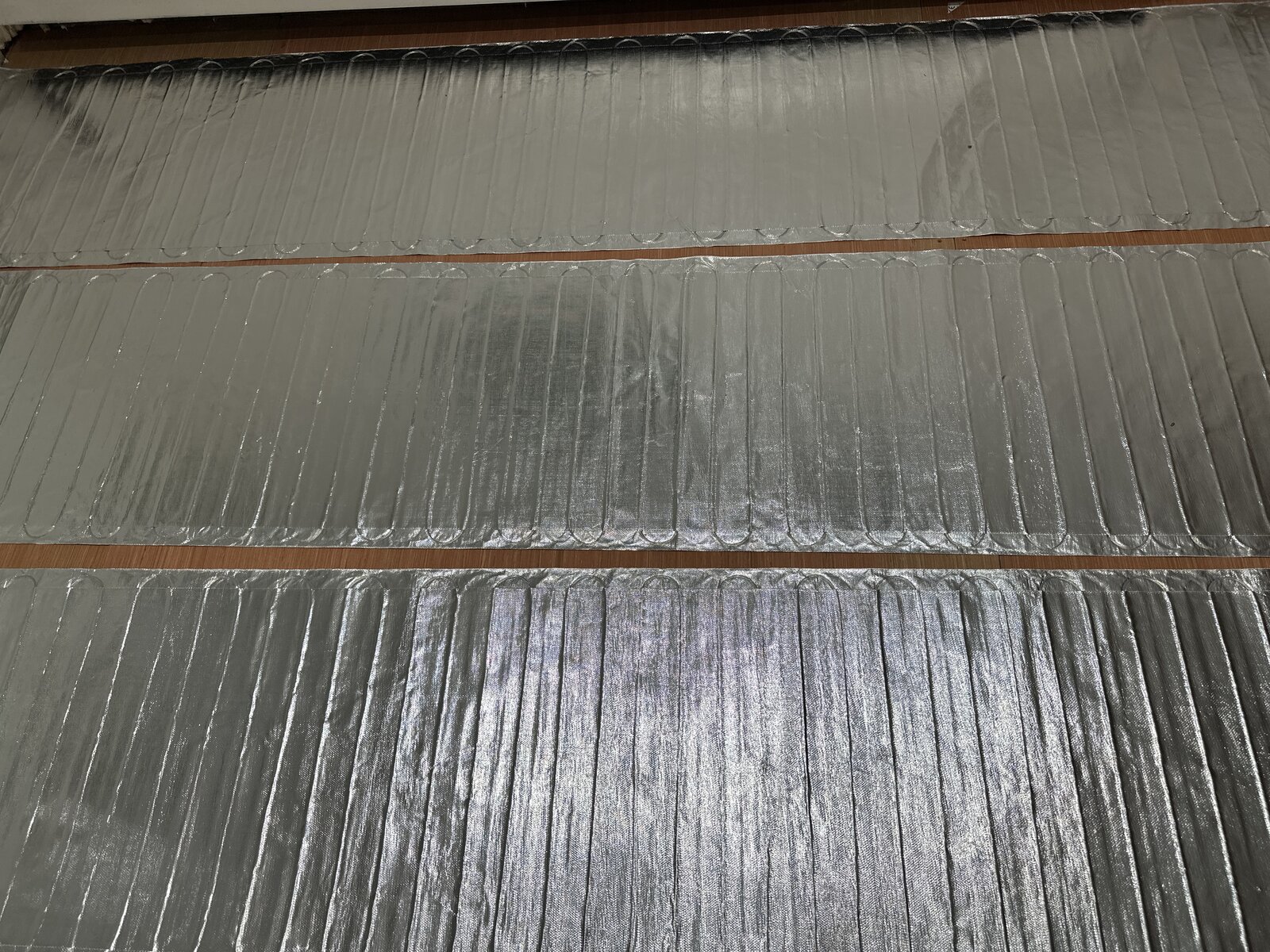

Yeah, so had electrician out today to look at it, looks like I need to replace the lot, luckily only cost £200 for materials. Had a week and half honestly
Thanks to everyone for the help and advice :)
So, riddle me this. I have installed completely new undamaged mats as pictured. Tested the wires, reads the rights Ohms as per manufacturer and no shorts.
So when I hook it up to the power, its instantly trips still???
If I leave the wires unattached from the mains, separated and turn the power on the thermostat comes on and doesn’t trip so can’t be anything but the mat tripped it.
I have even attached another mat which is unfitted, its still on the roll, instant trip
Feel like im losing my mind

Upon further investigation I have found that any load trips the RCD, remembered that there is a set of plugs in the attic and one plug socket upstairs that wern’t working. So unhooked all the underfloor heating, and plugged in a led light (newly installed on steps, works fine in other sockect) and as soon as I switched it on via the socket that wasnt working it tripped the RCDs.
Thinking now it may be a faulty B32, as seems to overload under any stress, it must have some sort of capaicity as without anything hooked to it, or the said socket been on it managed to power the thermostat, but seems any further load than this trips it.
Got an electrician to come out to check, just thought id give an update :)
I think you have a neutral - earth fault.
The neutral with no load is same voltage as earth, so if there is a low resistance between the two, nothing will trip, as no imbalance. But as the load increases the voltage between earth and neutral also increases, not by much, but enough to cause current to flow.
We use this VC60B.jpg meter to test, and it puts 500 volt between the wires to be tested, it can destroy electronics, so care is required in its use, and the cheapest will cost around £35, it is always used when laying electric under floor heating, so the person laying it should have one.
