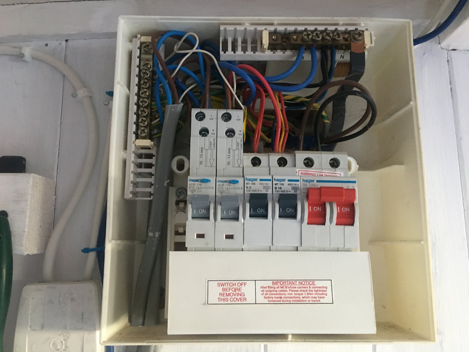

We have a utility room which has a additional consumer unit which connects back to the main house consumer unit.
Doing the ironing the electric tripped in the utility room. The main house electrics working fine still. Looked in consumer unit and RCD tripped. Reset RCD but nothing happened. Reset main RCD in this consumer unit then the tripped RCD but still nothing.

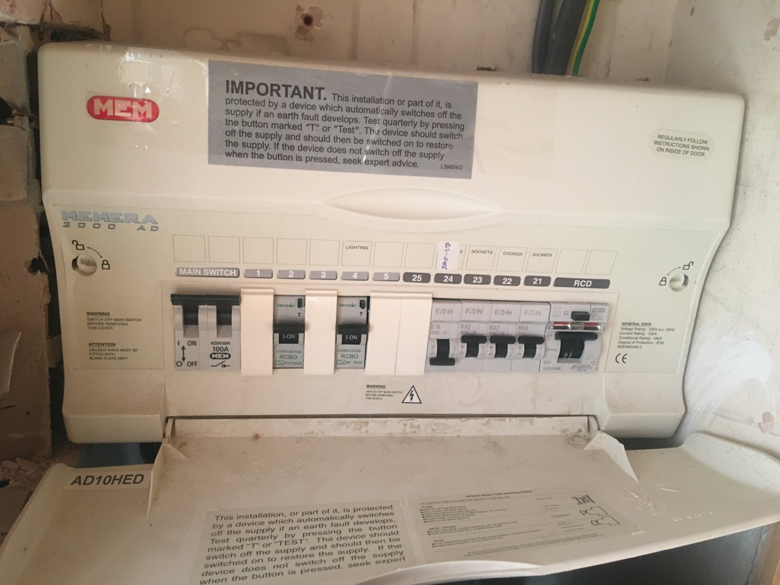

I looked in main house consumer unit and all looks fine.
I reset this RCD but no change so I then did the main RCD also no change.
So at present house all fine but utility room no electric.
Photos supplied of the following.
Utility room C/Unit
Main house C/Unit

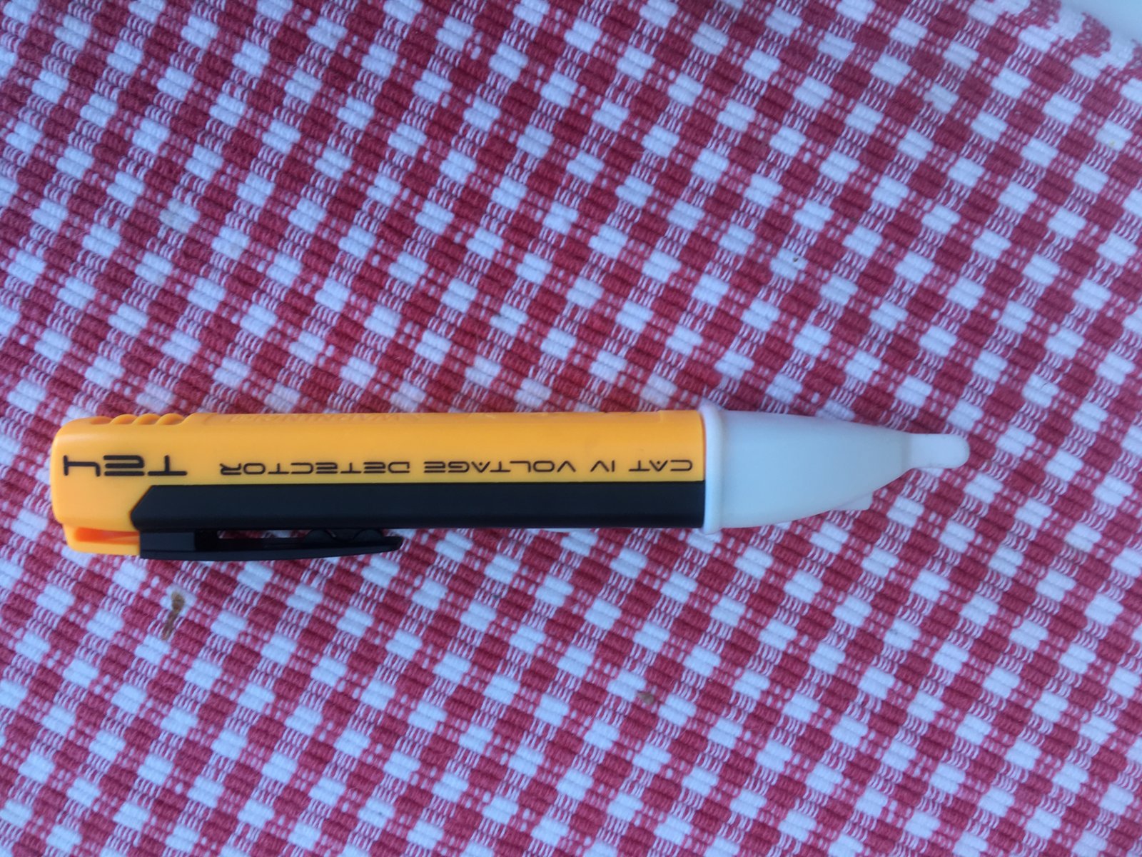

Electric tester

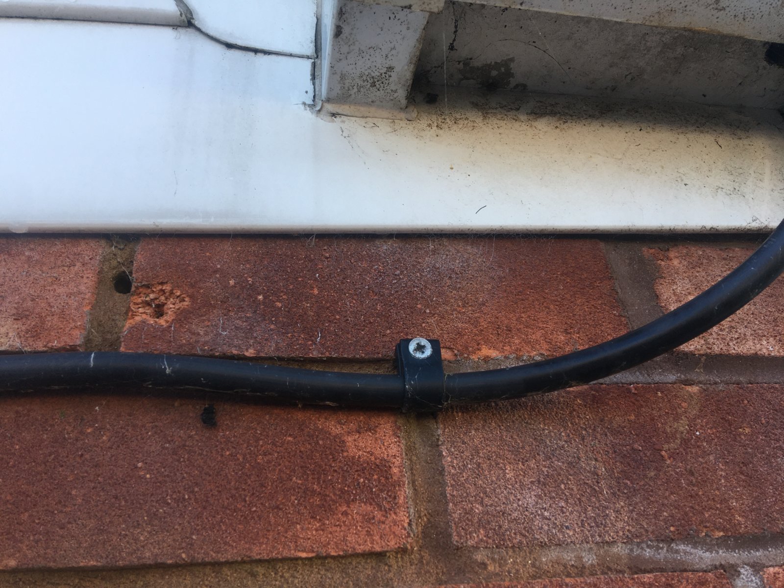

Cable from house C/Unit to utility room C/Unit.
As cable is armoured not sure if this tester will work because no beep beep on tester.
Touching any wire in utility room C/Unit also no beep.
Just one initial thought ... with some protective devices (MCBs, RCDs, RCBOs), when they have tripped one has to push the lever firmly right down (into the 'off position) before they can be reset (by pushing the lever back up.
Kind Regards, John
What is that MCB marked 'boiler' actually for? It's switched off. Try switching it on.
If it isn't that 'boiler' item, then there may be some other fuse or protective device somewhere else. You will need to establish where the utility room consumer unit supply is connected.
Thanks.
Totally forgot to switch the boiler in.
Boiler then start and I could here the fan start to spin. At the same time I could then here the phone go beep beep.
All sorted now thanks.
Without taking the cover off the main C/Unit will I expect to see the armoured cable outer sheath be cut away & connected somehow with the boiler ?
Also does this mean if the boiler is switched off the electric should be off in the utility room because when we have it serviced etc the electric is still ok.
I assume then he doesn’t switch the boiler off at the main C/Unit.
That lot needs sorting out. Is the circuit labelled boiler actually the feed for the ultility room. if so, the 16A MCB should be larger than 16A or there will be no discrimination- the utility CU has 16A MCBs in it.
Does the “boiler “ MCB feed just the armoured cable? photo of the main cu with no cover might help. But I suggest u get someone on site to sort it and label it all properly. And give u dome guidance.
