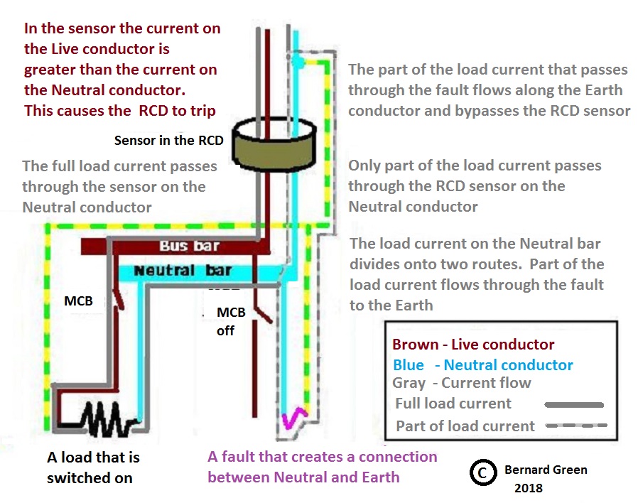

A Neutral to Earth fault on a circuit can still cause an RCD to trip even if the MCB for that circuit is switched OFF. The trip occurs when there is a load on another circuit. Switching the MCB to OFF does not isolate the circuit as the Neutral is still connected to the Neutral bar in the Consumer Unit.
